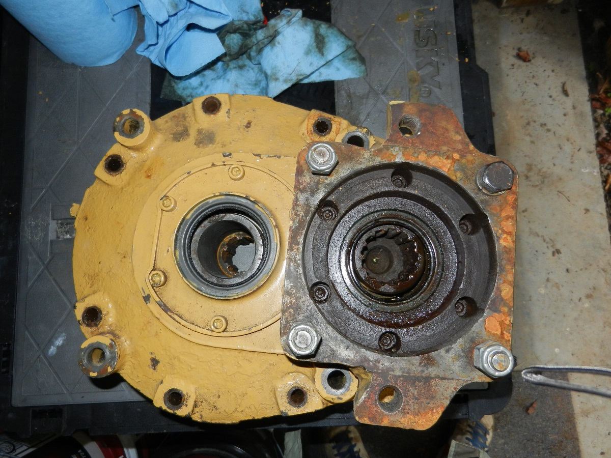

Don't know if it would help.....nor do I know (obviously) if you already have one.
I have a 15' Terrain King (now owned by Alamo) flexwing hydraulic mower. It uses a speed increaser and my pump attaches to the speed increaser.
So my question is, do you also have a speed increaser on yours? If so, then ignore the rest. Keep in mind that I'm not too technical on this stuff so this is my lay understanding. My speed increaser is a 4x increaser. So it attaches to the PTO which spins at 540. It takes the 540 and multiplies it up to 2,160. My pump attaches to the increaser and now my pump has an input of 2,160 rpm's.
Does yours have/need anything like this? When I spoke to Alamo after I bought this (trying to buy some seals) the guy I talked to said he was surprised that I had the increaser along with the mower. Went on to say that people usually sell them separate although I can't understand why as without the increaser, I'd have no way to mount the pump. None the less, that's what he said.

Following Richard's advice, that's all we run on this side of the pond, a speed increaser with a standard gear pump mounted to it. They're available for Group 2 and 3 pumps and you can pretty much mount whatever size of pump needed to the PTO speed increaser.

I can't speak to the above....and as an added bonus for myself, I've got both PTO's.
The increaser I have can be mounted to either shaft. All you need to do (as I recall) is replace the receiver "gear" which is of a certain size to correspond to the 540 input shaft AND it has a different diameter.
So, swap out for 1,000 "receiver gear" and the receiver splines are different AND the diameter is different making it 1,000 compatible. However, you'd need the 1,000 shaft on your tractor.
Given my general lack of knowledge of this stuff BUT, taking in mind that I've learned a little.... I'd presume you are able to make it work with a 540 x "??" speed increaser mated with appropriate pump.
