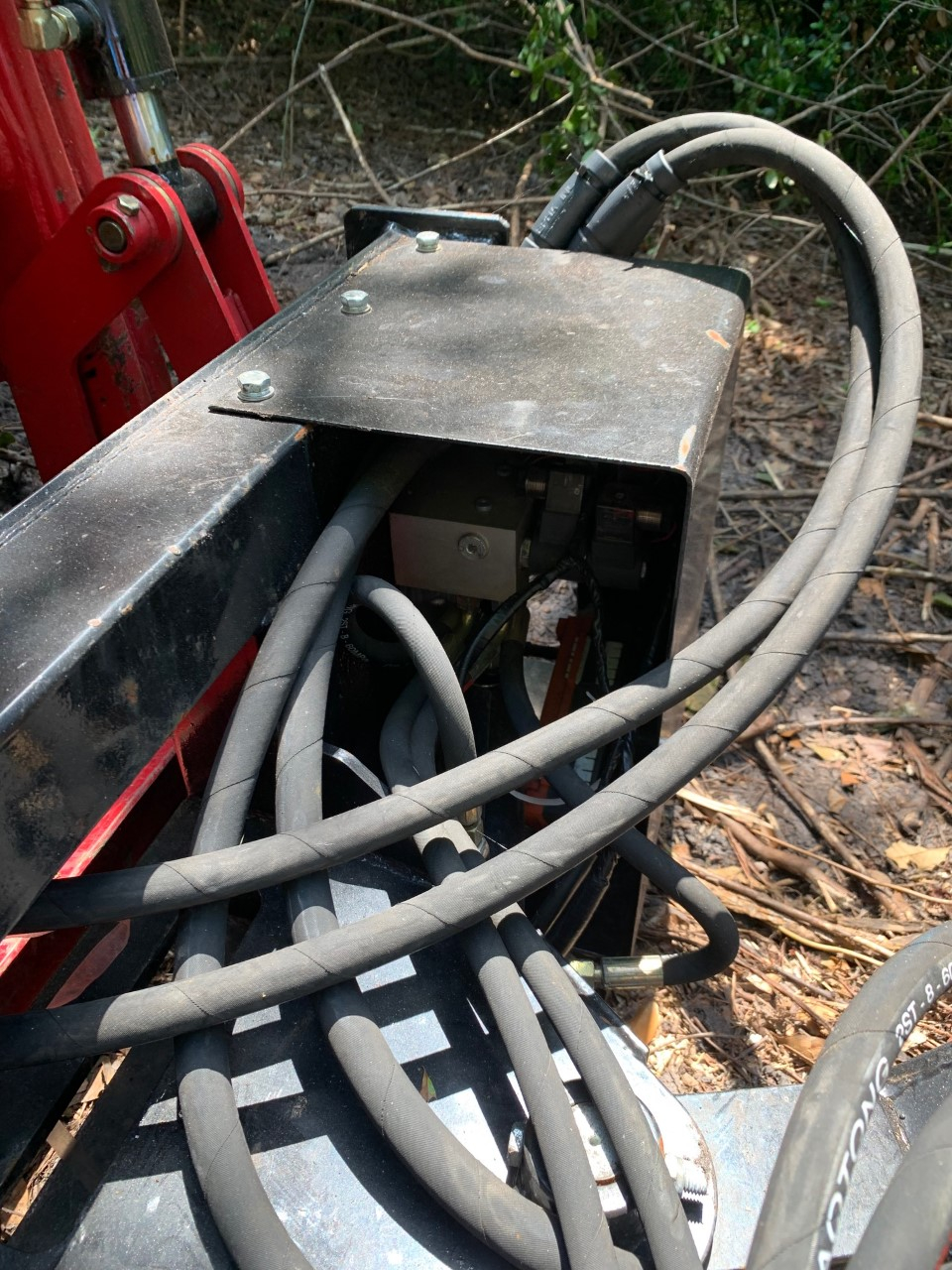

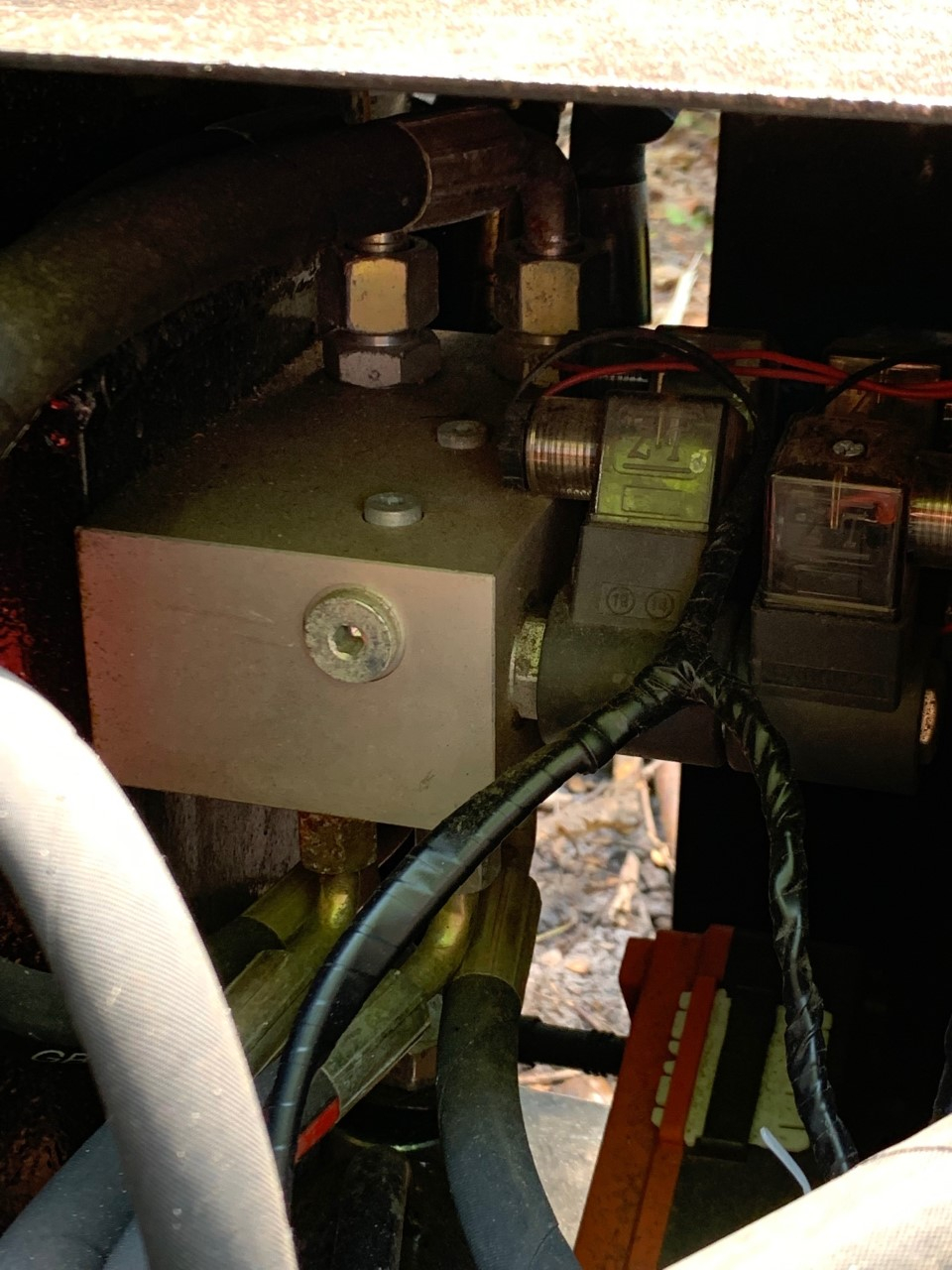

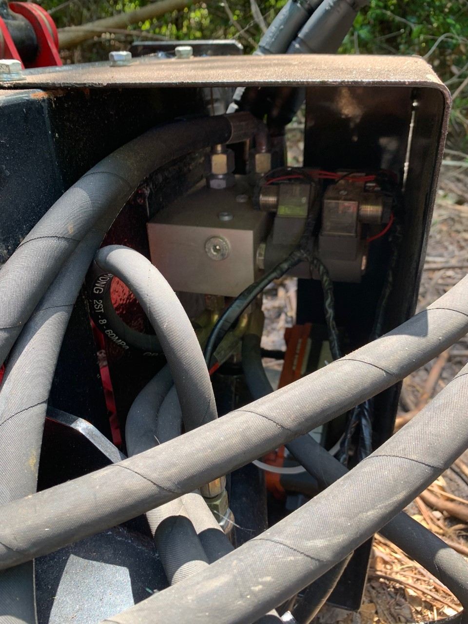

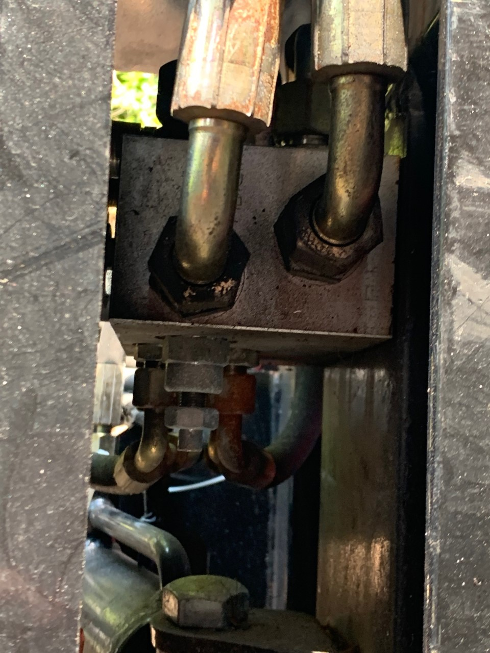

I agree with ptsg and oldnslo. That does appear to be a relief that has backed off. My suggestion is to purchase a good pressure gage and contact the manufacturer for proper adjustment of that relief.
