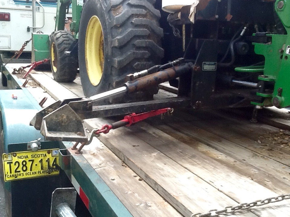

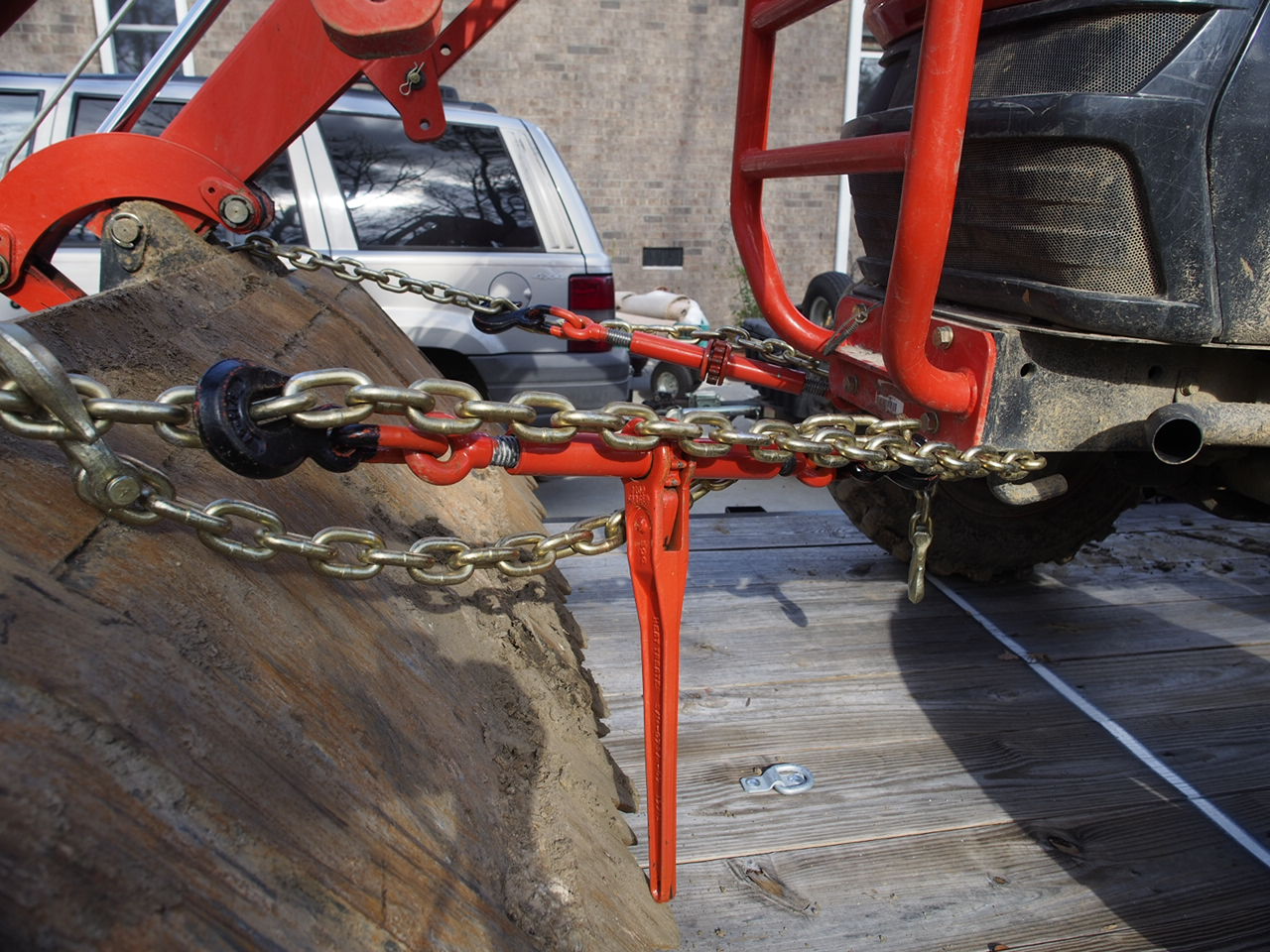

What do you mean? How the chain hooks to the trailer? How to connect the ratchet binder itself? You run the ends of the binder out equally on both sides, pull all the slack out of your chain, hook each end of the binder on, and crank it down till the chain will sing when you smack it.
   / Binders and chains
OK so I run the hooks out and attach between the links and tighten up huh?

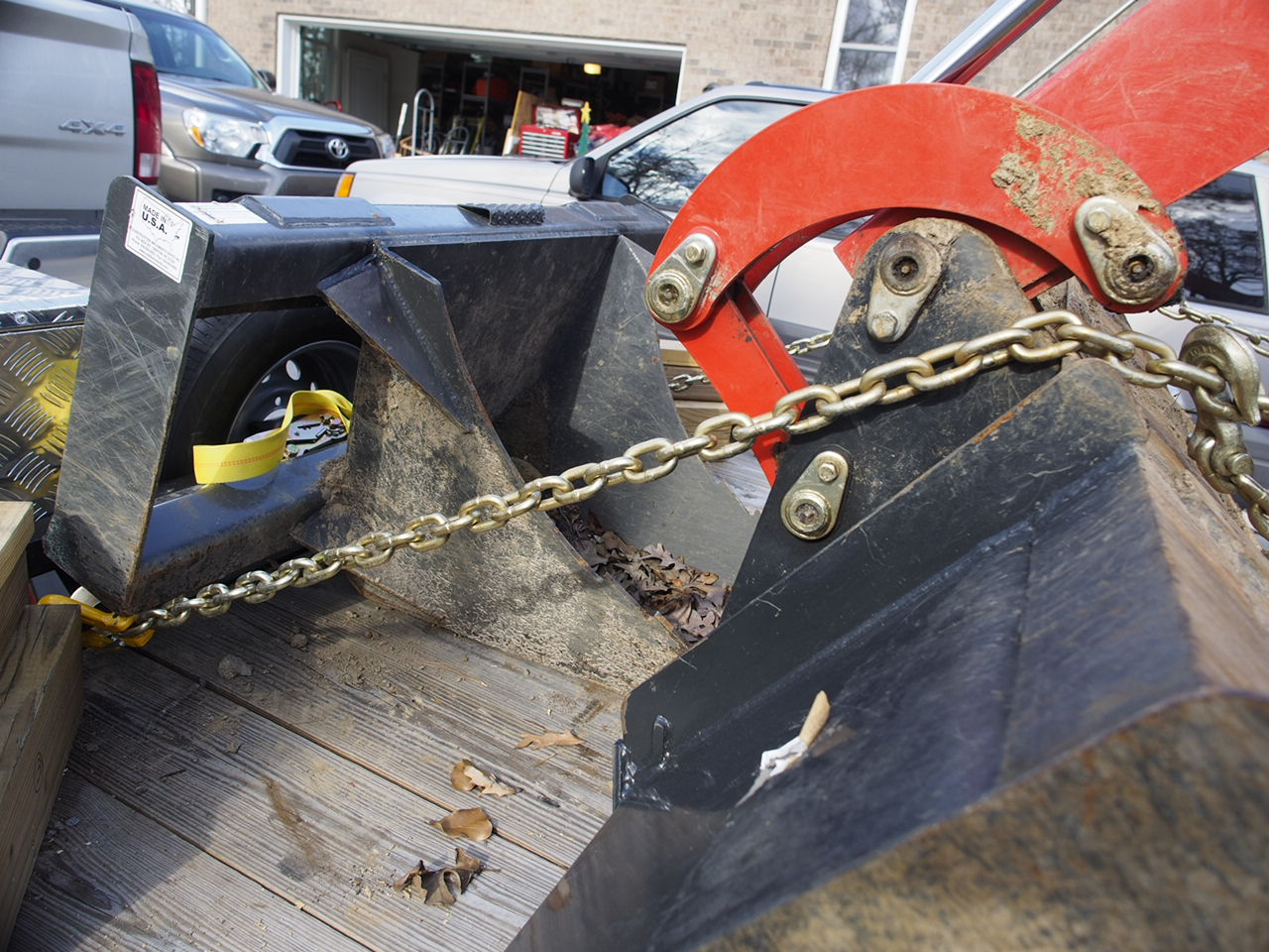

Well George it has been years since I used a binder don't use them every day. The trailer is a 16 foot 10 ton and the 1/4 is to secure the bucket.

RedNeckRacing's procedure is correct. I use 4 chains (2 front,2 back) plus implements secured. Don't have any pics but there are a lot of them posted on this site. Make sure you have enough tongue weight so the trailer isn't rear end heavy.
