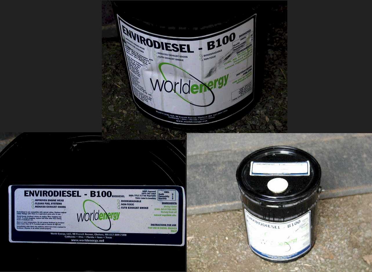

I ordered 5 gallons from the place in Mass. It arrived in about 1 week. Some observations;
1. The 5 gallon can isn't much good for anything else after it's empty of Biodiesel. /w3tcompact/icons/sad.gif I thought if all else fails, I'd at least have a nice 5 gallon can.
2. You can not pour right from the biodiesel can into your fuel tank, unless you want to make a big mess. I had a half full container of regular diesel, so, using a funnel, I poured half the biodiesel into it, poured the other half into a half empty tank on the tractor, again using a funnel.
3. The biodiesel is light yellow in color versus the clear of regular diesel.
4. The warnings on the can indicate it should not be stored in temps under 40 degrees F. Bummer. Others have mentioned that some of the anti-gelling additives used with regular diesel fuel don't work with biodiesel. I assume if you find an additive that works, you could use and store biodiesel over winter.
