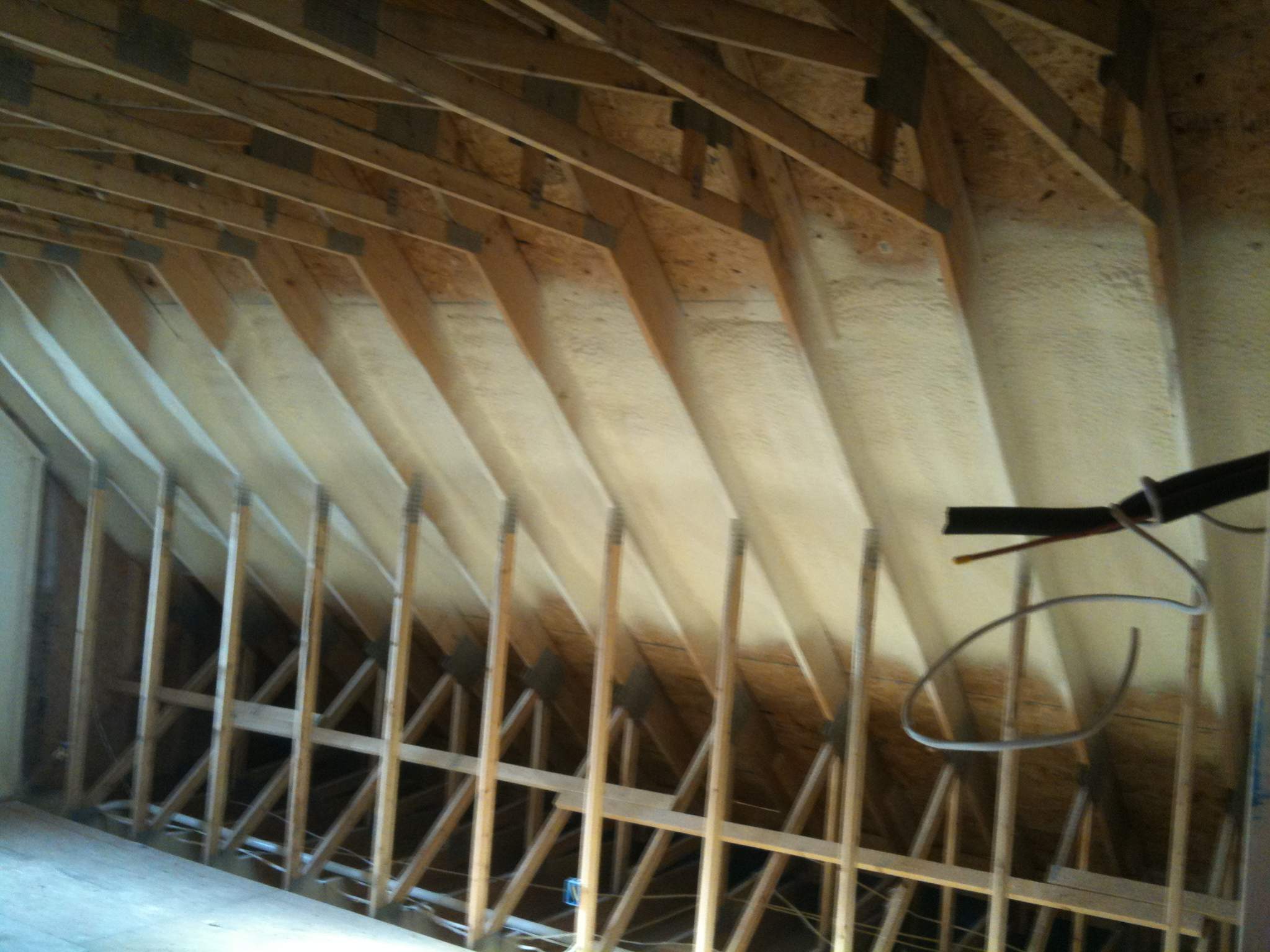

Basement 2x8 frame for walk out area with spray foam
Bonus room spray foam 3" closed cell with cellulose fill

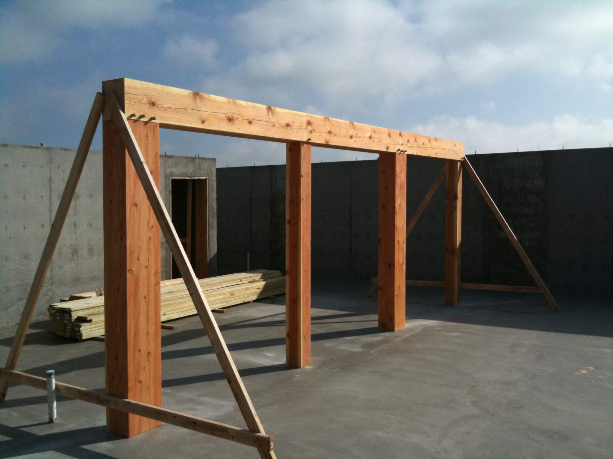

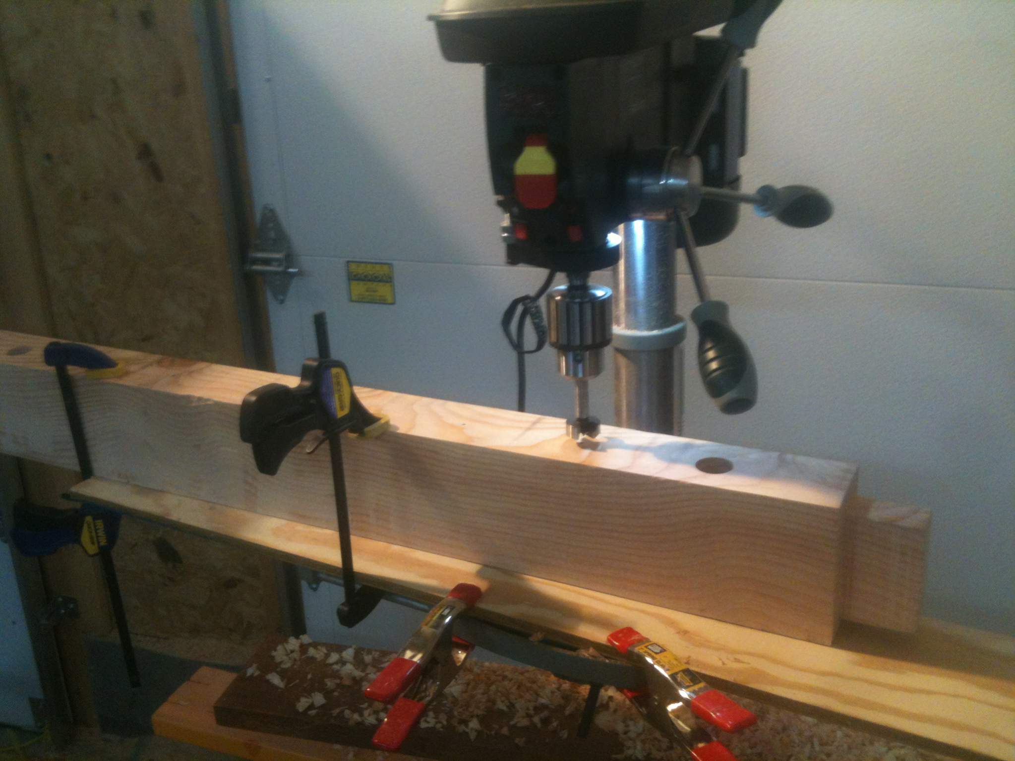

Here are joint cutting pics from the Timber framer along with basement pics
IMG_3537.jpgTimberFrame House 004.jpgTimberFrame House 001.jpgTimberFrame House 013.jpgTimberFrame House 009.jpgIMG_3536.jpgIMG_3528.jpgIMG_3502.jpgTimberFrame House 026.jpgTimberFrame House 029.jpg

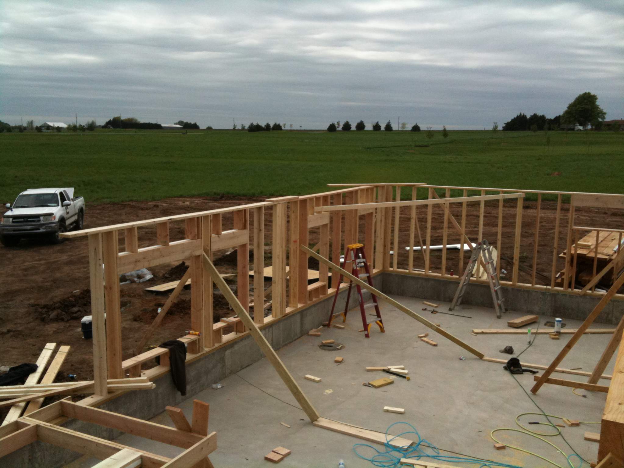

/ BitChin home build

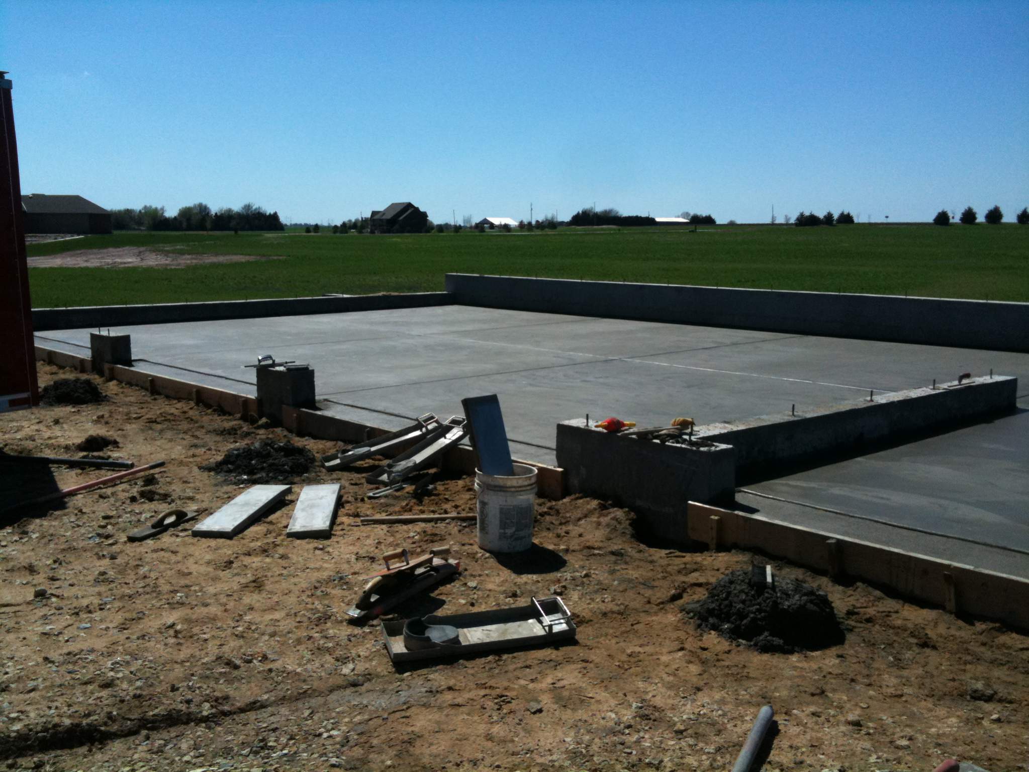

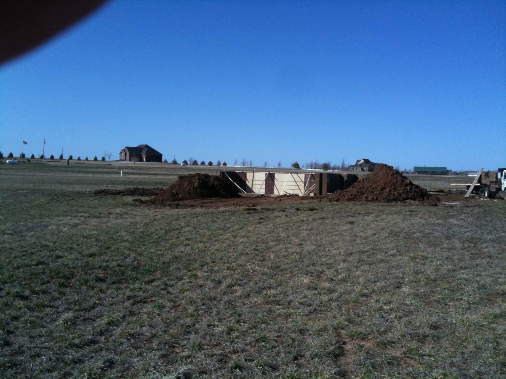

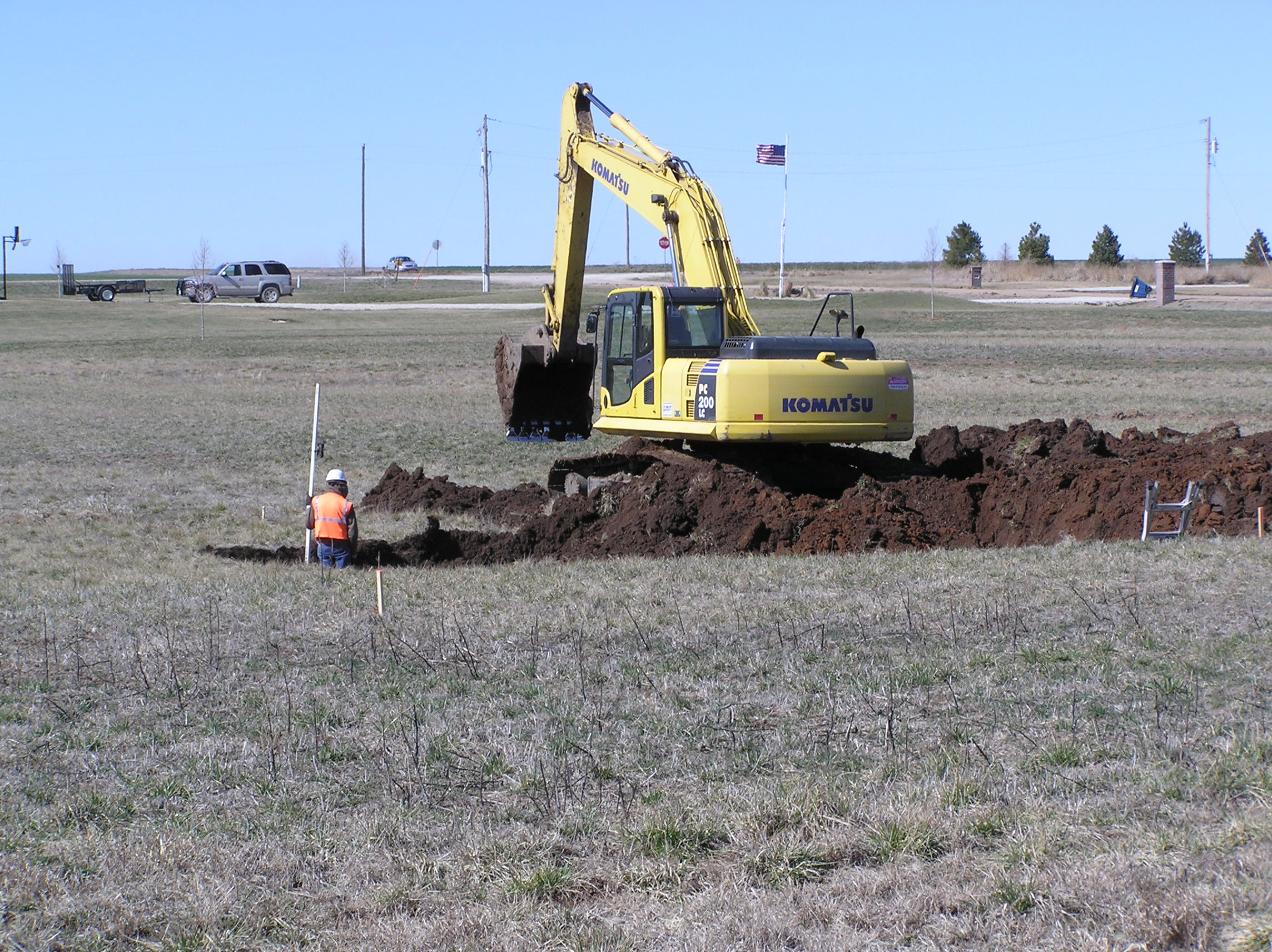

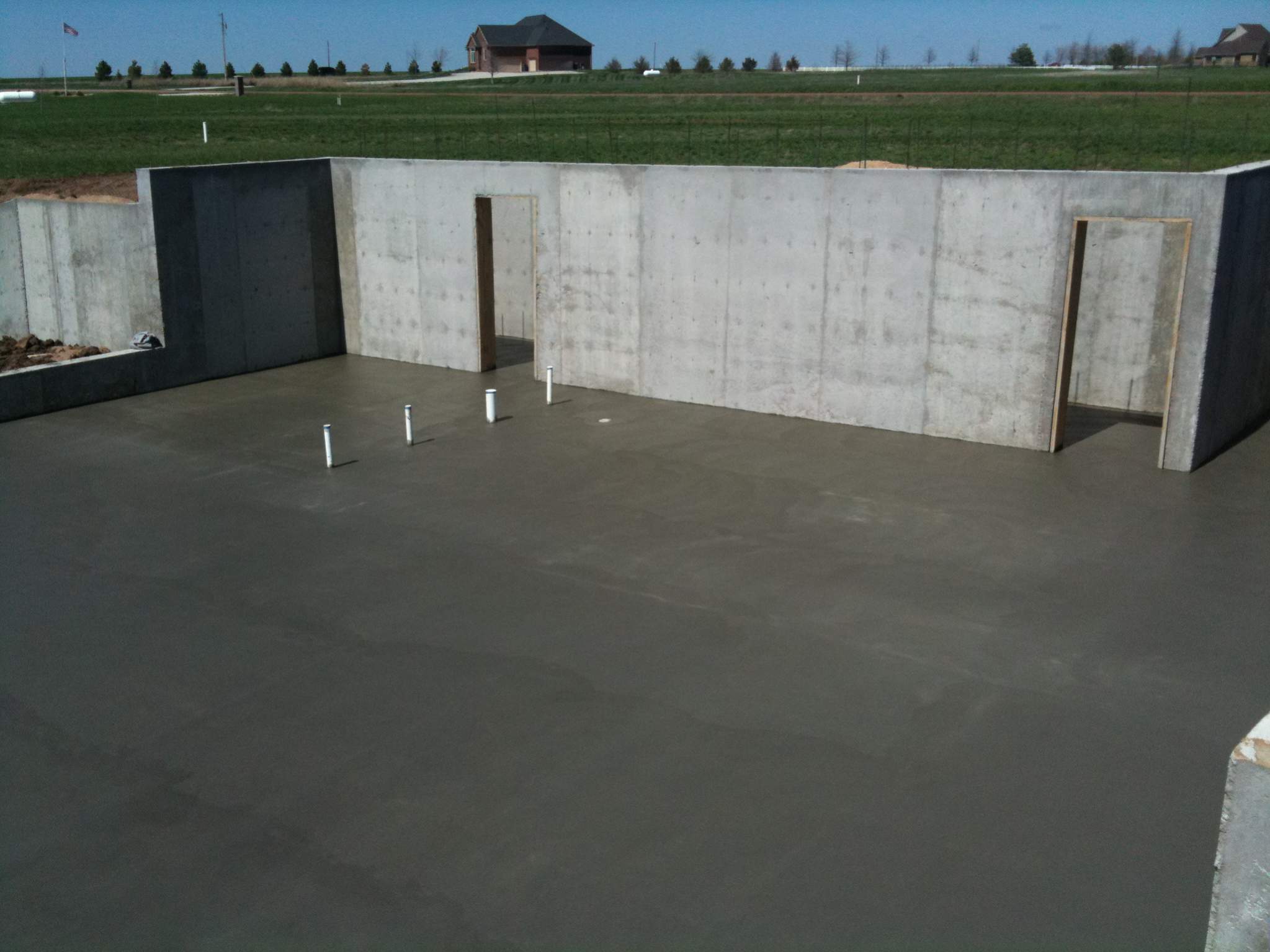

P1010007.JPGP1010002.JPGP1010005.JPGMore foundation and early site work pics (Feb/Mar 2012)

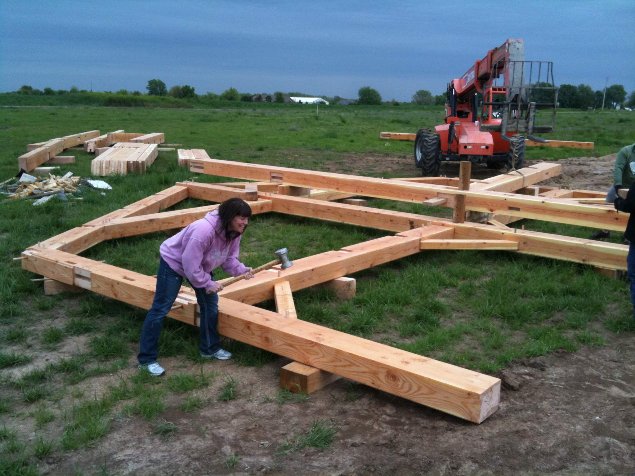

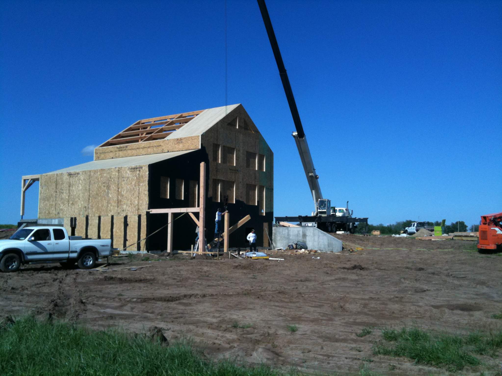

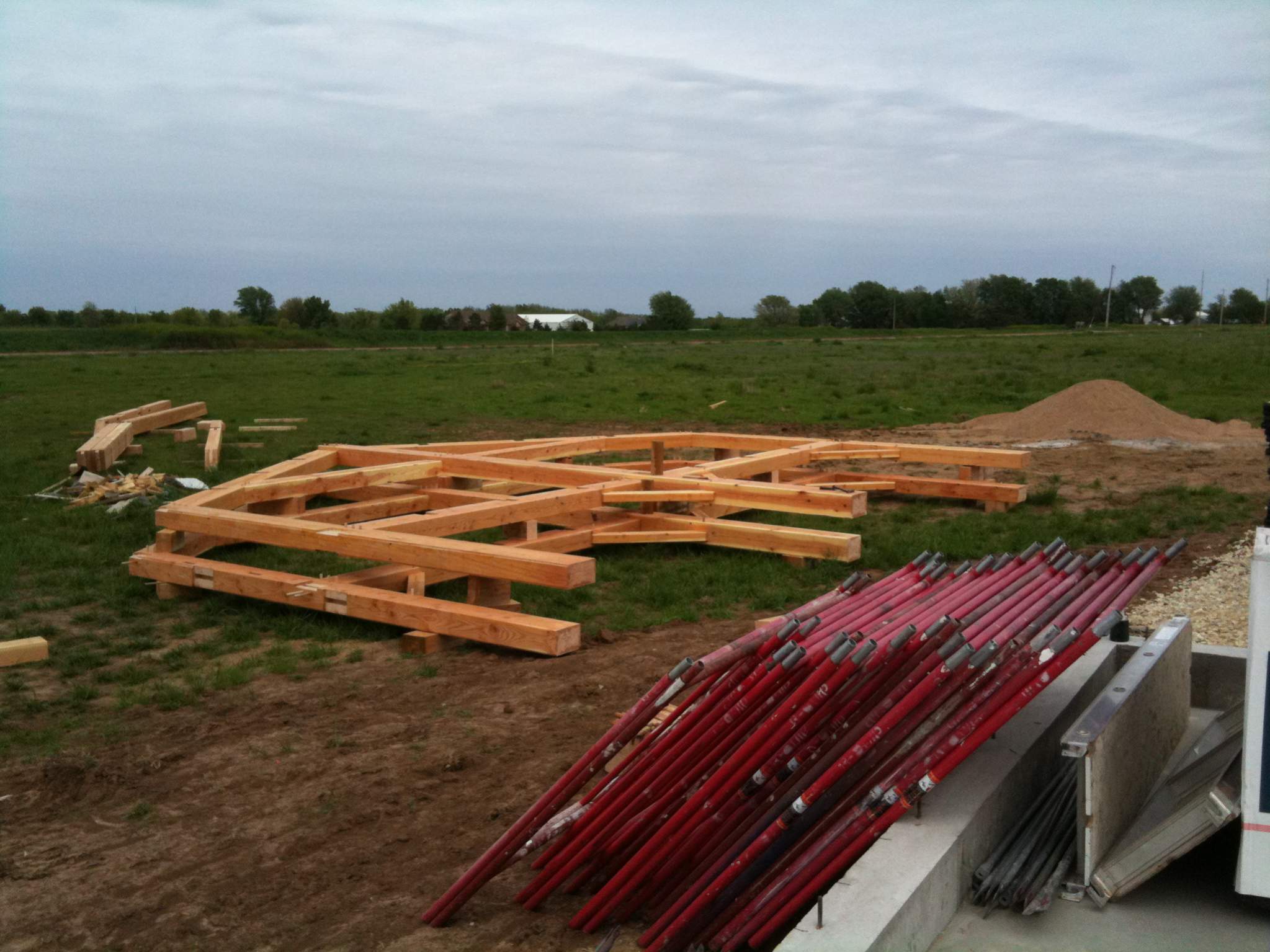

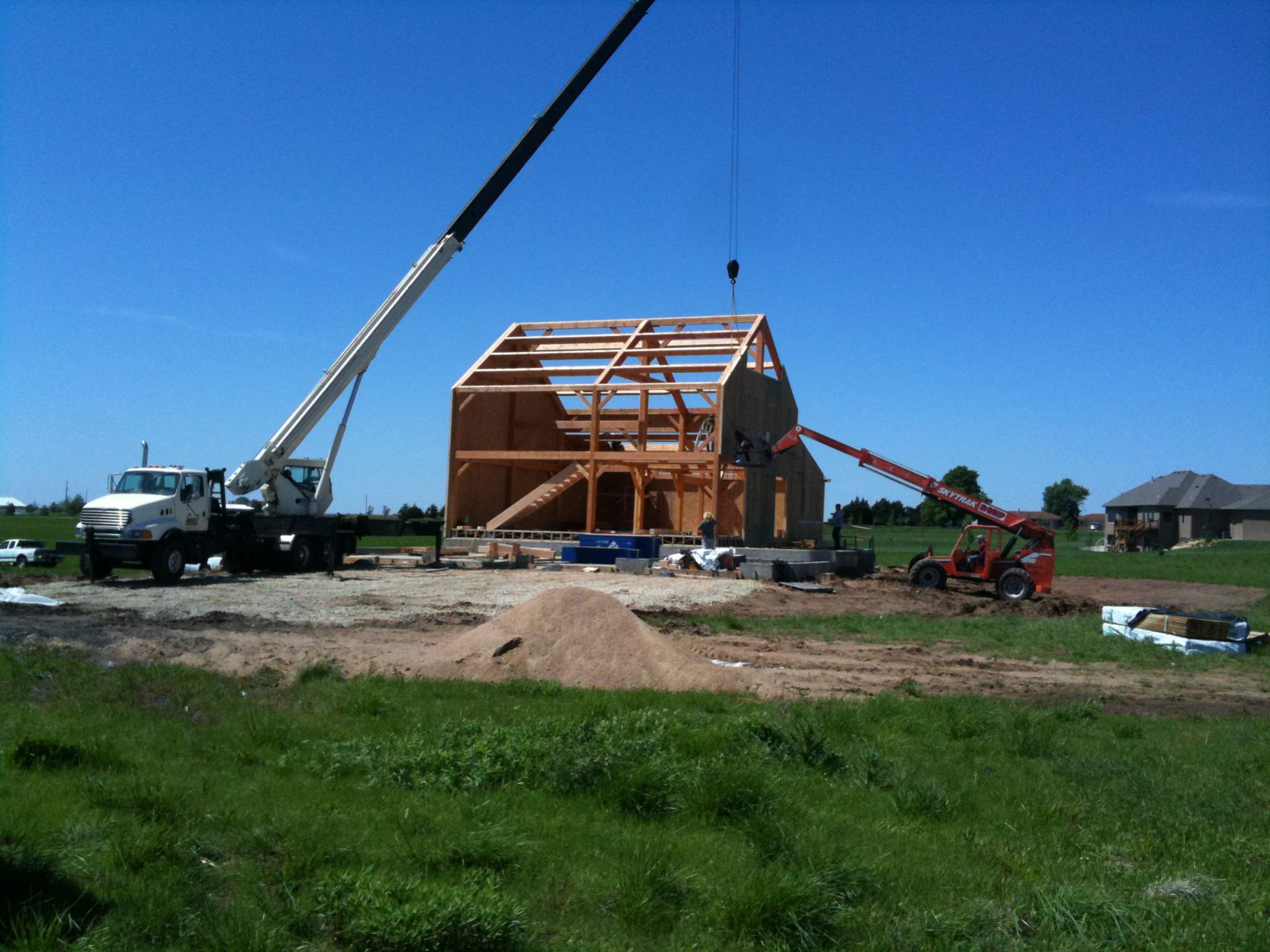

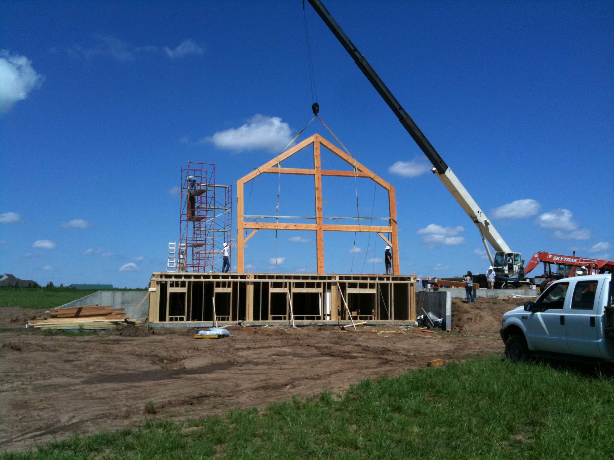

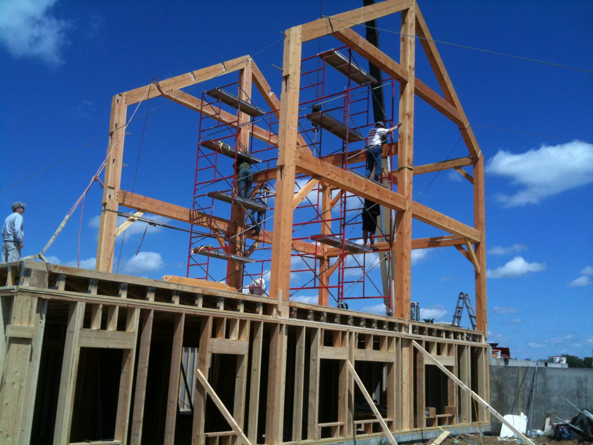

Frame raising
(wife "pegging" frame)
Progress pics 044.jpgProgress pics 046.jpgProgress pics 055.jpgProgress pics 057.jpgProgress pics 068.jpgProgress pics 072.jpgProgress pics 077.jpg

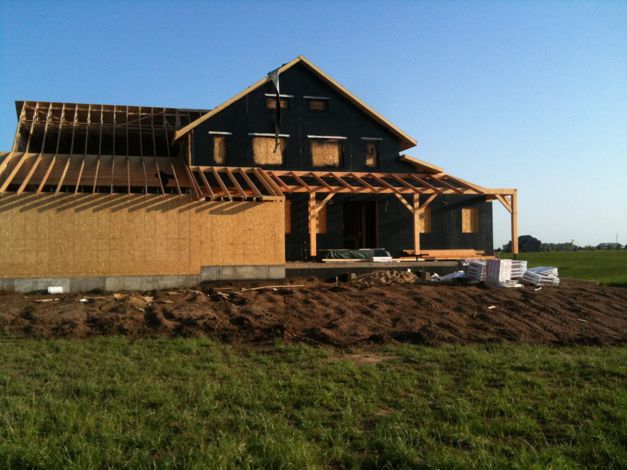

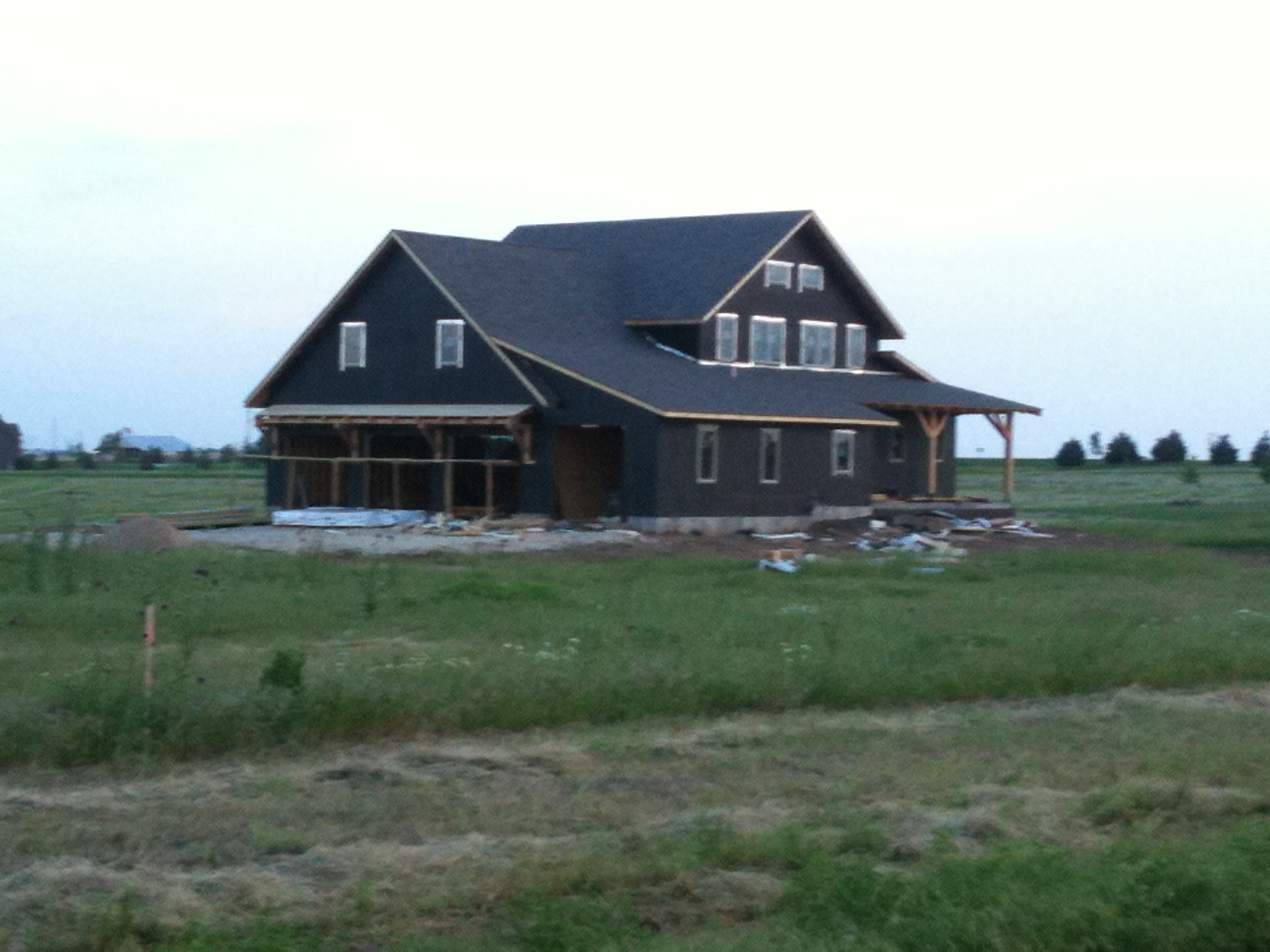

Exterior weather barrier applied and house enclosed

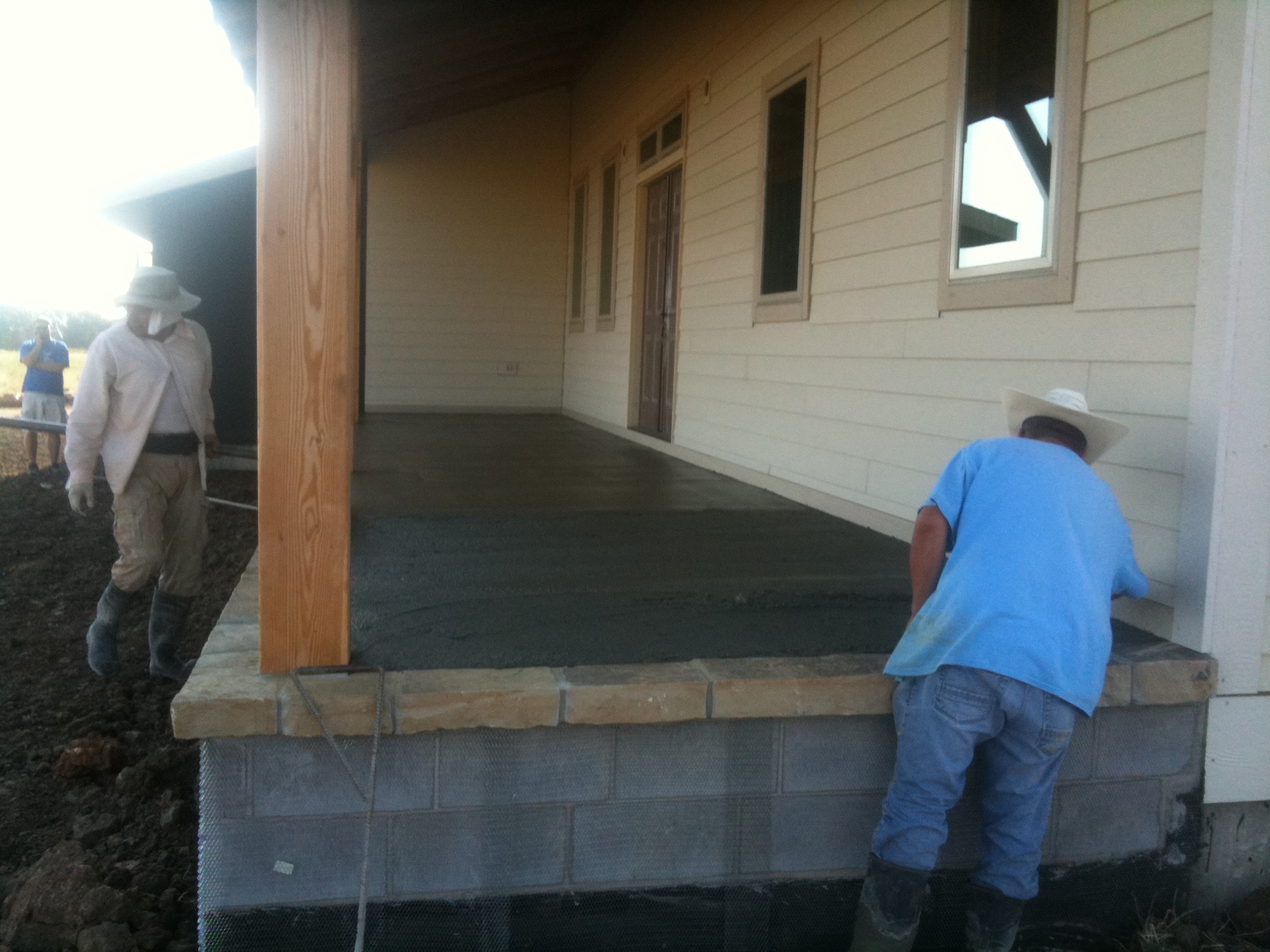

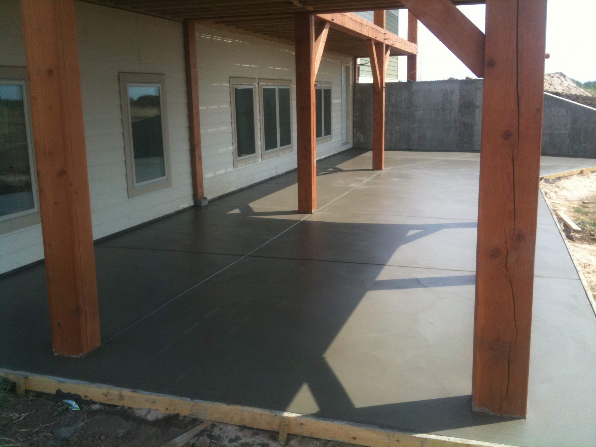

porch cap, patio, drive pics
Progress pics 162.jpgProgress pics 142.jpgProgress pics 144.jpgProgress pics 145.jpgProgress pics 156.jpgProgress pics 158.jpg

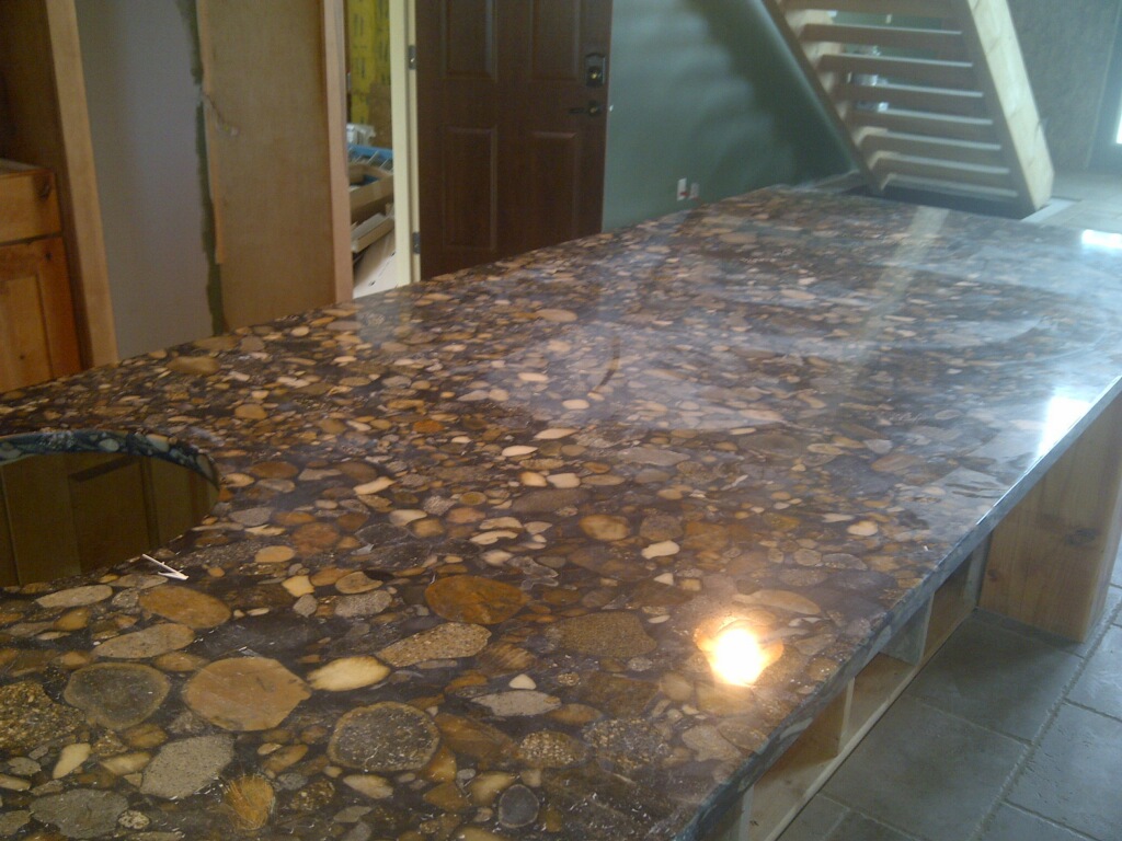

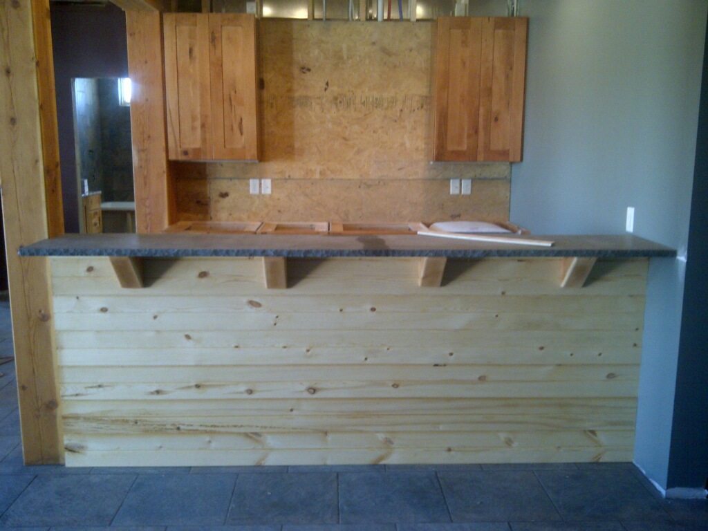

#11

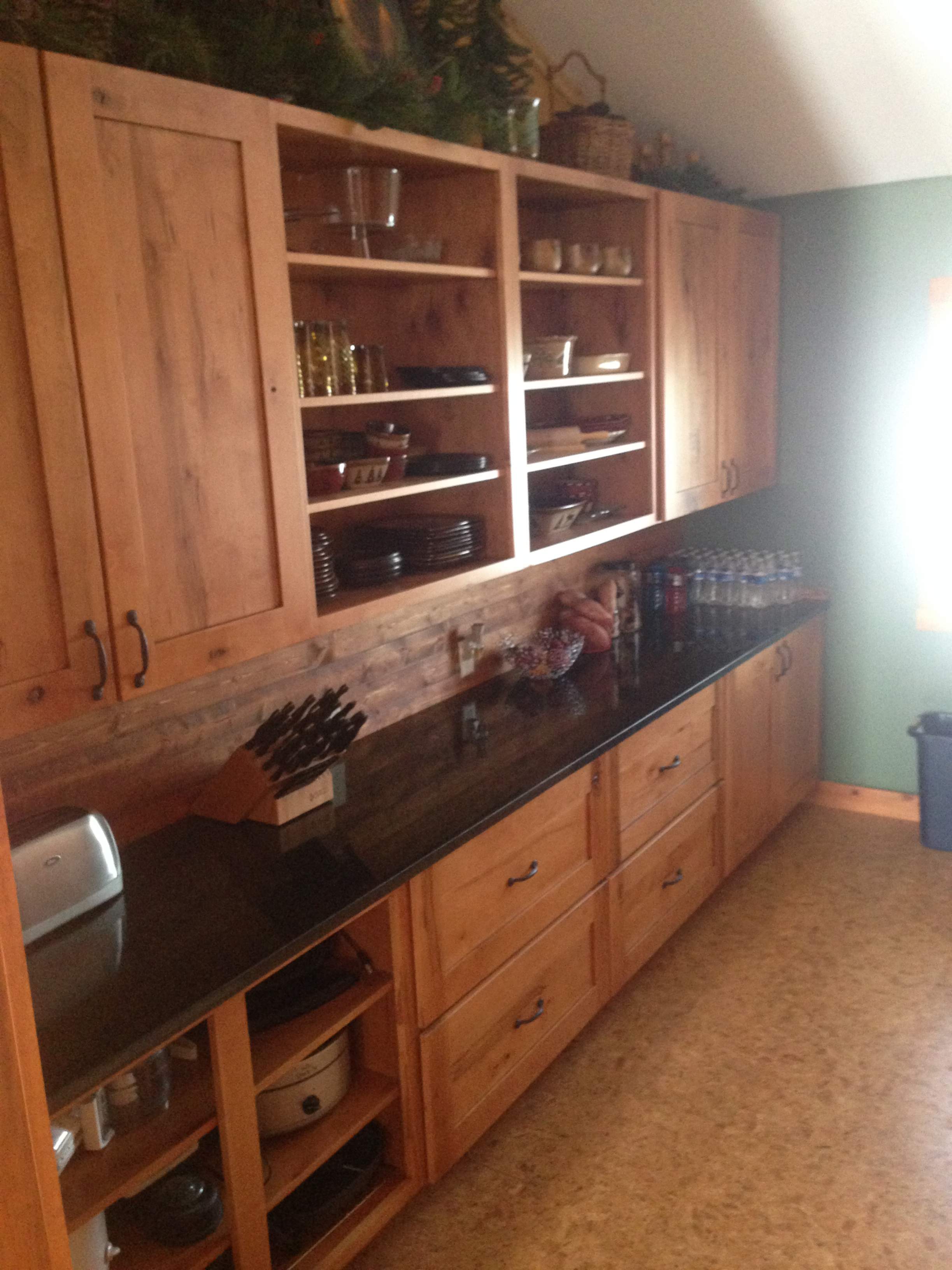

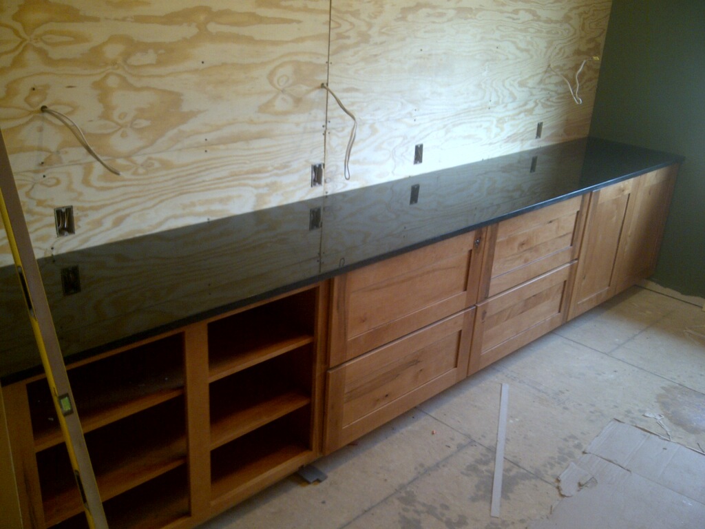

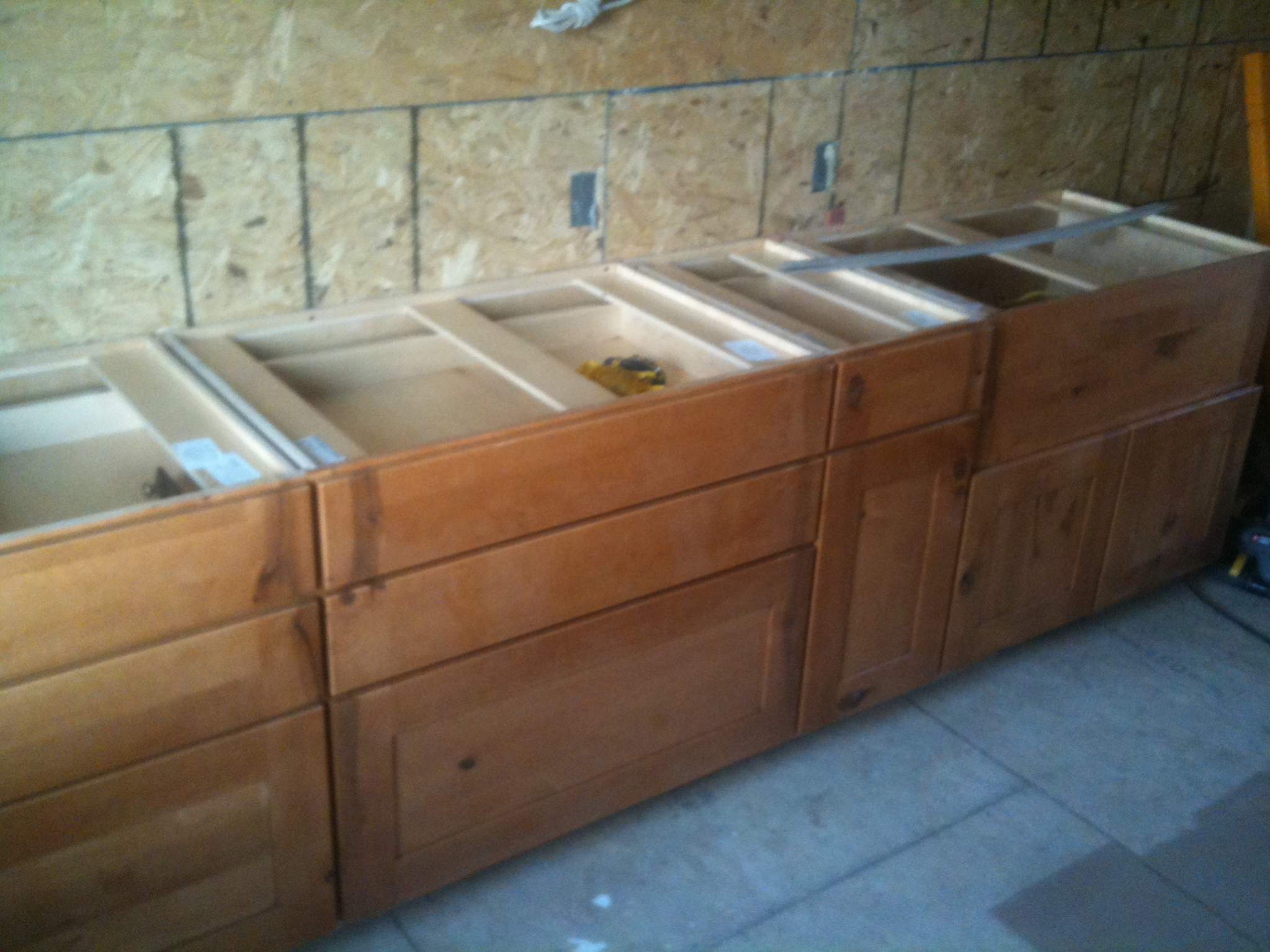

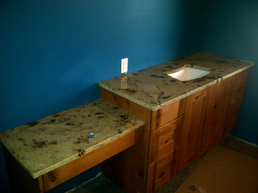

Cabinets, Granite, and stone
Progress pics 128.jpgProgress pics 131.jpgProgress pics 134.jpgProgress pics 140.jpgProgress pics 145.jpgProgress pics 147.jpgProgress pics 152.jpgProgress pics 158.jpgProgress pics 160.jpgProgress pics 161.jpg

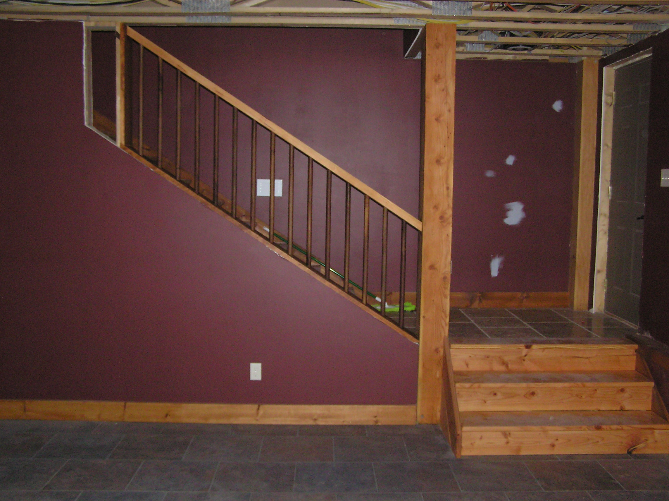

Stairs and railing
Douglas Fir with Walnut spindles
IMG_0045.jpgIMG_0019.jpgIMG_0020.jpgIMG_0021.jpgIMG_0026.jpgIMG_0031.jpgIMG_0035.jpgIMG_0038.jpgIMG_0041.jpgTimberFrame House 110.jpgP1010022.JPG

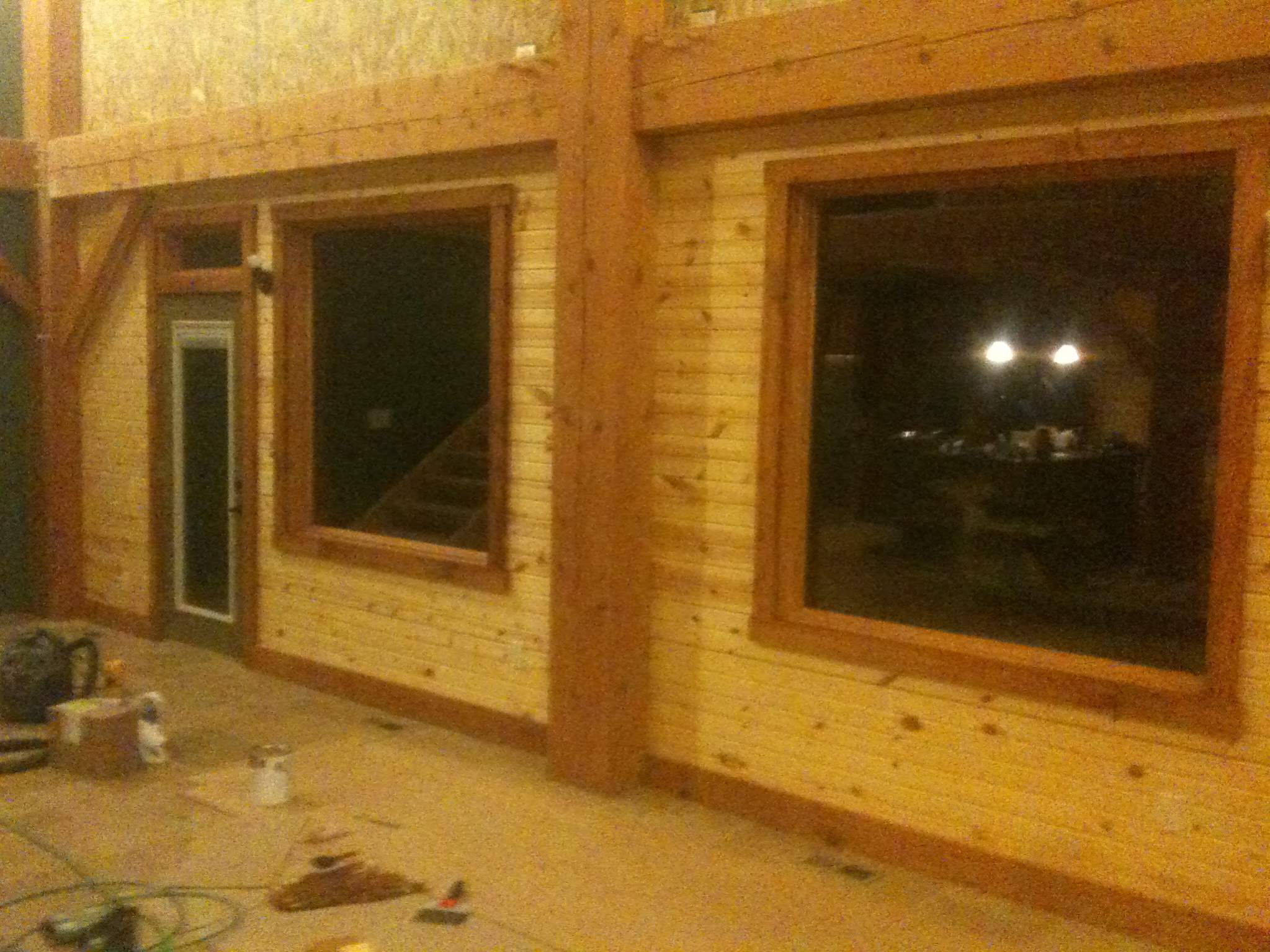

All previous pics were taken during 2012 build
We moved into the house in Jan 2013 and continued to finish trim, some re-painting, getting unpacked putting a yard in, planting 127 trees, etc
following are recent pics of nearly completed project (are you really ever done?)

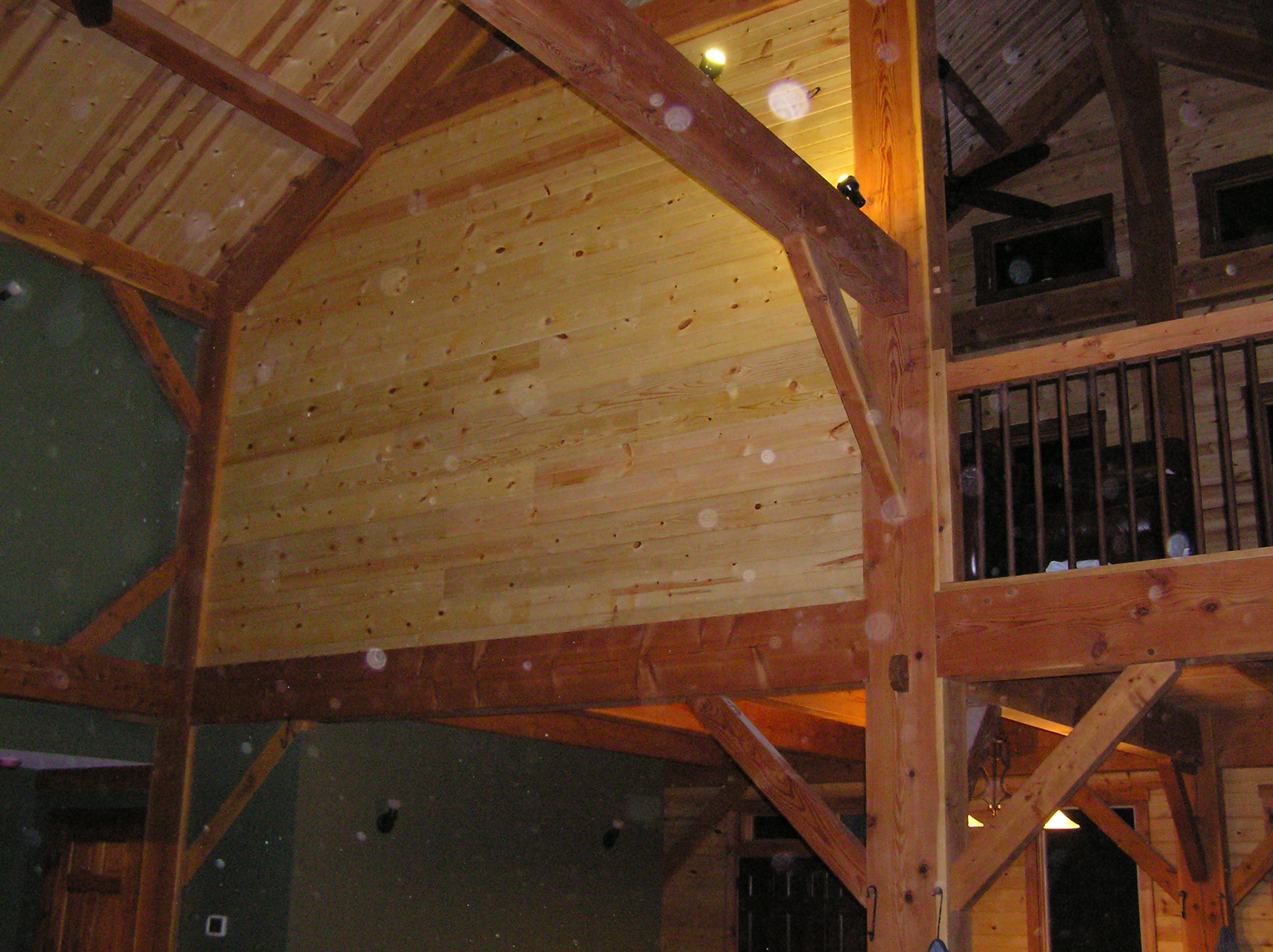

Great room, dining room, Kitchen and Butler's pantry - main Timber frame 3 - bent (32' x 36' x 28.7' peak)
TimberFrame House 079.jpgTimberFrame House 067.jpgTimberFrame House 071.jpgTimberFrame House 072.jpgTimberFrame House 073.jpgTimberFrame House 074.jpgTimberFrame House 075.jpgTimberFrame House 076.jpg

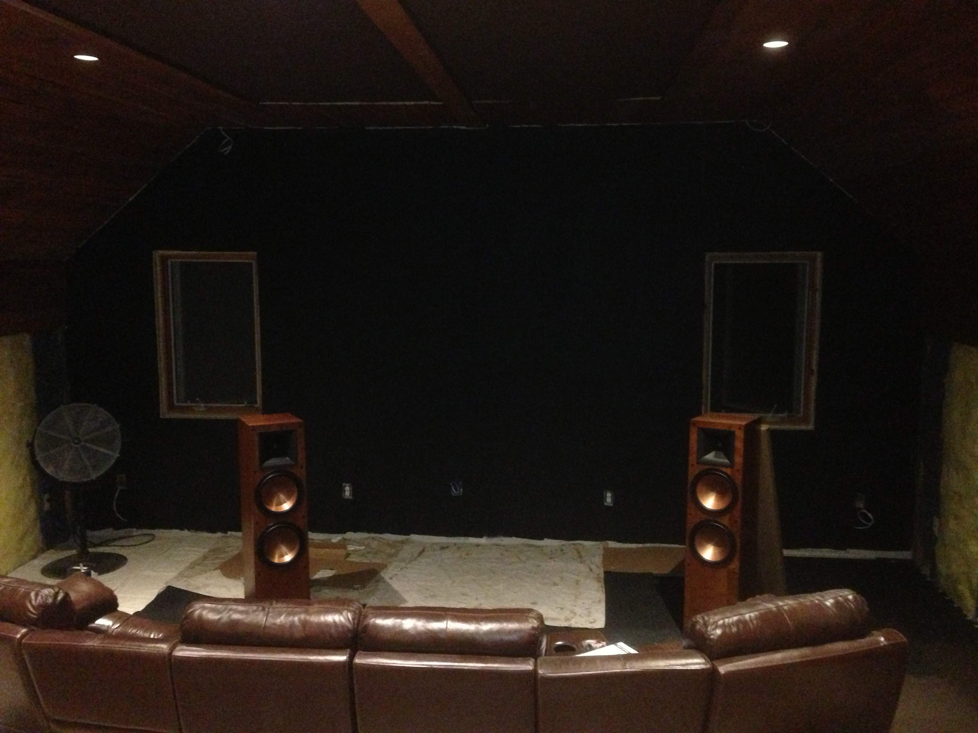

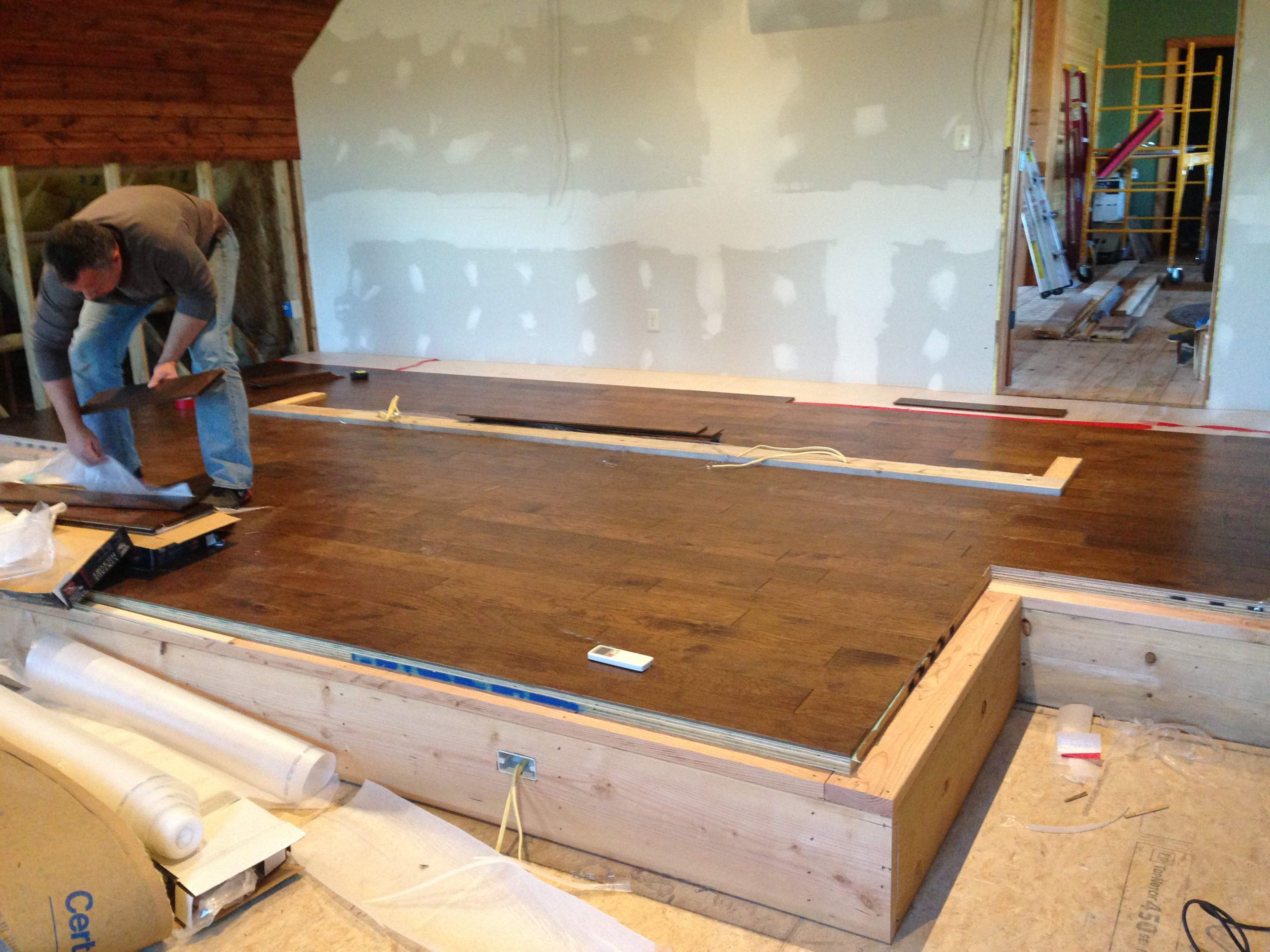

#19

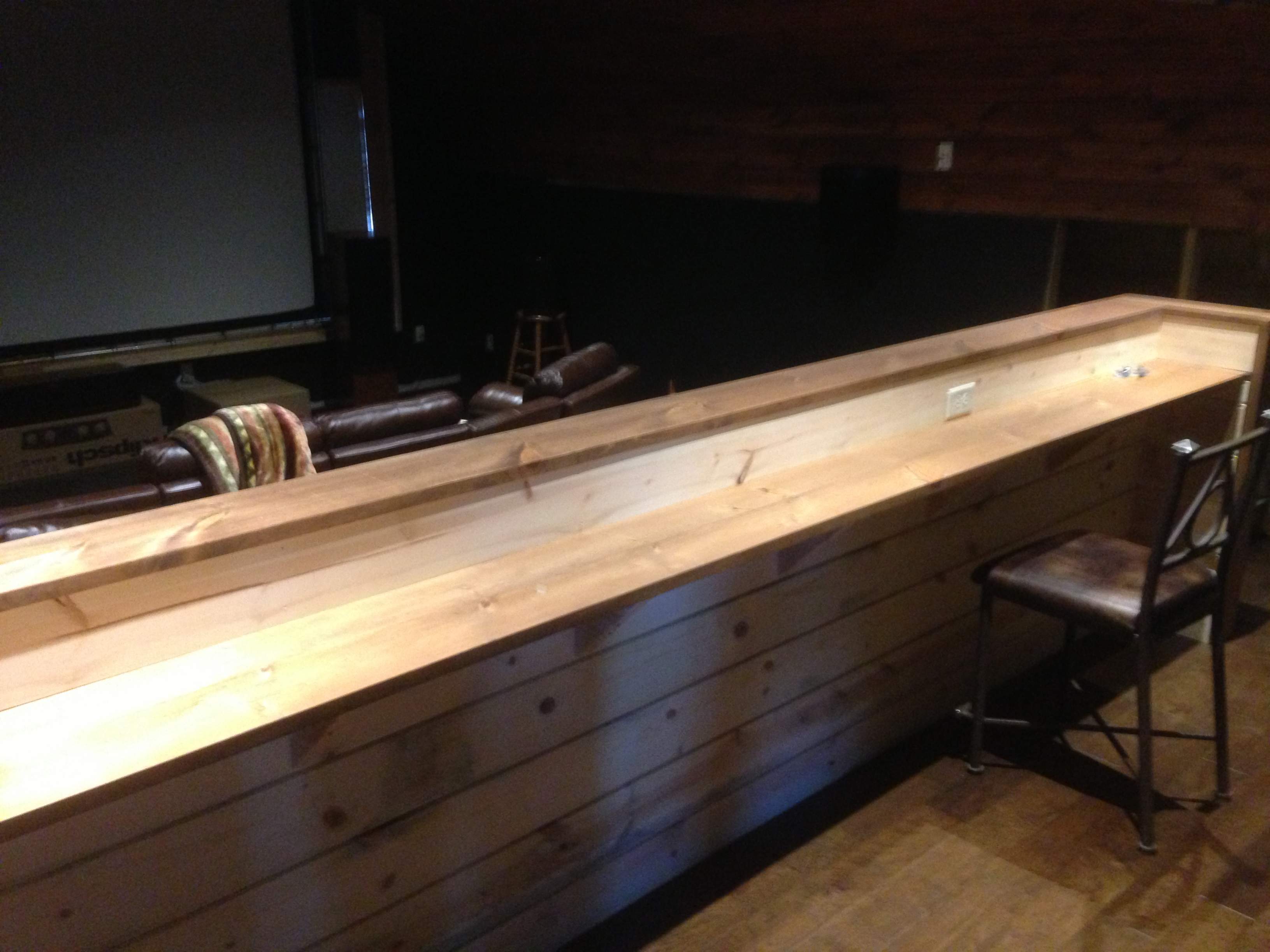

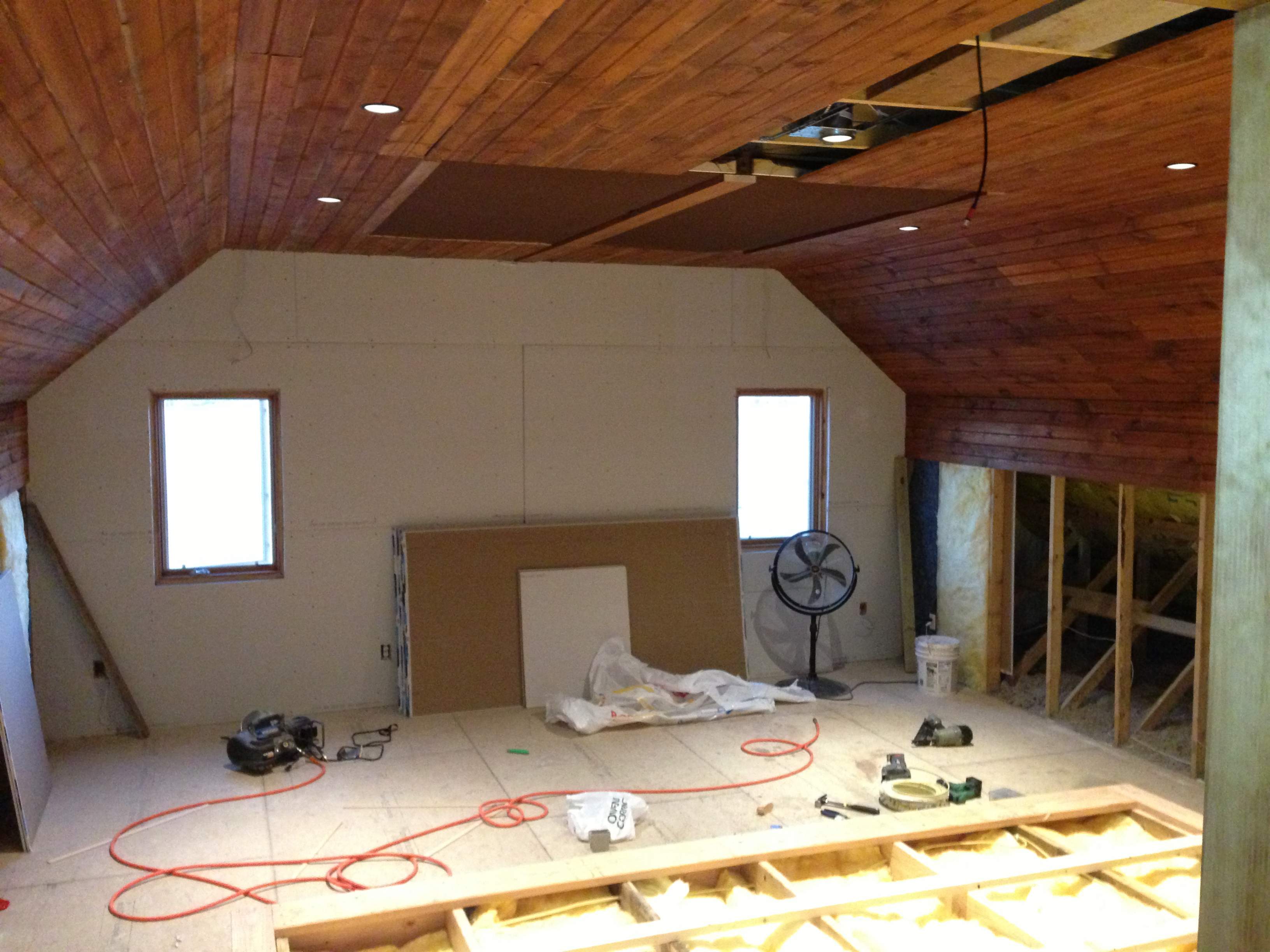

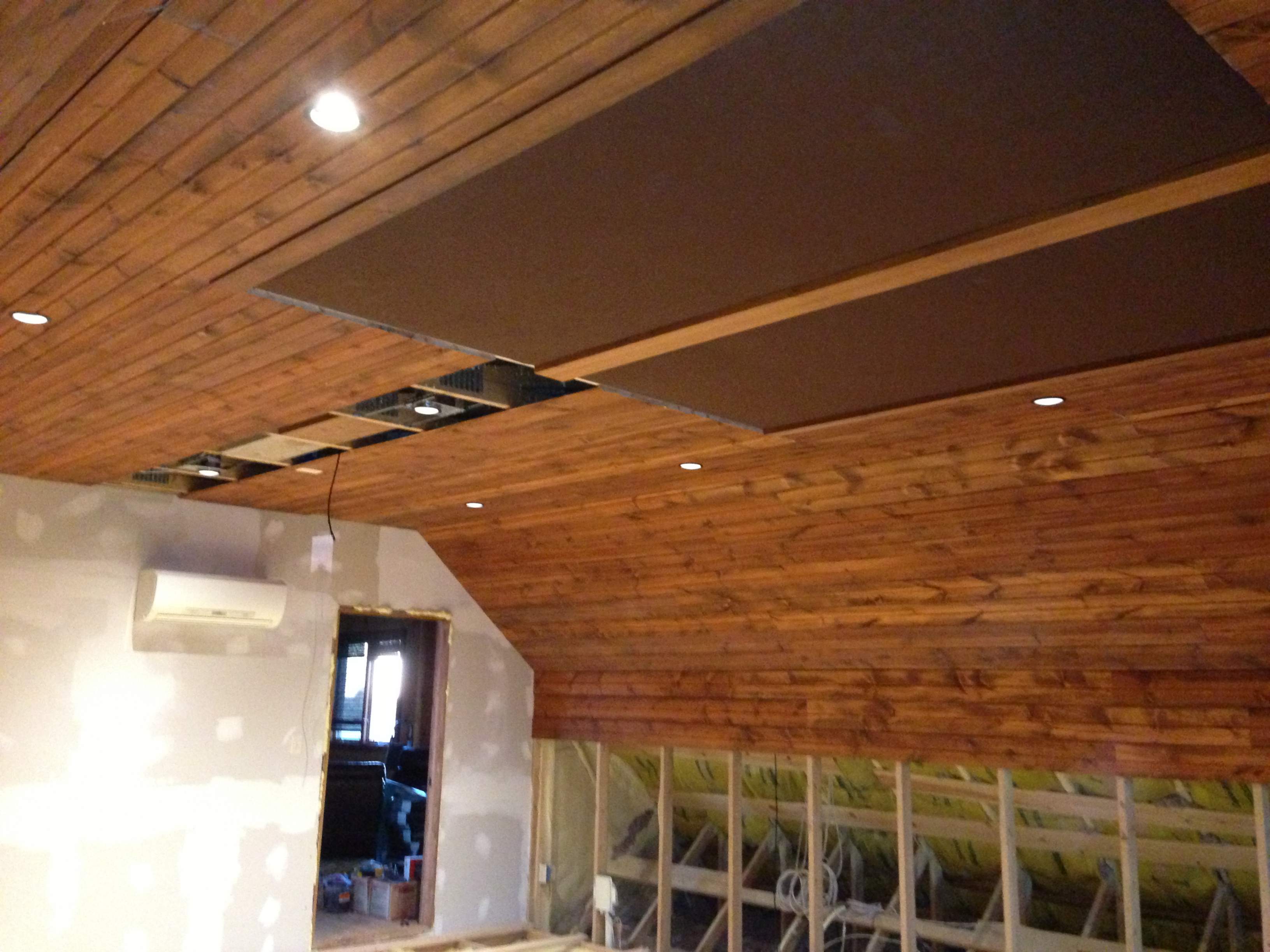

We moved in with the bonus room over garage unfinished - it is a space that is 20' x 25' x 10', with sloped ceiling
Just prior to Thanksgiving I started turning this area into my Home Theater
I am not quite finished but it is functional (first movie my wife asked "does this mean the trim is never going to be done?" she knows me too well:confused3:
IMG_0044.jpgIMG_0018.jpgIMG_0023.jpgIMG_0024.jpgIMG_0025.jpgIMG_0029.jpgIMG_0039.jpgIMG_0040.jpg
