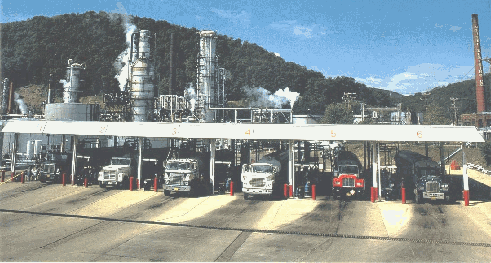

I work for an oil refinery in PA. The only difference in on and off road diesel is the red dye. It's all about taxes folks! We are at this time in the midst of a turn-around on our large diesel hydrotreating unit to ready it to produce ultra low sulfur diesel. My understanding is LSD was 0.05% sulfur (or 500 ppm) down to 15 ppm for the ULSD.

Iowachild:
Nice rack and I don't mean anything personal /forums/images/graemlins/grin.gif /forums/images/graemlins/grin.gif
Used to haul refinery products years ago when it was top load bottom unload, pre vapor recovery. Along comes the EPA, Haz-Mat Endorsements and a bunch of extra work.
