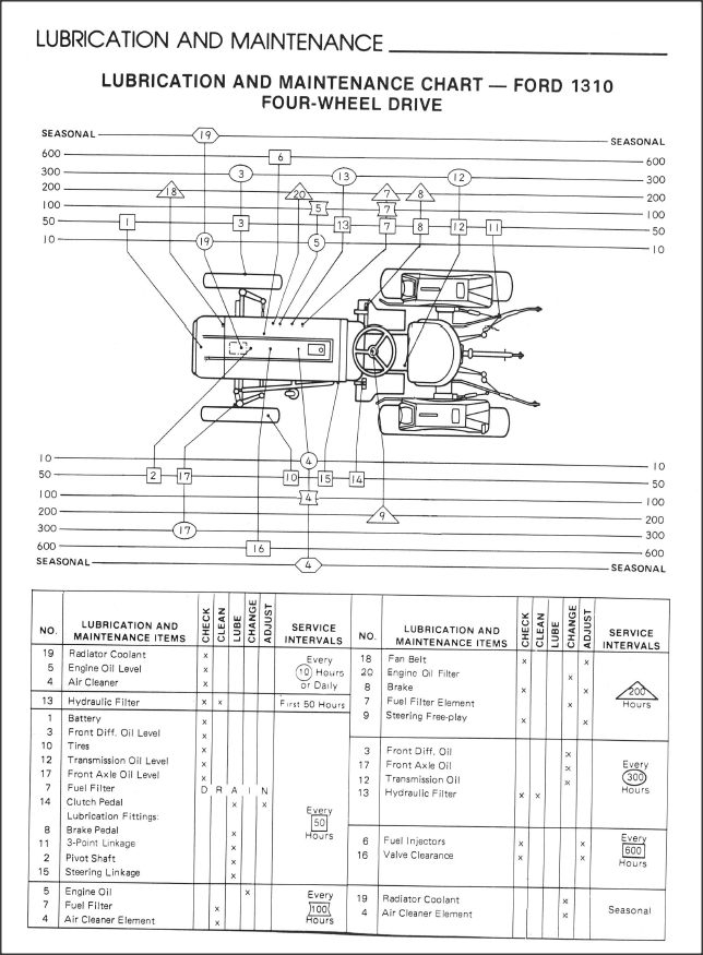

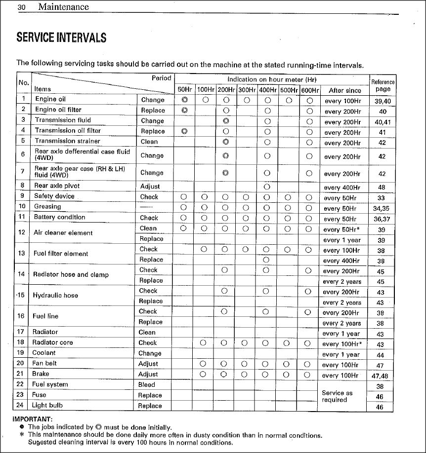

Thanks for the advice, maybe I should point out to Kubota and Ford how mistaken their recommendations for their Diesel engines were!
They both recommend 100 hour engine oil change intervals under ideal conditions.
I think I will continue 50 hour intervals since it's not always ideal conditions here.
You know, short 15-20 min runs occasionally etc. etc.
Oh, and it can take 3 years to get 50 hours of use sometimes, sometimes only one year.
Ford manual:
Kubota manual:
Cheers
Ford manual:
Kubota manual:
Don't be snarky. Oil and engine technologies change and drain interval recommendations do as well. What was recommended for your 30+ year old engines is different than what is currently recommended for new engines.
It's your dime, do what you want.
