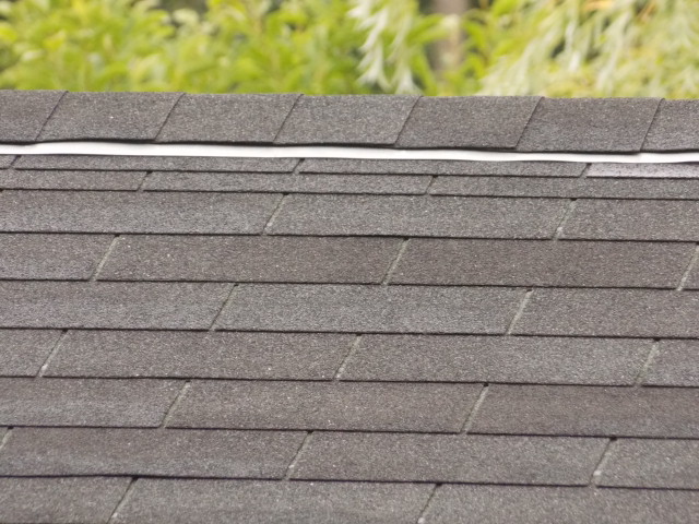

I would advise you, if you are using asphalt shingles and have problems with algae growth, especially on north side, to look at zinc strips. These strips are placed near the peak of the roof and rain interacts with them to made an acid rain which kills the algae. Home Cheapo around here sells them in 50-ft rolls for about $30.

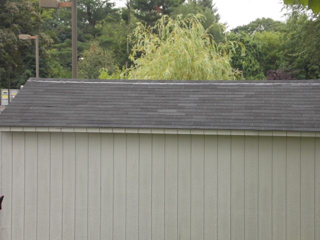

I re-roofed the shed at my church last fall and put the zinc strip on the eastside of the shed. On this side there wasn't much sunlight due to trees. I shot a couple of pics to show what the strips look like. I understand that some shingles are impregnated with the copper. However, for me, I always like a backup to the backup.
