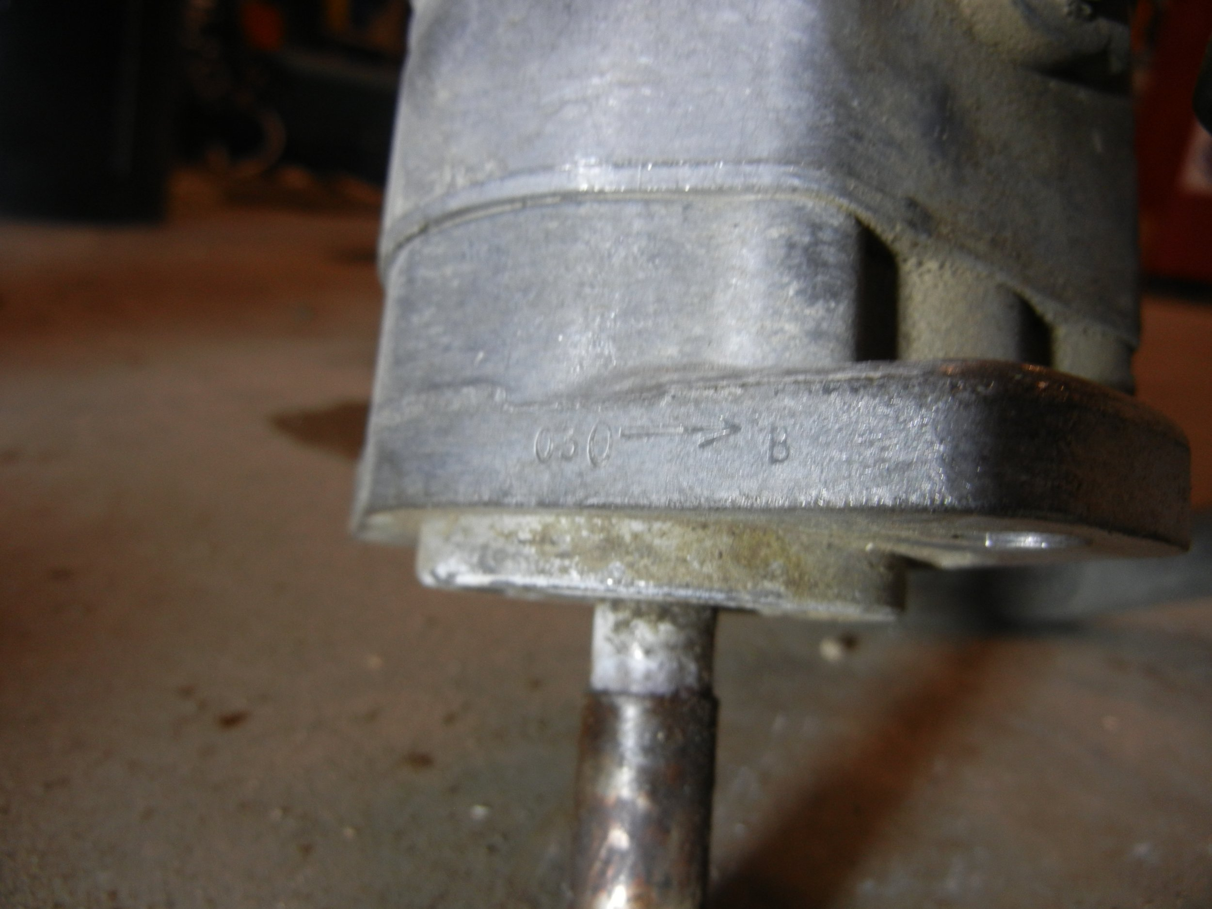

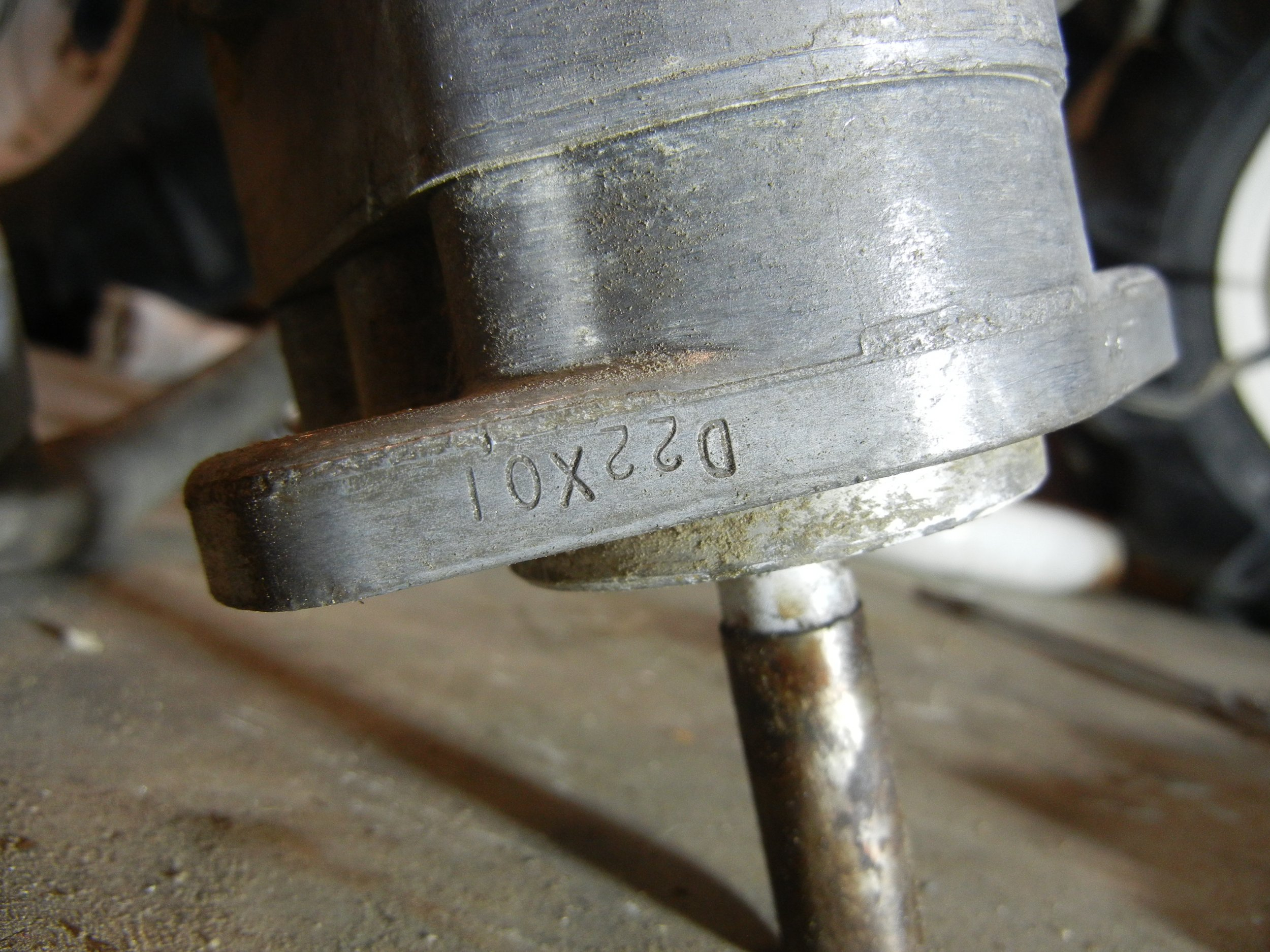

Would anyone know what hydraulic pump Blackhawk used for the FEL Attachment installed onto these Tractors?
Mine has DX22X01 stamped on the side, but no manufacturer’s name.

Do you need a new pump ? As old as that is I'd be surprised if that particular pump is available. My pump supplier may know what it is & can probably supply a compareable pump.

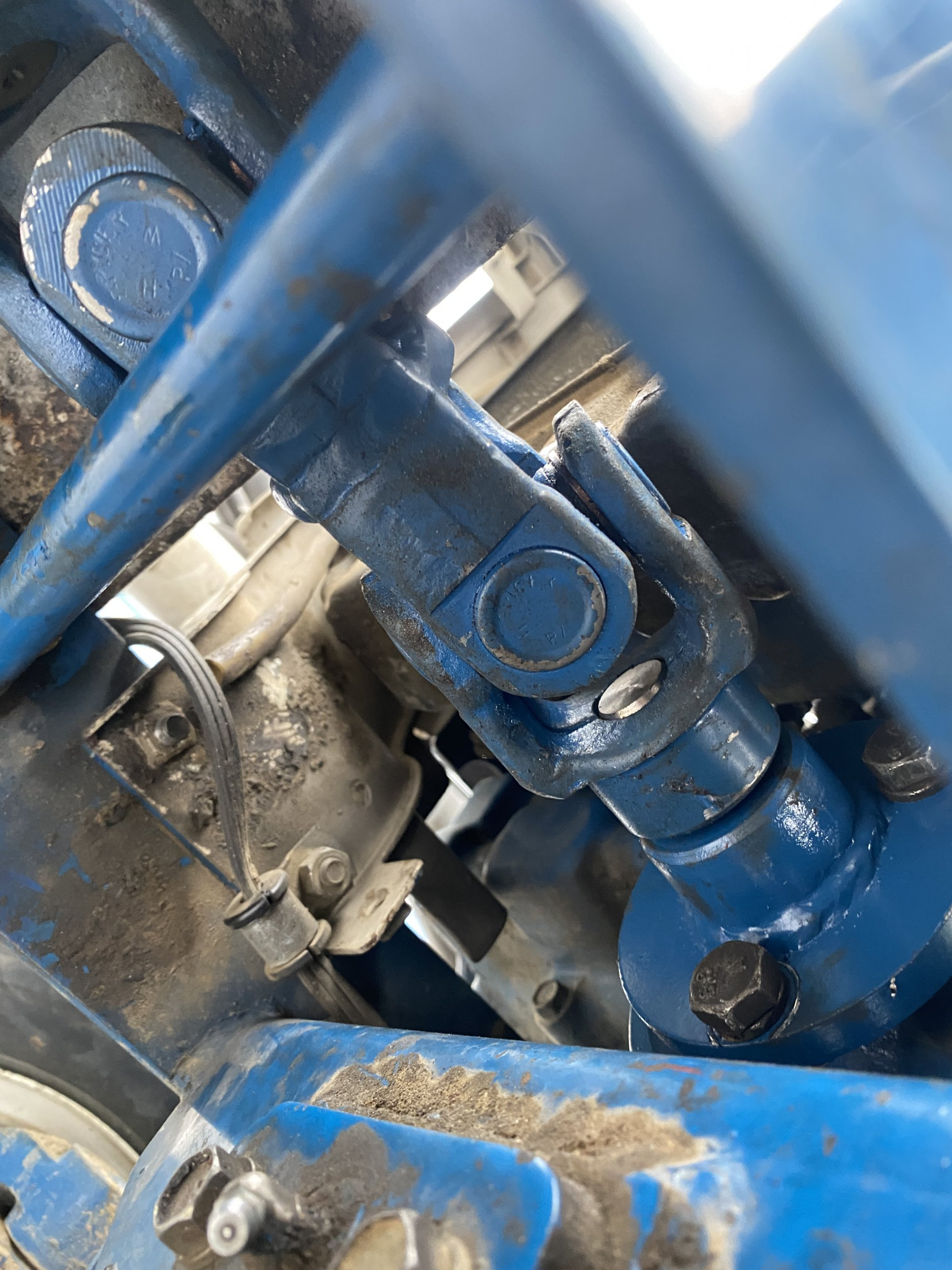

It was more that the driveshaft was failing, however, I upgraded the pump with approx 30% more Gpm's and built a driveshaft using Spicer 1000 series yokes & joints. works great!
