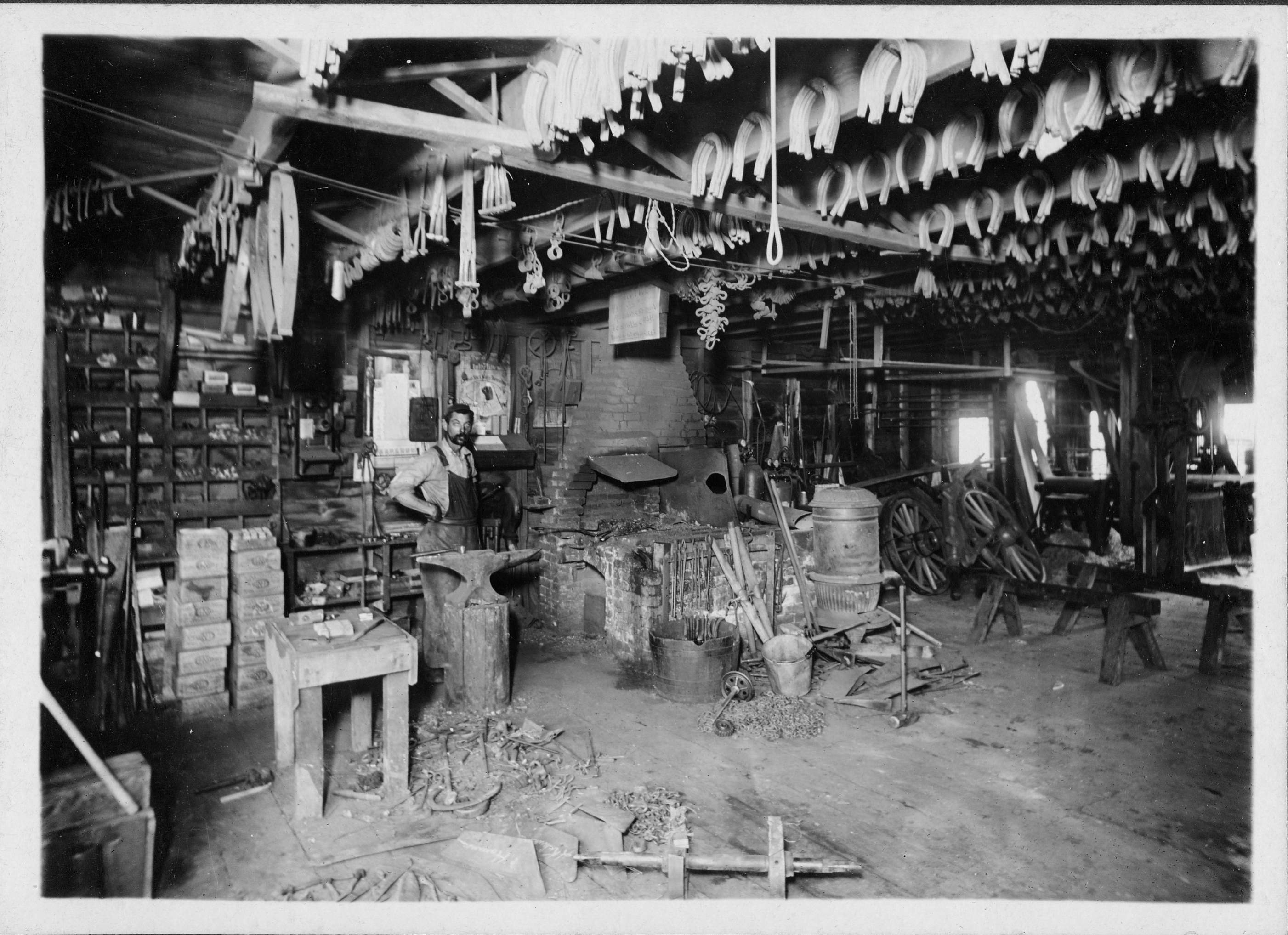

My grandfather had his blacksmith shop for nearly 65 years in central Wisconsin.
Maybe this photo (circa 1915) will give you some ideas for your shop.
No problems with CO asphyxiation in all those years blacksmithing. However, one of my uncles was CO-poisoned working in a tractor service shop in the dead of winter (late 1940s). Cracking the service door turned out to be insufficient ventilation. He and his family moved to Phoenix in the early 1950s for his breathing problems.
Good luck
