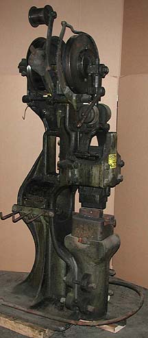

You might get a kick out of this pic, Mark. It's a Bradley 50lb power hammer (blacksmith's hammer). Pic is of the hammer as received, with a 80 year accumulation of coal dust and grease. I've since restored and painted it John Deere green. It's awaiting the completion of the blacksmith shop.

Flat belt pulleys! You gonna run that with a flat belt off yer tractor? My uncle got my grandfather's "shop" and set it up in his garage - all flat belt shafting and a big old motor.
   / Blacksmithing, Forge building #7
Now you need to find an old hit and miss engine to run it.
