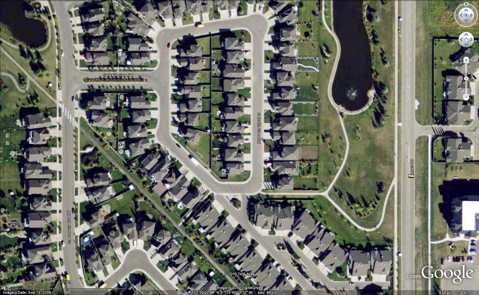

A newer subdivision in Edmonton, Alberta. Note: all the driveways are concrete. Lots of cold weather there.:D
In that high yield, congested sub-division, I'll bet concrete was less work/cost than asphalt. Easier to form and pour those small pads than try and maneuver a spreader and roller in such a tight area.
The tolerance looks so tight in that plan it's obvious every parking pad was scaled on blue print. With such close tolerances, concrete would be easier to implement.
They may of done the drives at the same time as the walks.
I'm sure they will hold up to the climate, big difference between those and a 300 ft hilly driveway in the woods though :)
