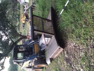

IMG_9698.JPG <my 72" Bradco I customized.
Thanks folks for the info. I have been able to work out some calculations. This for the neighbors 60" brush cutter...for his Bobcat 663 with 15gpm. In light of these calculations, I am going research direct drive units a bit and compare costs.
Motor Torque in-lbs. RPM @ 15GPM Gear box Ratio/RPM Cutter Circumference Blade Tip Speed (feet per minute)
1:1.46 1:1.93 56 x 3.14 1:1.46 1:1.93
6.15 CU 2936 563 822 1087 14.65 12,042 15,925
7.63 CU 3643 454 663 876 9,713 12,833
9.59 CU 4579 361 527 697 7,721 10,211
These cutters will only do a little "grass" cutting/mowing. Most of their lives will be spent mulching Cedar and huisache trees. I have read the arguments about the slower BTS for cutting thicker brush, for some time now, and don't agree...not real sure if "brush" and "trees" fit in the same category, but I think they do. I can tell you the performance of my 2 blade cutter is increased with higher RPM. This is especially true when getting into 4-6" trees.
My 72" is turning a regular style stump jumper with 2 standard shredder blades. Some of you with heavy brush cutter experience may be able to chime in...I believe my next step is to go to a heavy stump jumper/blade carrier. I'd like to have a heavier flywheel to increase/maintain momentum. I am torn between 2,3,4 blade types. I'm leaning towards using the heaviest blades...which leads me to believe 2 blades are the way to go...any thoughts?

* and the sideways pic

IMG_9698.JPG Well, I tried to turn the photo on my computer then attach it...still coming up sideways. Sorry, not sure how to fix.
