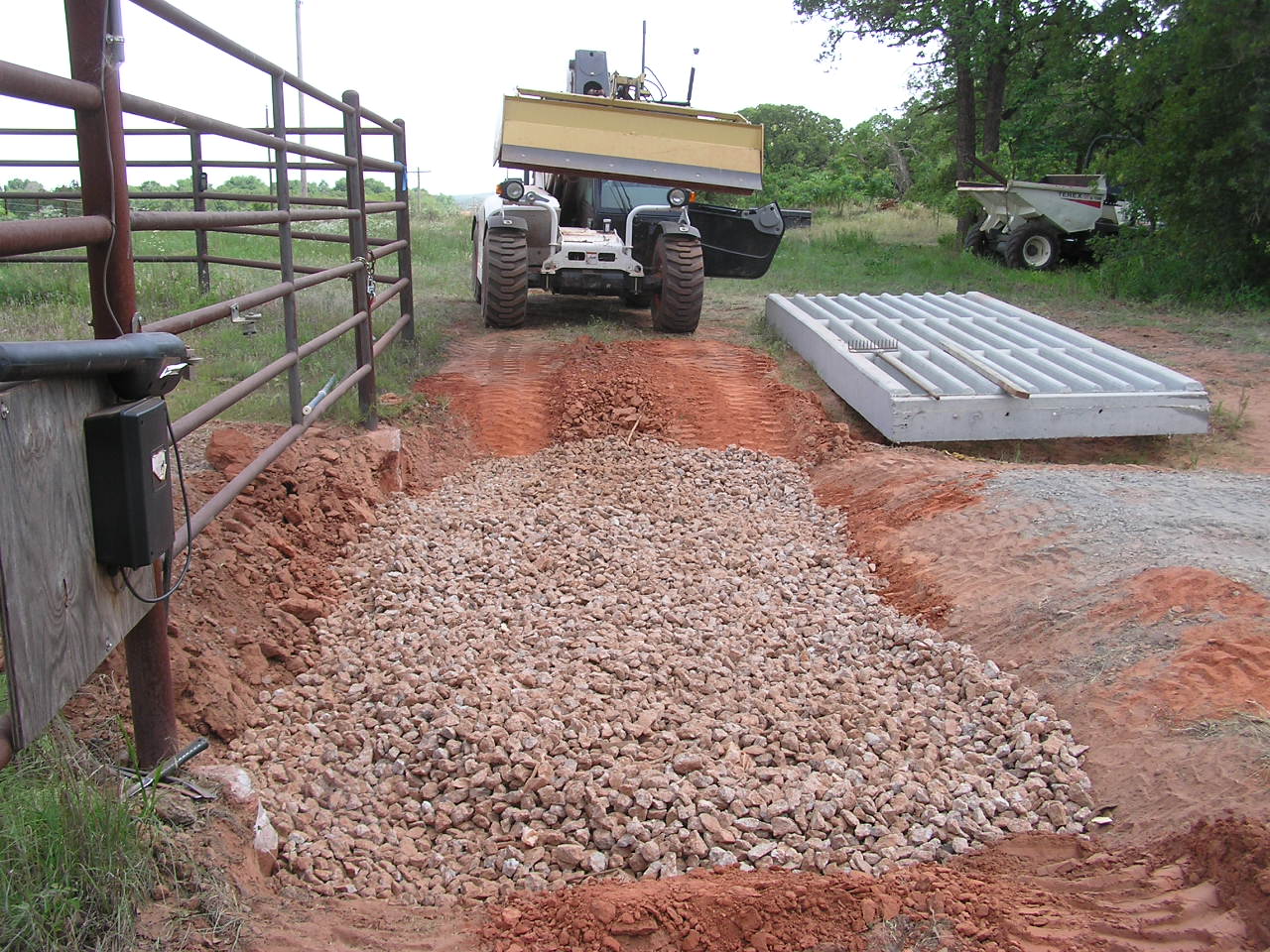

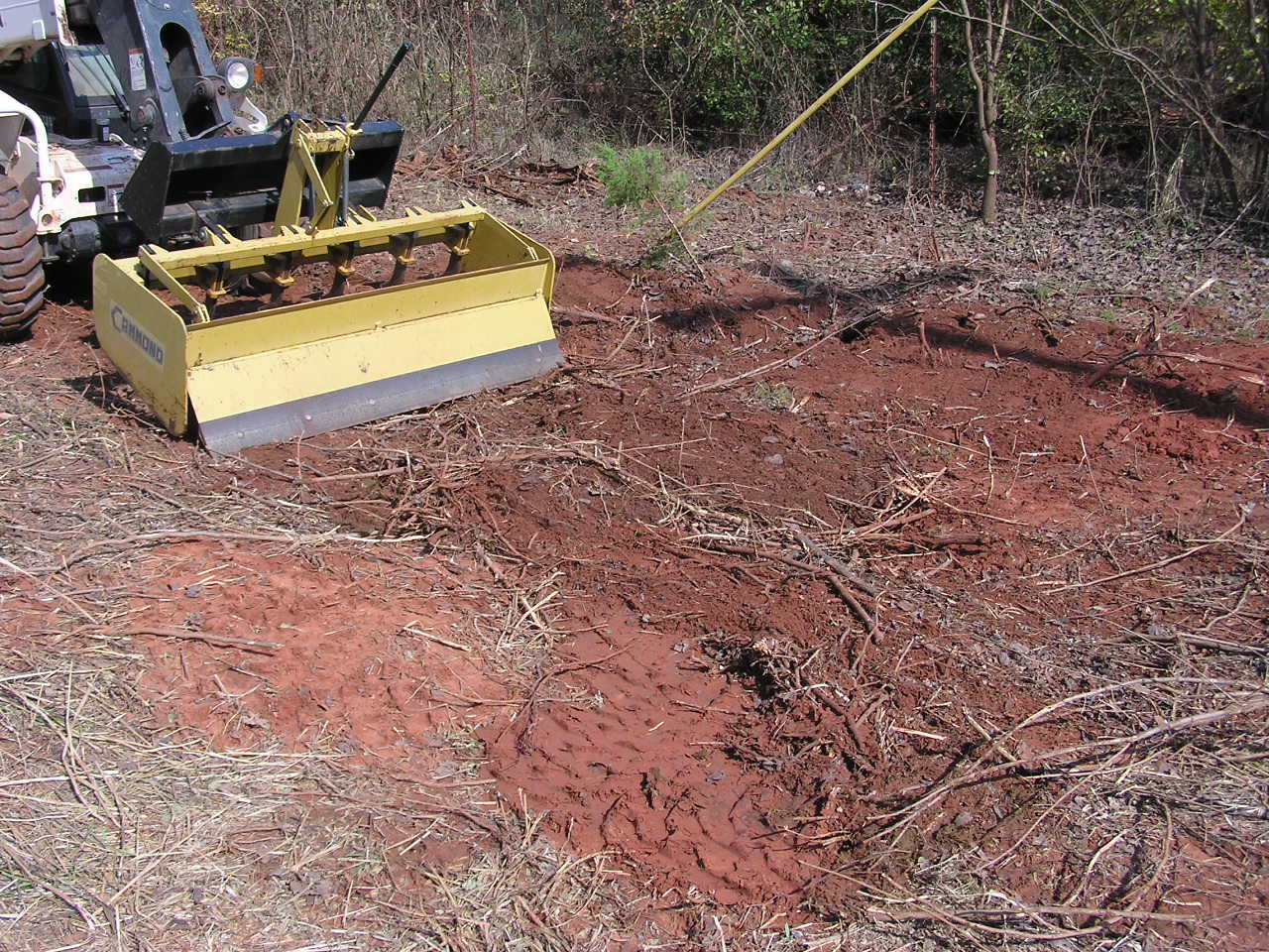

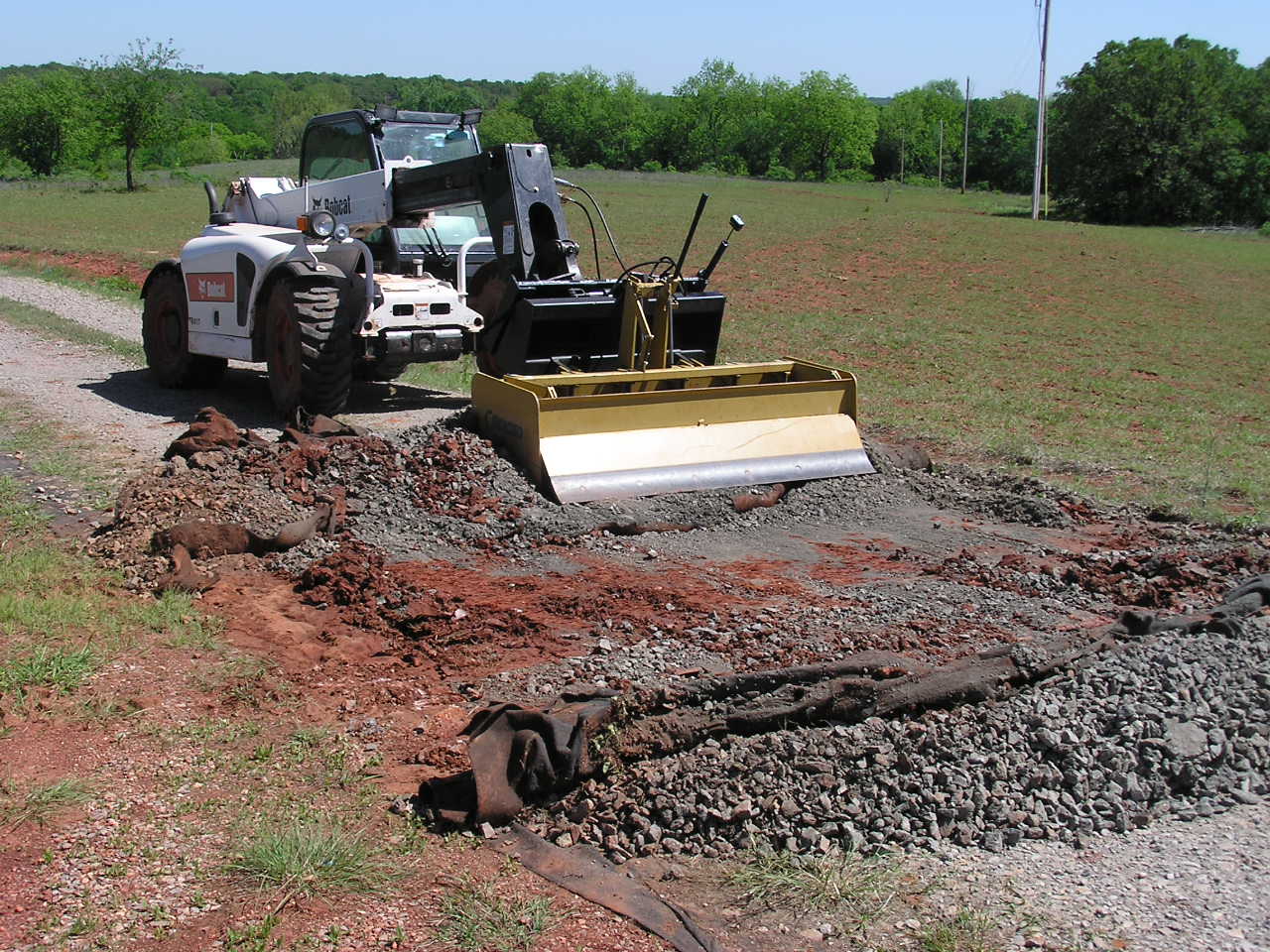

I don't know what you will be using yours for, but here are some of my uses:

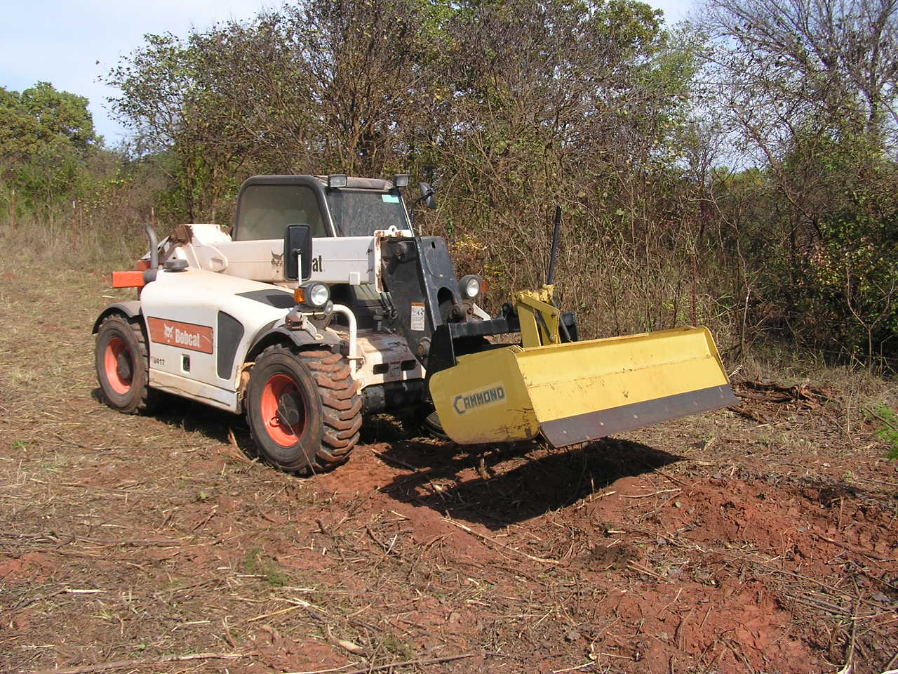

Can you tell if the blade is curved?

Hello XFaxman, from those pictures, no I cannot see a curve.

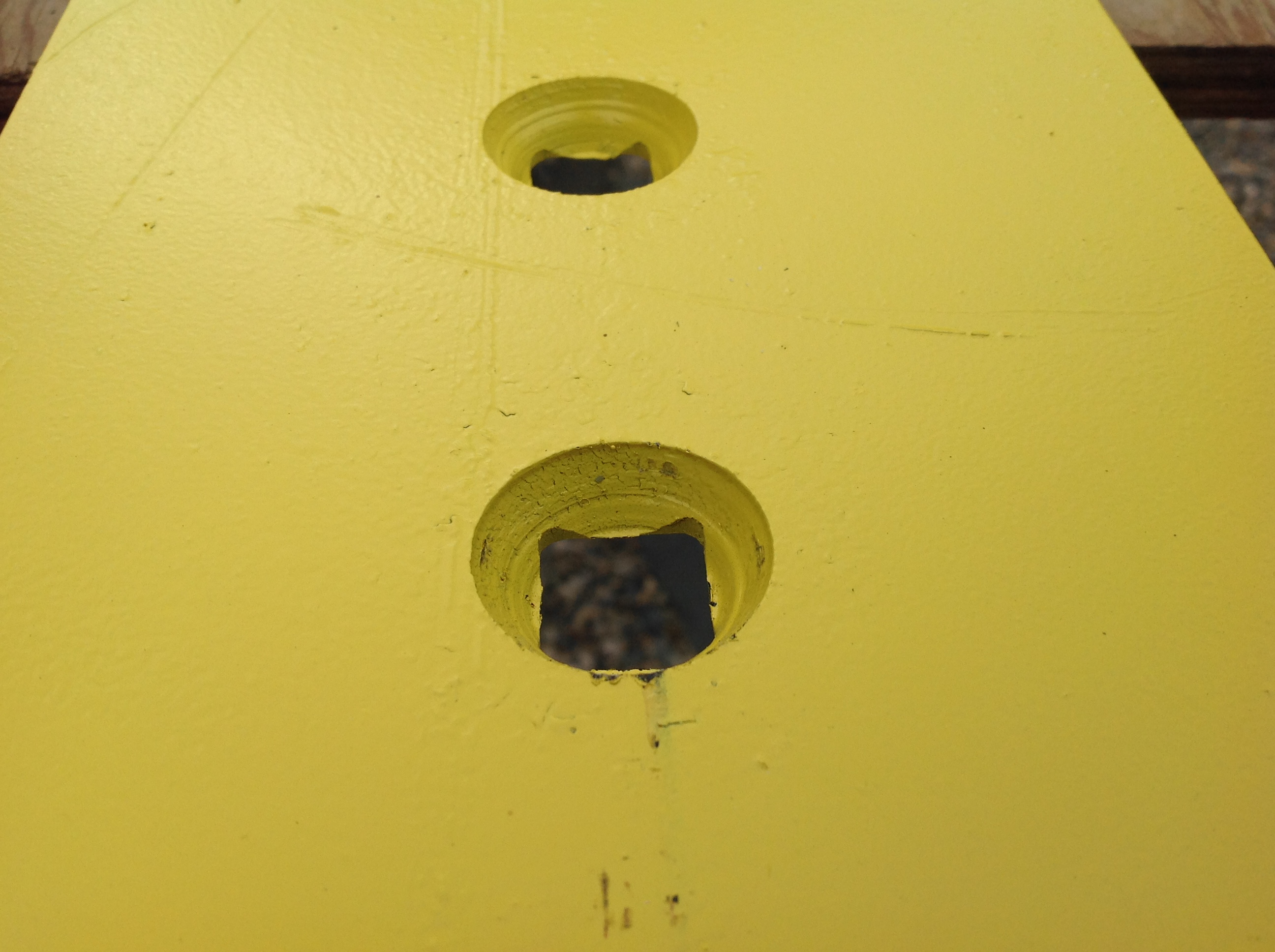

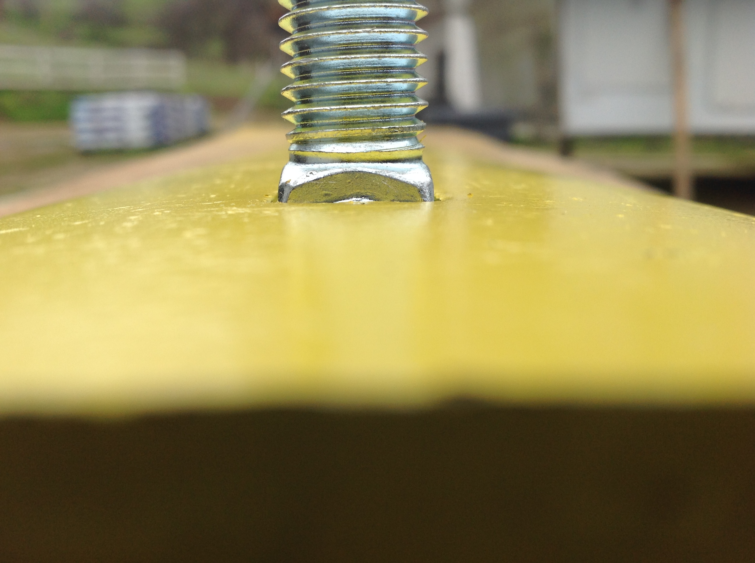

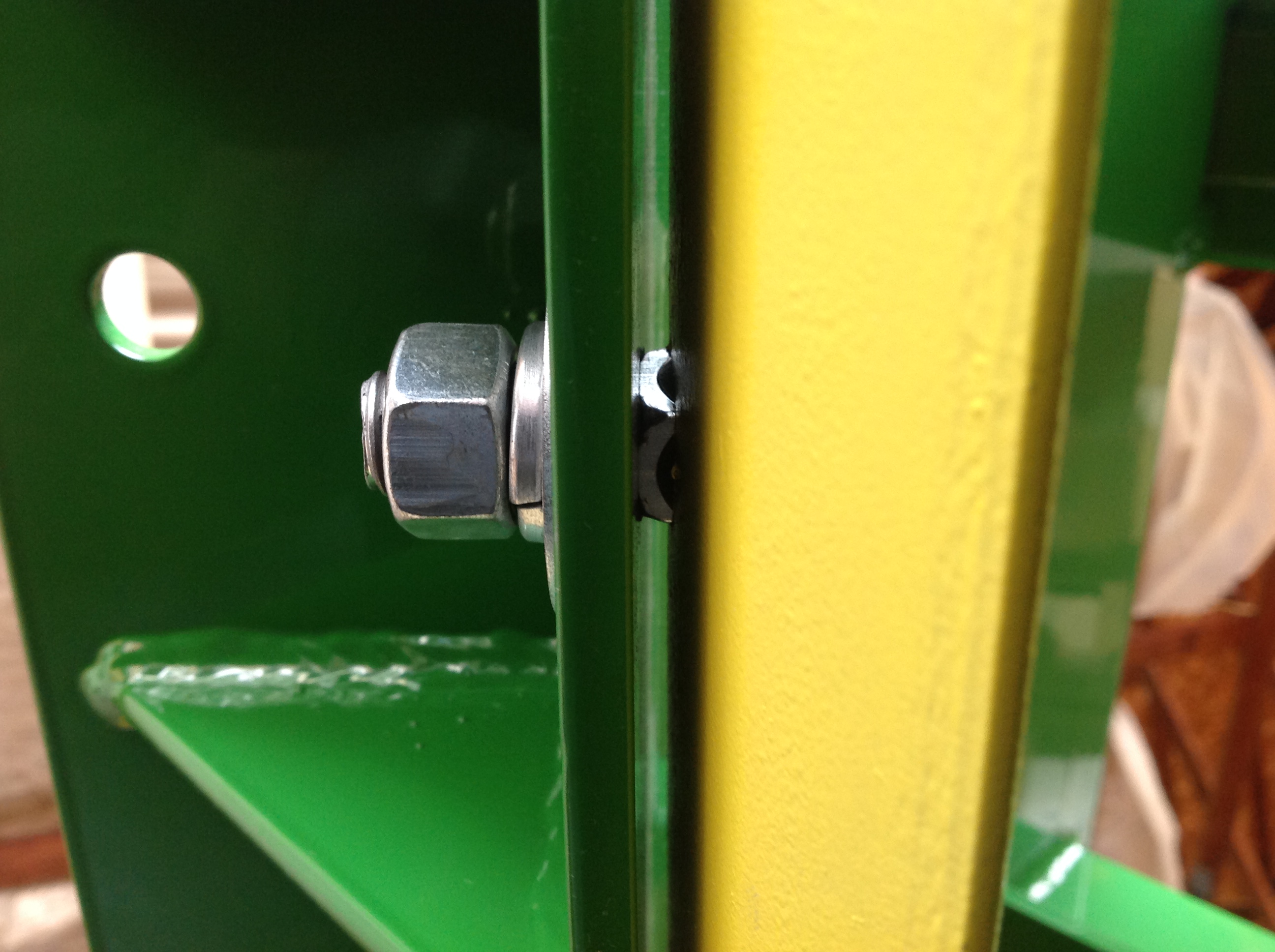

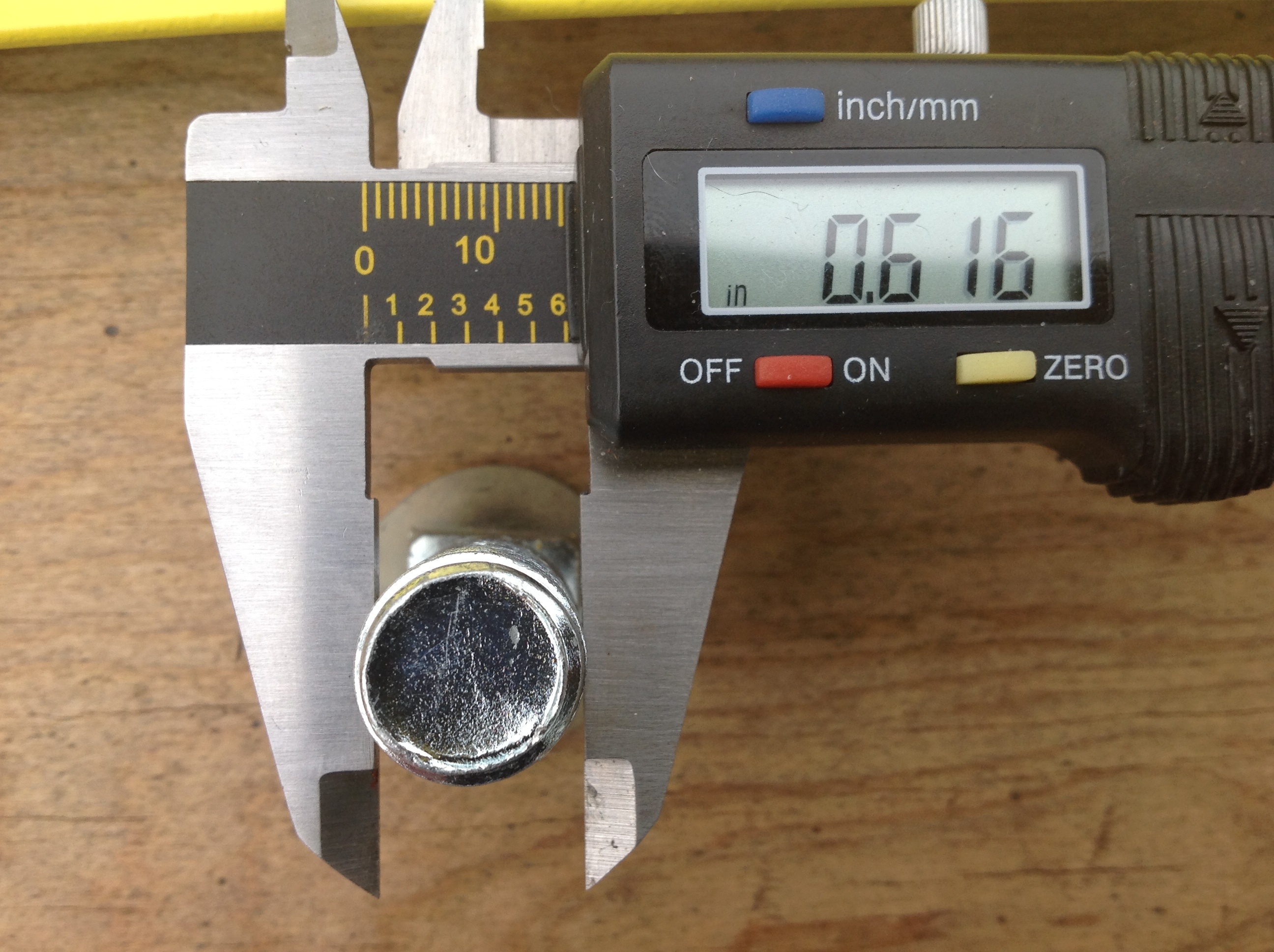

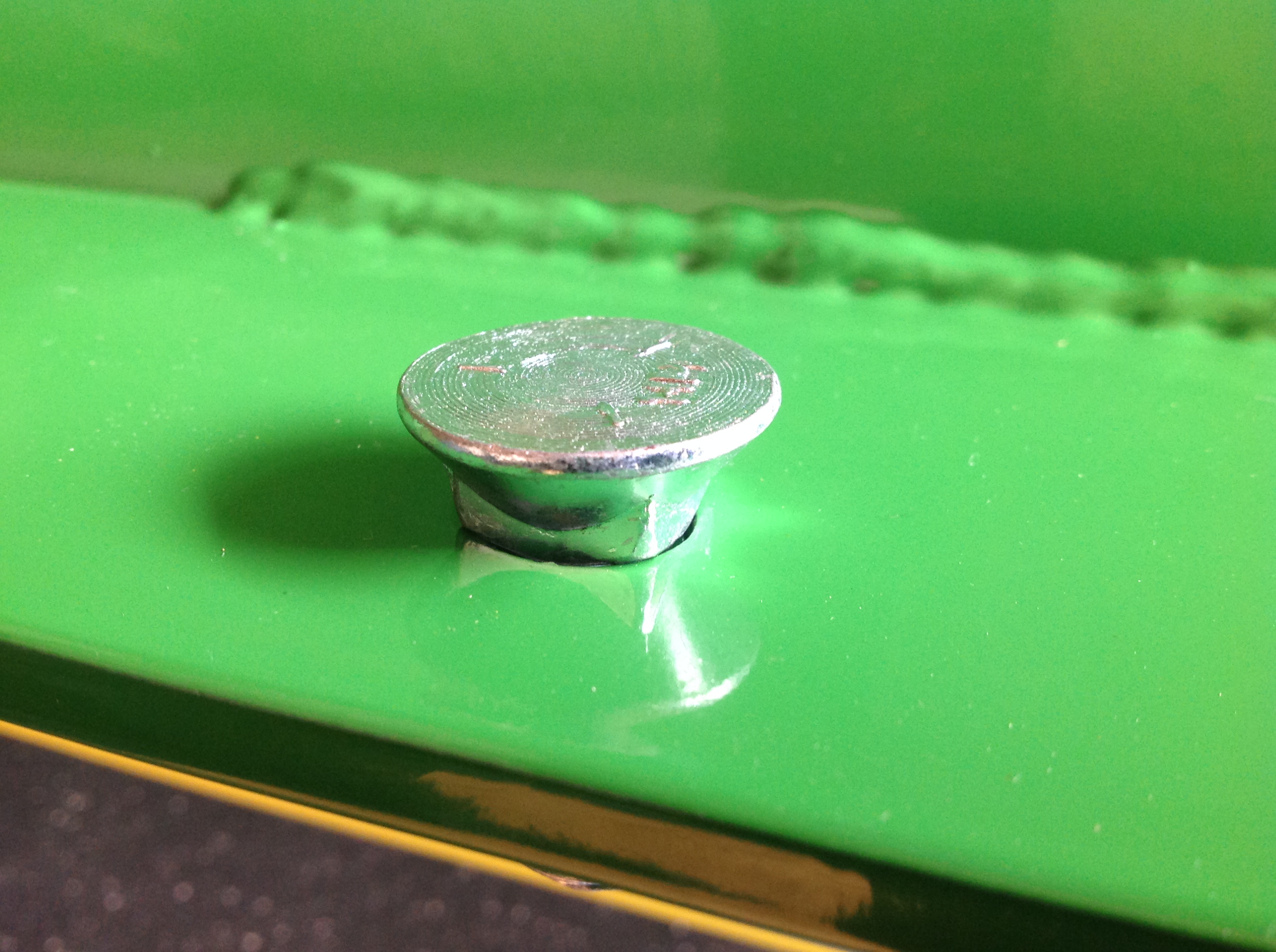

Need some info: I was about to mount the second blade on my box scraper and noticed that the square portion of the bolt will not fit through the hole in the box scraper and if you match up the square part of the bolt with the square part of the hole in the blade, the square part of the bolt extends out the back side of the blade and bottoms out on the hole before the blade and box scraper make contact.
I wouldn't think that they would want you to suck that square part of the bolt through the round hole, that is pretty thick steel. If you don't match up the square you will be able to tighten them up flush but the whole point of the square is to keep it from spinning. Anyone have any suggestions.
Oh wow.
Did EA supply these bolts?
The bolts obviously don't match the cutters. Bummer.
I think if you try to tighten those until you pull the cutter tight against the frame you'll risk pulling the heads off.
Oh wow. Maybe someone that has removed the cutters on their EA BB can chime in with what they experienced. Bummer.

Yes EA did supply the bolts, I think why I was able to mount it up flush the first time is because I did not notice the squares not lining up so as I did my final tightening the bolt spun, the squares aligned and the bolt got loose, then I noticed the problem.
   / Blades on a box blade #108

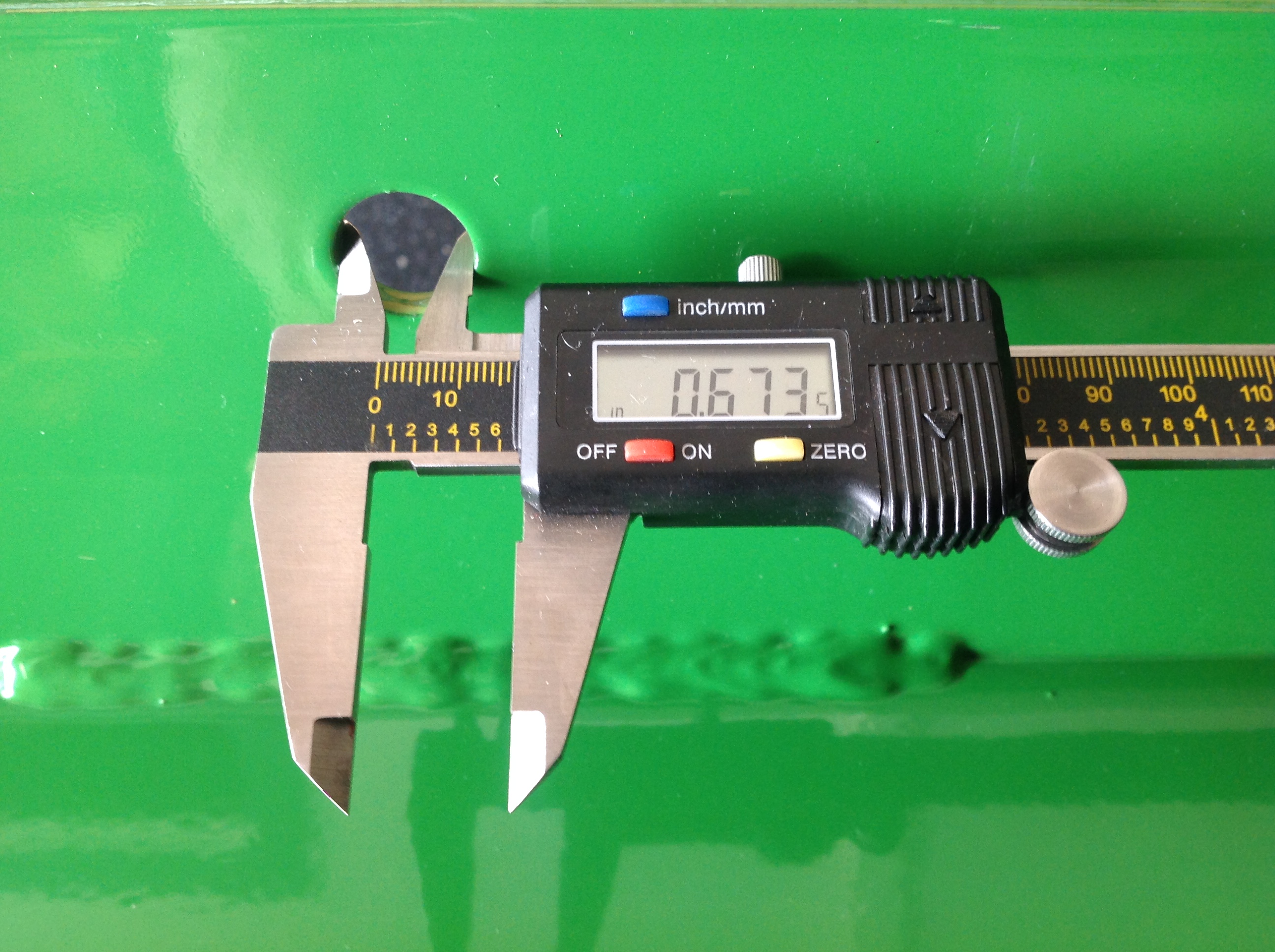

Is it possible the bolts are a size too small???
This would allow the head to go farther into the cutter??
Do they fit the hole in the frame as they should?
   / Blades on a box blade #109
In other words, can you scrounge up a larger size bolt and stick it thru the hole in the frame?
