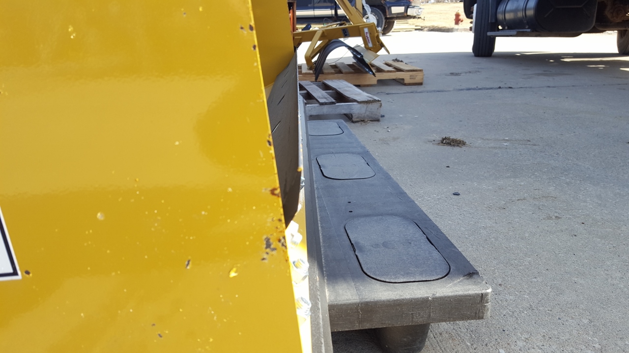

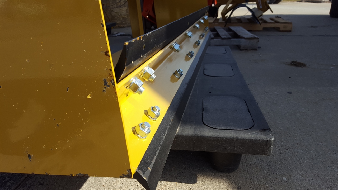

Thanks for posting the additional pics catman8. So with the cutters bolted on solid, the edge of each is now arched?

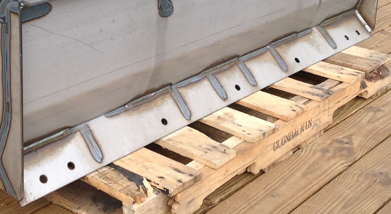

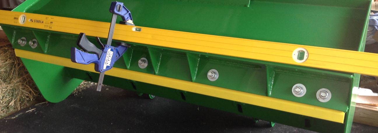

I was at the Farm store today and they happened to have a BB laying on it's face so I snapped a couple pics.
I like these pics. It gives me a good opportunity to point out some structural differences.
The first thing that catches my eye is no bracing on the piece of angle iron. Yes, after looking, angle iron is the second thing.

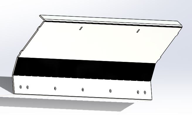

The front cutting edge and what it's bolted to is the highest stress point of all on the box blade. Rather than welding a piece of angle iron to the bottom of a flat piece of steel which is the moldboard on the yellow box blade, our front moldboard is one solid, formed piece. The moldboard, tabs and holes are cut with the laser and formed in our press brake.
Here is the 60" EA 30-70 Box Blade(catman's) front moldboard:
Now that the front is taken care of and extremely strong and rigid, the rear piece of flat steel is added and triangular braces are welded in between, which creates the durable attachment point for the back cutting edge. Not a single one bent to date.

I was thinking of something else, and i'll think it out loud for a moment. The bottom of the box blade looks totally flat here on the pallet:
Is it the location of the straight edge that makes it look worse. Is the angle of the straight edge totally relevant to the position of the piece when it is lying flat on the ground?
It is hard to imagine without actually being hands on with one minus cutting edges.
I'm not entirely excusing the minor bow, but I do think it is well within tolerance. There's way more to our box blades than meets the eye. I've only covered the moldboard so far!

These are some good pictures. To me, it appears there is a 1/8" bow to the flat surface of the rear blade mount. After mounting the blade and setting the box blade flat, that should equate to 1/16" bow (both edges touching and 1/16" gap in the center). That's all that matters is how flat it sits on the ground, not the bow at a 45* angle.
