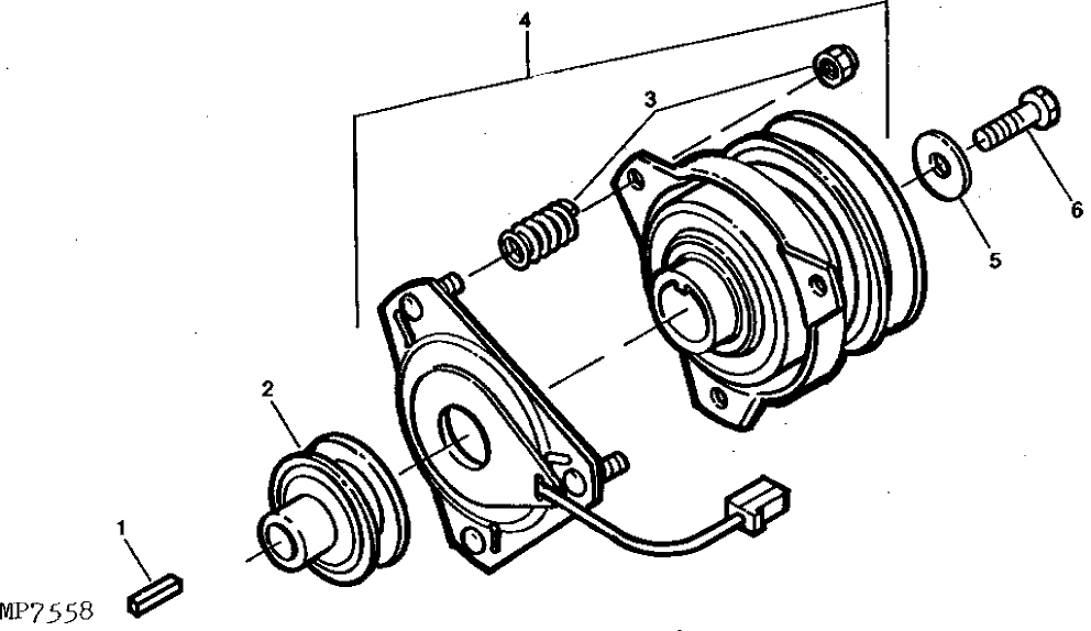

I thought the shaft that comes down from the motor (drive shaft?) has an upper pulley with a belt for driving and a lower pulley that has the PTO. I'm only assuming this.
Looking at the schematic showing the Warner clutch, am thinking you are correct and that lower pulley is key #2.
Dealer (parts) will have electrical schematics, confirmation of which clutch via s/n, and which parts are nla (prolly the ones you may want). But am also thinking what Rick suggests.. need to adjust the air gap.

You are correct upper pulley on engine shaft is to drive the trans axle. Lower pulley is to drive the deck.
The reason to determine which clutch you have is each has a different air gap spec.
   / Blades won't turn on all of the sudden. 1993 John Deere 320 (PTO issue) #15
I would check the air gap. This is done KEY OFF I am guessing you have the Warner clutch. Air gap spec is 0.015-0.025 inch.
You will see three nuts that secure a triangle shaped piece. each will have a spring on the stud above the triangle piece.
Below the triangle piece you will see two round discs.
Check the gap between these two discs with a feller gauge. Use a 0.020 in feeler Check at each of the three nuts. adjust as required.
Nuts and springs are #3 in the drawing
I called my local john deere and he had no idea lol....he said it could be warner or ogura....but i guess it doesnt matter, because that .pdf says .015 inch.....i found that .pdf on this site....not sure if its even remotely related to what i have.

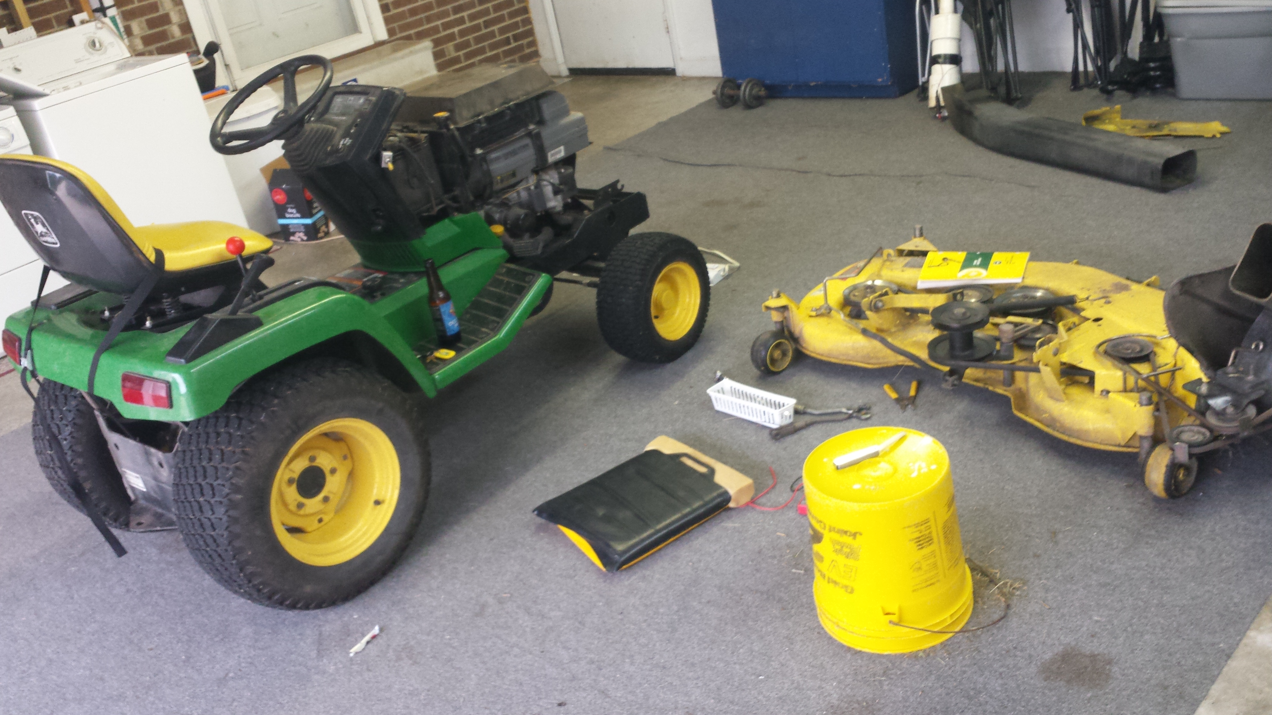

Added a picture, because everyone loves pictures :)
i had the hood off because I have a slight oil leak....i replaced one of the valve cover gaskets yesterday, i'm hoping that fixes that issue. We'll soon find out, something makes me think its leaking oil at the exhaust manifold....but i hope i'm wrong
