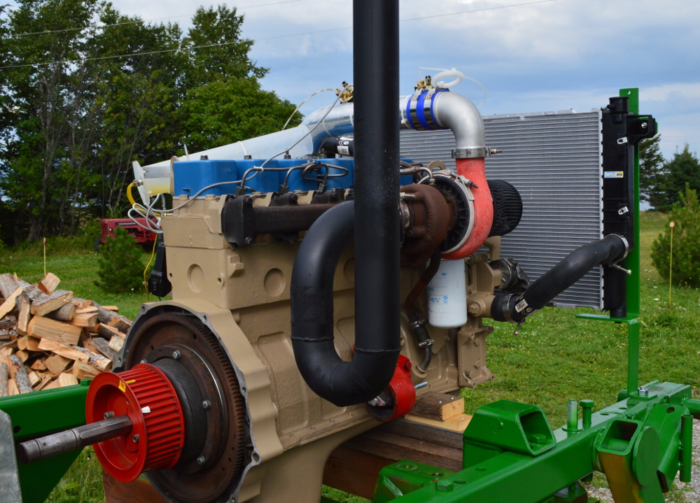

I gave up on the small radiator idea BTW, at least for now, mostly because I have no room on the sides of the engine where I would have wanted to squeeze them in. Should I later find that I don't ned the stock monster I can always downsize later. According to one Cummins user I might even find that the thermostat never opens while running at 1600 rpm, (nearly full torque).

Well I'm afraid those 2 pics just will not do my friend:D
You need to do a thread on this project, even if it take's several years :thumbsup:

I've never experienced wet stacking so far, a.k.a. as cylinder-washing I think where more fuel than oil sprays onto the cylinder walls eventually glazing them (applies to gas engines too). This snow-blower for example is going to run at 12-1600 rpm but the actual load (and resulting torque and work) will be set by the amount of snow and the feed speed. If there's only a few inches then working it hard will not come easy!
As for THE thread I do have an overall 'master' project but it's very hard to keep from confusion with so many sub-subjects involved in it. I think most of my posts on TBN deal with it in some way: "Snow Pump". This re-engining of my existing blower is stage-II of that longer-term three-stage project. I have another 12-valve Cummins that I aim to elevate to 300hp to drive a hydraulic pump on a truck-hosted snow blower as stage-III, in 2019 or more likely in 2020 if the head-office lets me live that long.
Maybe I should name my sub-threads such as "12-valve injection sets [Snow Pump]" to show the parent endeavor...

Speaking of radiators, I ran out of room for the belted fan so I'll have to install an electrical one in front of the rad. My son told me to get a shroud or it will neither suck nor blow; he has an airplane so I asked him "where's the shroud around your prop?" :laughing:
