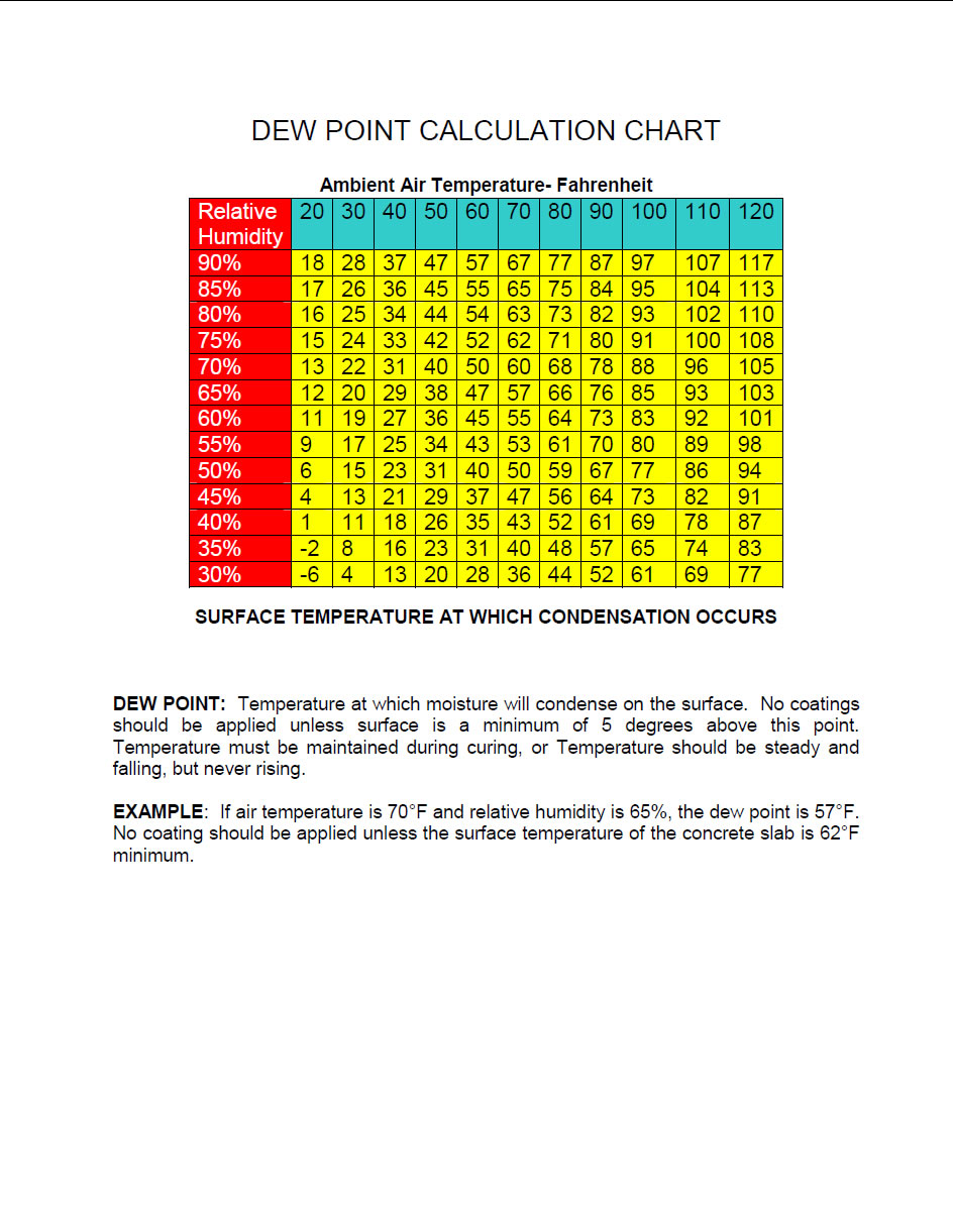

Air conditioning, or the dehumidifier, both reduce the humidity that is needed for condensation to form on a surface that is below the dew point.
The dew point is a fairly high temperature for warm and humid air. Think about in summer how dew will begin to set on grass not long after sundown for example.
The insulation isolates the block wall, a relatively cool surface, from the warm and humid air in an unconditioned space. I don't think most areas out of the south have enough humidity and warmth in winter to cause condensation. In the summer months though, without AC we can have 80 degree air with 70% humidity. Allow that to contact a 65 degree wall surface and you have enough condensation to grow mildew.
This chart shows when condensation will form (dew point) for a range of temps and humidity.
