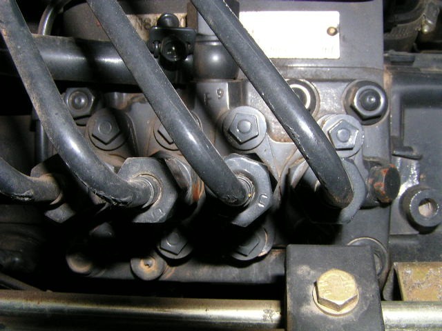

I am about to change the fuel filter on the TC40DA. Can anyone indicate to me which is the bleed screw referred to in the manual. Is it the Phillips head hose clamp or is there a specific bleed screw?
As well when I turn over the tractor and pump fuel trough the lines and air out.......won't the tractor start from the residual fuel in the system?
Thanks for the guidance.

In your picture.. see the "9" in between the fuel lines.. now look above that.. should be a small vertical bolt.. this is the bleeder valve.
When I've run out of fuel.. I've always had to bleed the system.. might be different if you're just changing the fuel filter.

Dave, first to answer your question, although I don't have my manual handy, I'm pretty sure it's the fitting on top of the fitting on the body in your picture, right where the hose attaches.
Now, two other observations. My 40D is almost 5 years old and with many hundereds of hours, and I've yet to change my filter. There is nothing but clean fuel, and of course the filter, /forums/images/graemlins/grin.gif in the bowl. There is such a huge variation in the quality of fuel available today, (based mainly on how it's stored) that any manufacturer suggested replacement schedule is almost worthless. Some folks with a poor fuel supply should probably change it every year or less. But for me, in the 13 years I owned my 1720, I only replaced the filter once, and even then it probably wasn't necessary as there was very, very little accumulation of anything in the bottom of the filter bowl and nothing on the filter.
Lastly, if you decide to do it, follow JInman's recommended procedure. I'm pretty sure that you won't have to blead anything if you do so. With Jim's method, although your rag gets a little fuel on it, it's much better than having to go the bleeder route, as that ends up with fuel running down the side of the engine.
