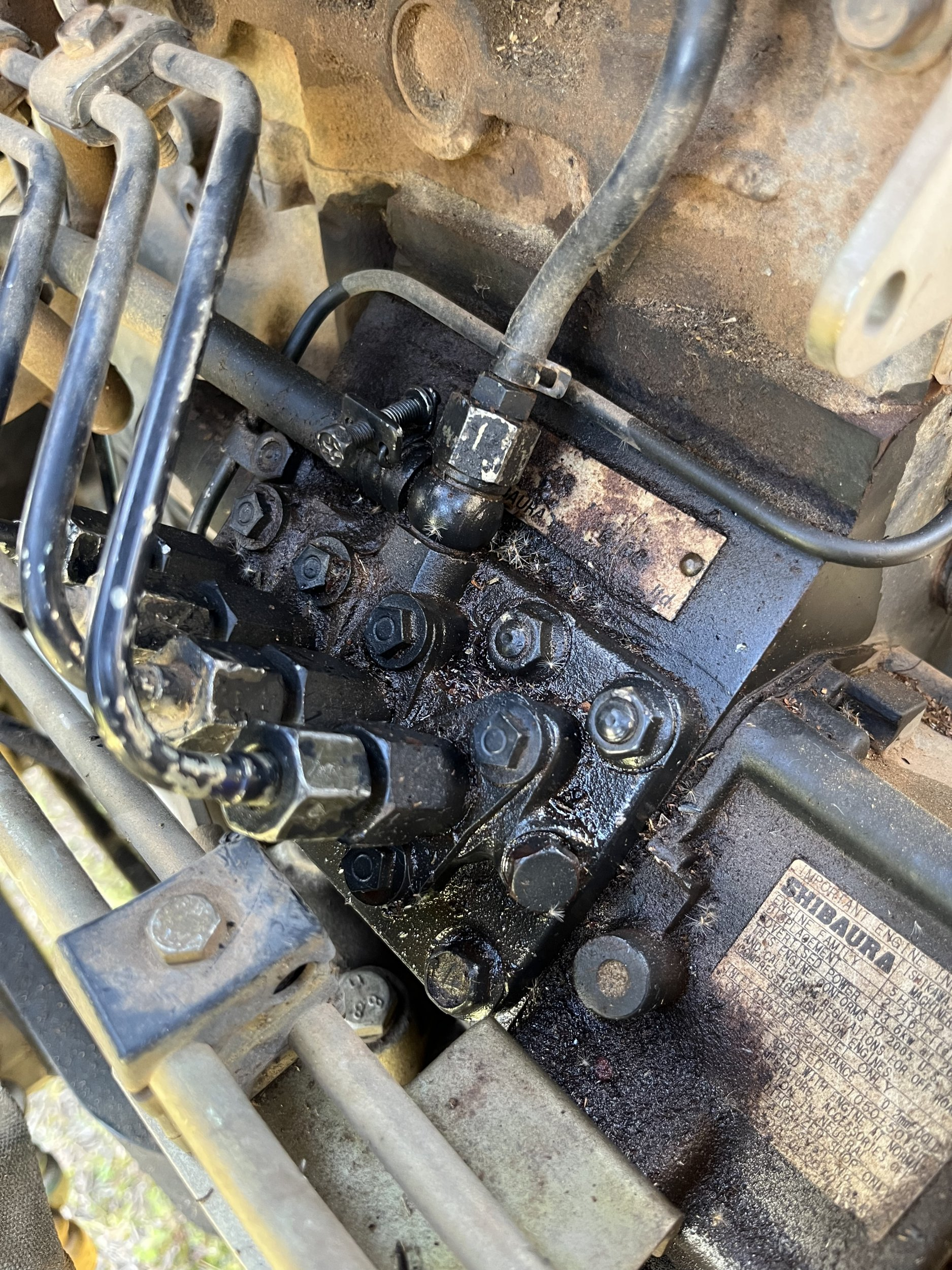

In your picture.. see the "9" in between the fuel lines.. now look above that.. should be a small vertical bolt.. this is the bleeder valve.
When I've run out of fuel.. I've always had to bleed the system.. might be different if you're just changing the fuel filter.
I ran my TC45DA out of fuel (fuel gauge doesn’t work).
I have fuel at the bleed screw mentioned in the post I quote. However, still won’t bleed fuel from injectors.
How do I test the fuel shut off solenoid?
I tried running a wire directly from the battery to the shut off solenoid, but no change.
Note this is the first time it’s given me any trouble starting period.
