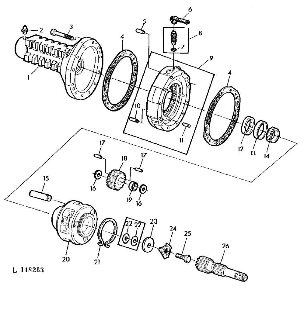

slave cylinder was leaking fluid and I had no pedal, this also supplies fluid to brakes, can't find a place to bleed brakes at rear chunk, any ideas on that?
/ bleeding clutch #5
Brakes are operated from hyd fluid not clutch reservoir that utilizes brake fluid. Brake bleeder valve is parts key #8
