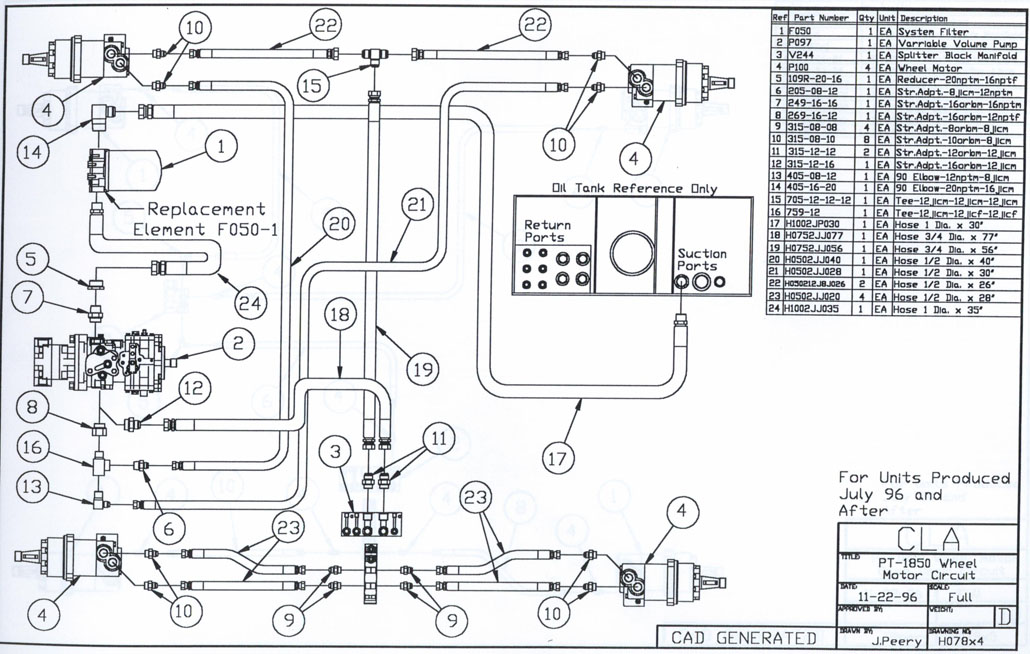

Kent.
Do you have a hydraulic circuit schematic for the 425? Please post one if you have one.

   / Bleeding the closed loop PT drive system #7
J_J said:
Kent.
I think so...take a look at the attached image.
   / Bleeding the closed loop PT drive system #8
Actually, I mis-read your post. Obviously, that image is for my 1845...not the 425.
