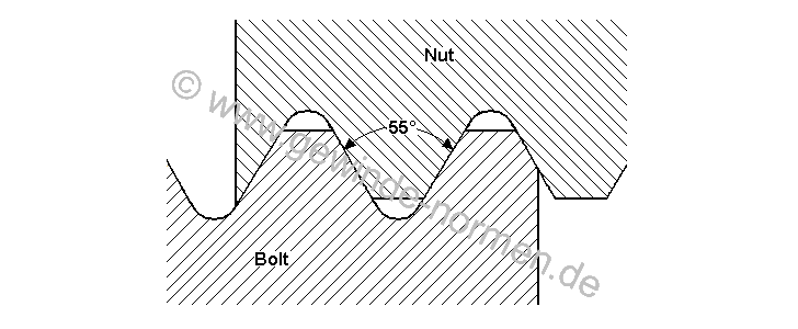

Yes, I believe they are 1/2”
Guess I assumed they were metric since about everything on these tractors are metric because Korean.🤷‍♂️
Yes, correct for the rest of the hardware but in the hydraulic parts, they use BSPP fittings, in this case, 1/2" BSPP. Has a 60 degree taper that seals the connection. It's actually fairly common and cheap everywhere else in the world.
   / Blew a hydraulic hose ☹️
#12
The gentleman from Alaska Rubber called me today and explained that they were an European style (i.e. BSPP) fitting and ended up costing me $30 each. Well, at least it wasn’t as much as the metric ones would have.
   / Blew a hydraulic hose ☹️ #13
I have a McCormick X1.45 which is manufactured by Branson. Hose blew. Had one made locally. Found fittings were “British” metric. Works just fine
   / Blew a hydraulic hose ☹️ #14
Just to clarify the fittings situation a little bit. The fittings are BSPP ( British Standard Pipe Parallel Thread).
This is still an imperial thread, or technically, a British thread as they use a 55 degree thread flank angle instead of the more commonly 60 degree used in Metric and American threads.
So "British metric" doesn't really exist.
