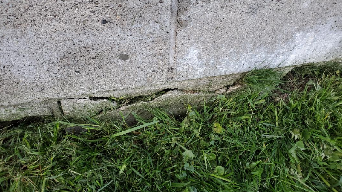

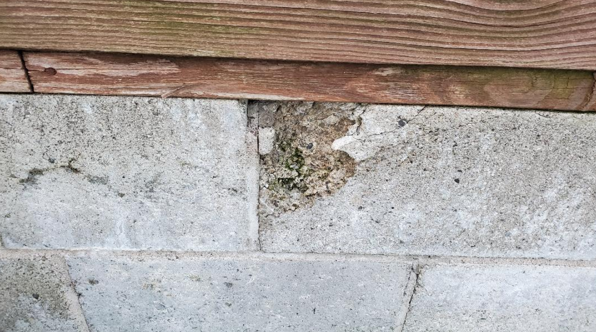

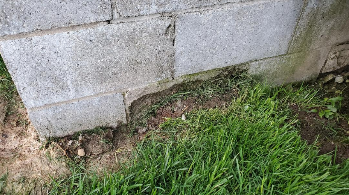

Hey everyone,
I have a block foundation that supports my back deck. It was fine when I
moved in 12 years ago, but it is crumbling in spots.
I what would cause this? How can this be fixed?
Thanks
Dave

   / Block Foundation Help #3
Spalling. Same thing you see on sidewalks. Just age in some cases, but the blocks could have been bad from the start. Moisture encroaches and a chemical reaction starts. Only way I know to fix it is to break out any loose material and fill with new concrete. Then maybe coat with Drylock paint or a foundation coating.
What's on the other side of the block, do you know?
