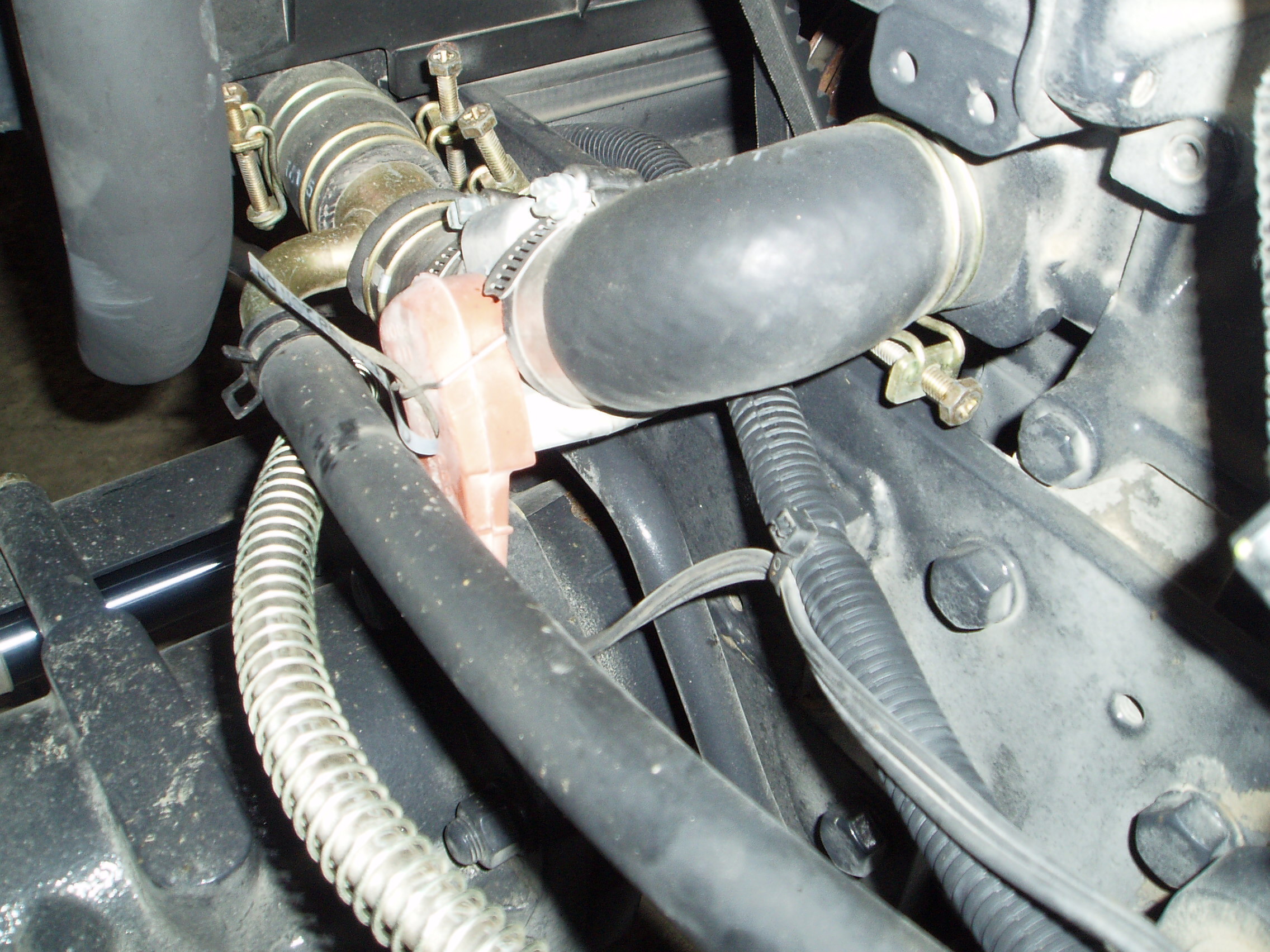

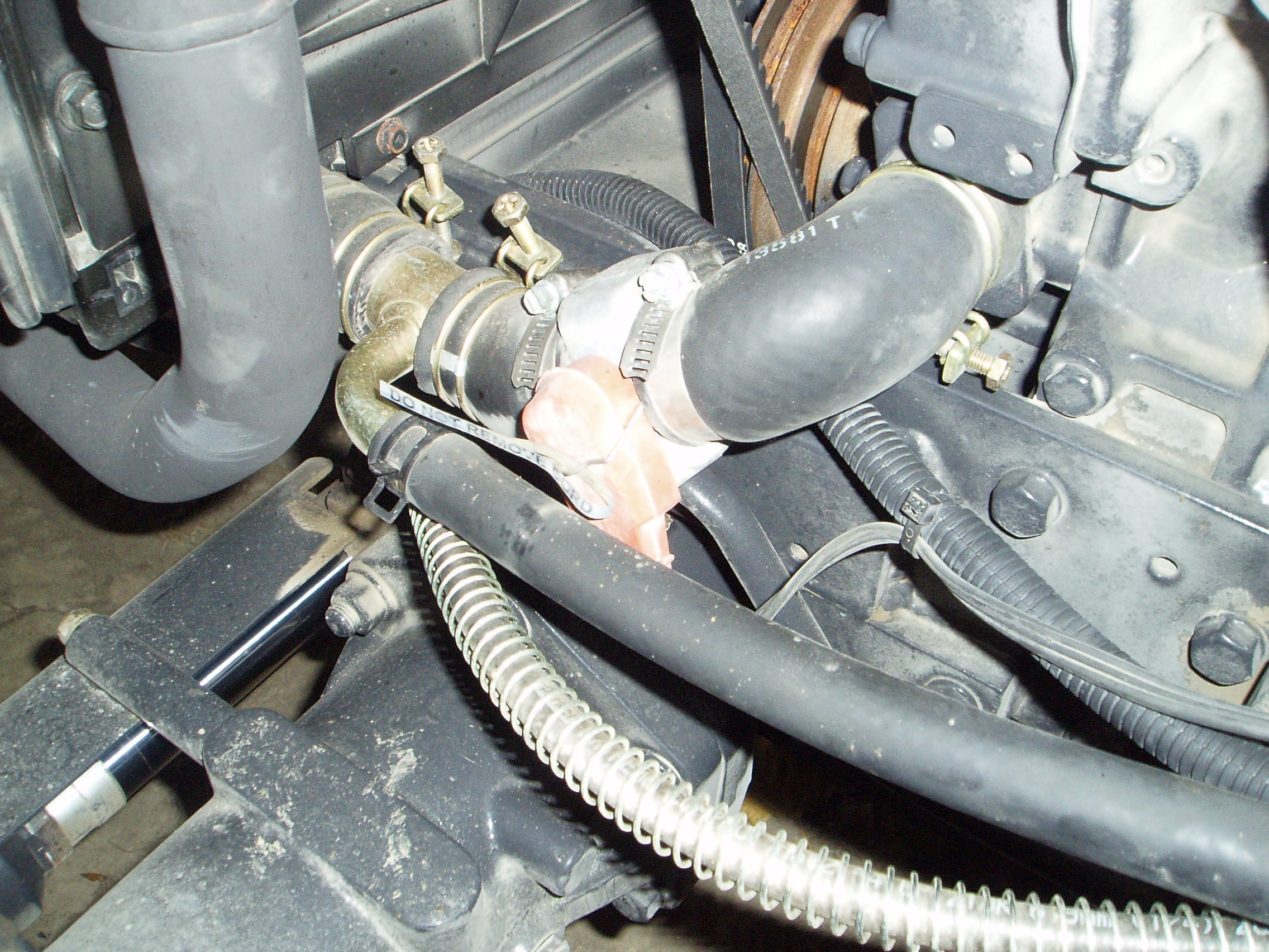

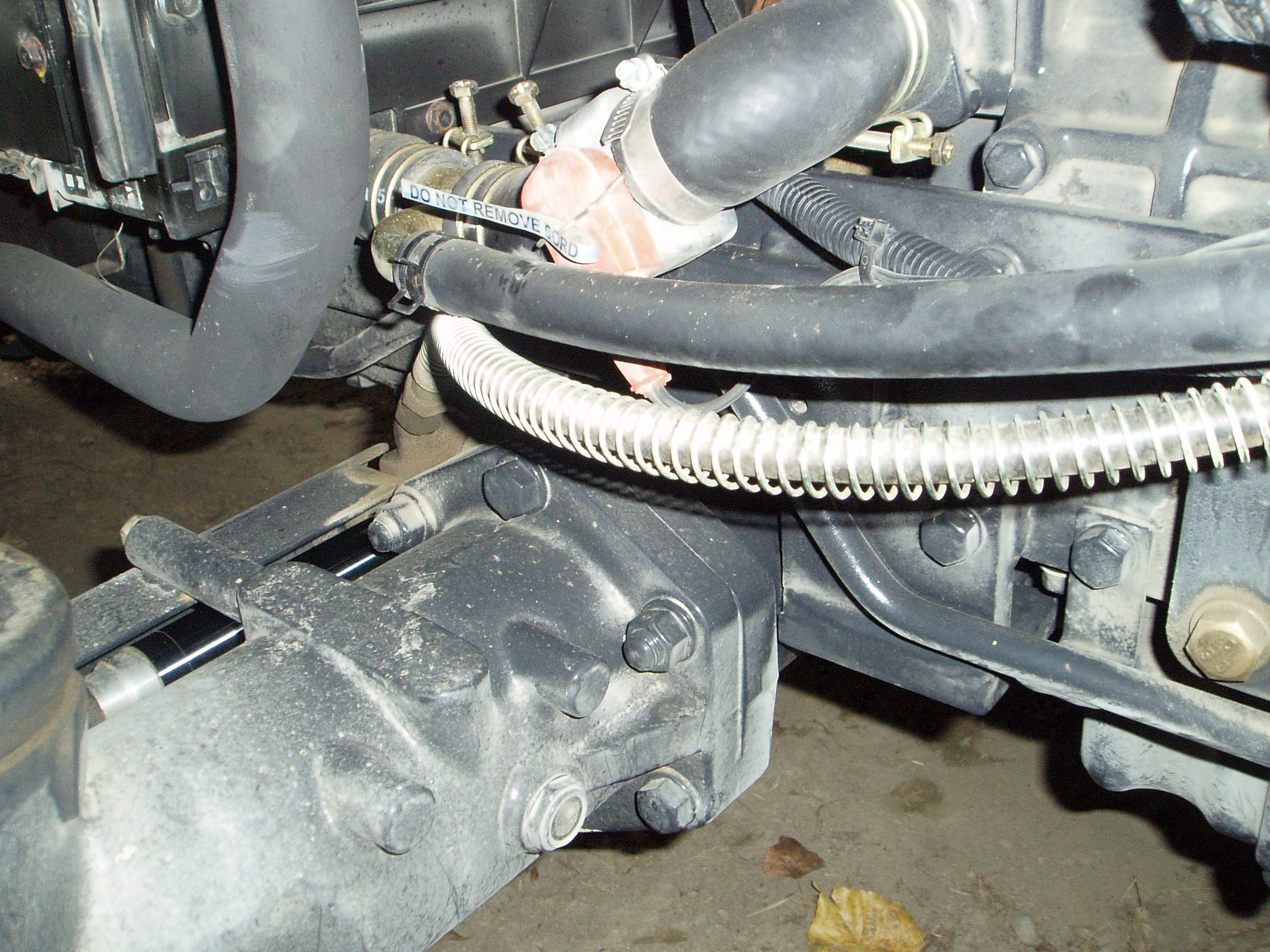

My dealer installs lower rad heaters standard and did so on both my CK30 and DK45 cab. It's a little tight in there, but it fits exactly where you described on the DK.
Can you get a picture of how they installed it so I can compare to the factory layout?

No problem, I'll try and get it for you tomorrow. It's a really busy day, so don't feel bad reminding me tomorrow night if I don't post a pic by then.

Here's what I have.

I see what they did, and it's what I was thinking about too.
The cab heater return line is normally placed (at least on my tractor) where the heater is located on yours. By placing the heater where the return is normally placed they were able to l mount it on an angle. Clearly your tractor had enough slack in the heater hose to move it a couple inches down, hopefully mine has enough slack too.

Well, every tractor they sell has the same set up, I didn't ask to have it installed for either tractor I've bought from them, so I'd assume they all should have enough slack. Good luck.
