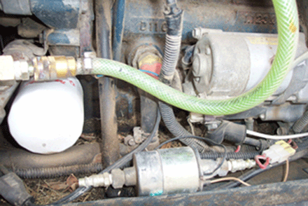

How hard is it to install a engine block heater after the fact?
I think I want something better than a plug-in dip stick.
The diesel engine is very easy to access.
Any suggestions?

   / Block Heater for F2400 #5
My F2400 has a block heater but I haven't had to use it yet. But I keep my tractor in my garage in the winter. Attached is a picture of the block heater on my tractor.
