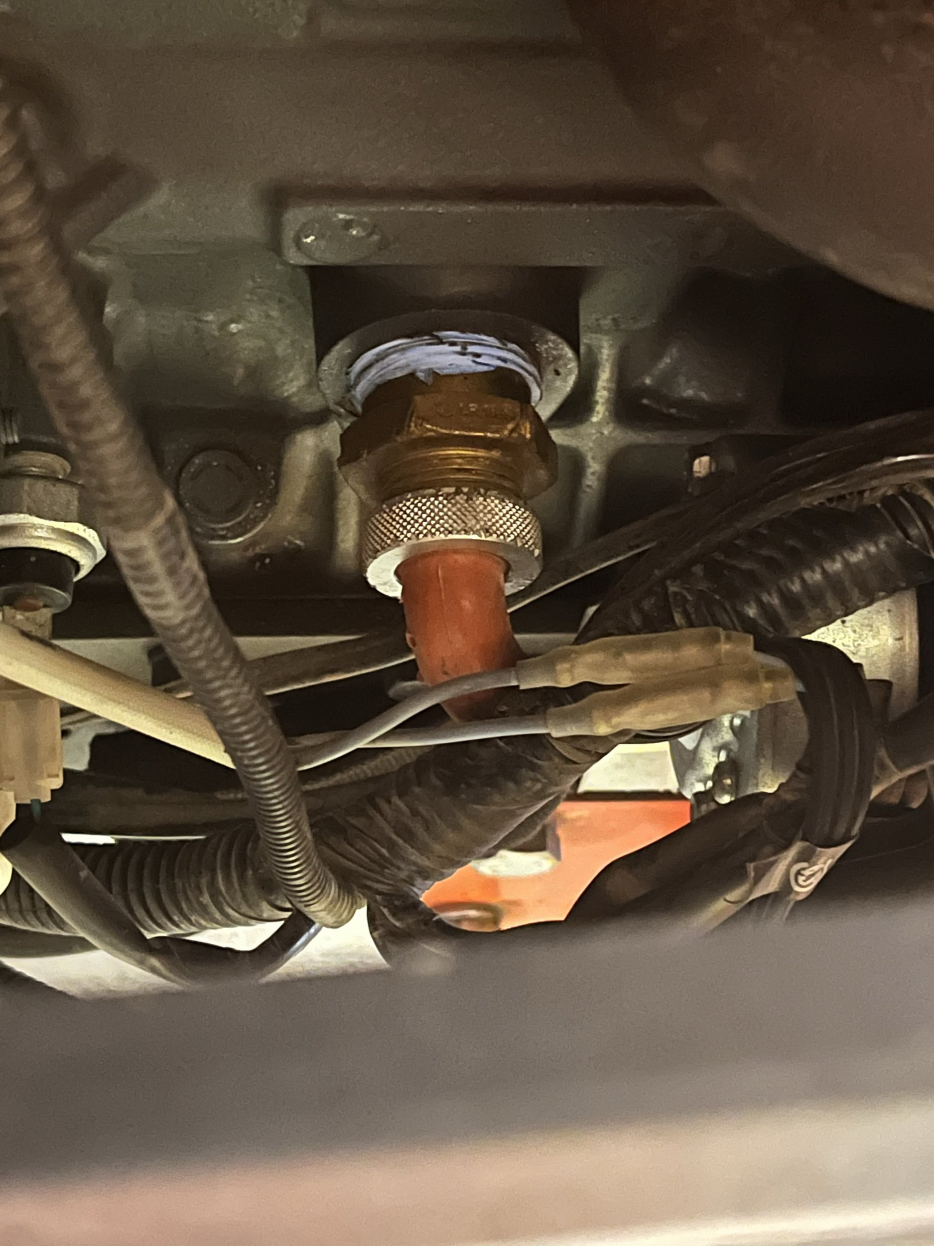

Look for the attached wound up electrical cord, and follow it back, I would assume, to the side of the engine block.
   / Block heater in B2650 #3
I would say if you didn’t specifically ask for one when you bought it (assuming you bought it new)…there won’t be one. Unless the dealer puts one on as a perk…
At any rate, they are located on the left side of the engine (as you are sitting on it) threaded into the engine block between the oil filter and the starter….it’s a copper housing with a red plug coming out if it…
Here is mine:
   / Block heater in B2650 #4
Our B2650 heater on left hand side with cord hanging.
   / Block heater in B2650 #5
Same as mine, coiled up alongside the frame. It should be the only house style plug on your tractor.

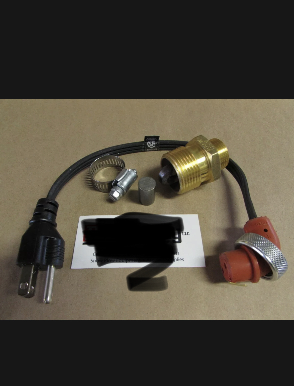

   / Block heater in B2650 #7
The cord coming out of the heater is really short, so it should be pretty close…
Here is the kit:

There are many different sizes of block heaters. The space for the heating element depends on how much internal space there is from the threads on the engine block to the cylinder walls inside the motor. You could probably find one at the auto dealer if you knew all the measurements and wanted to spend some time and maybe do a little gambling on the fit.
Otherwise get it from the tractor dealer. Messicks probably sells them if you want to do it yourself.
