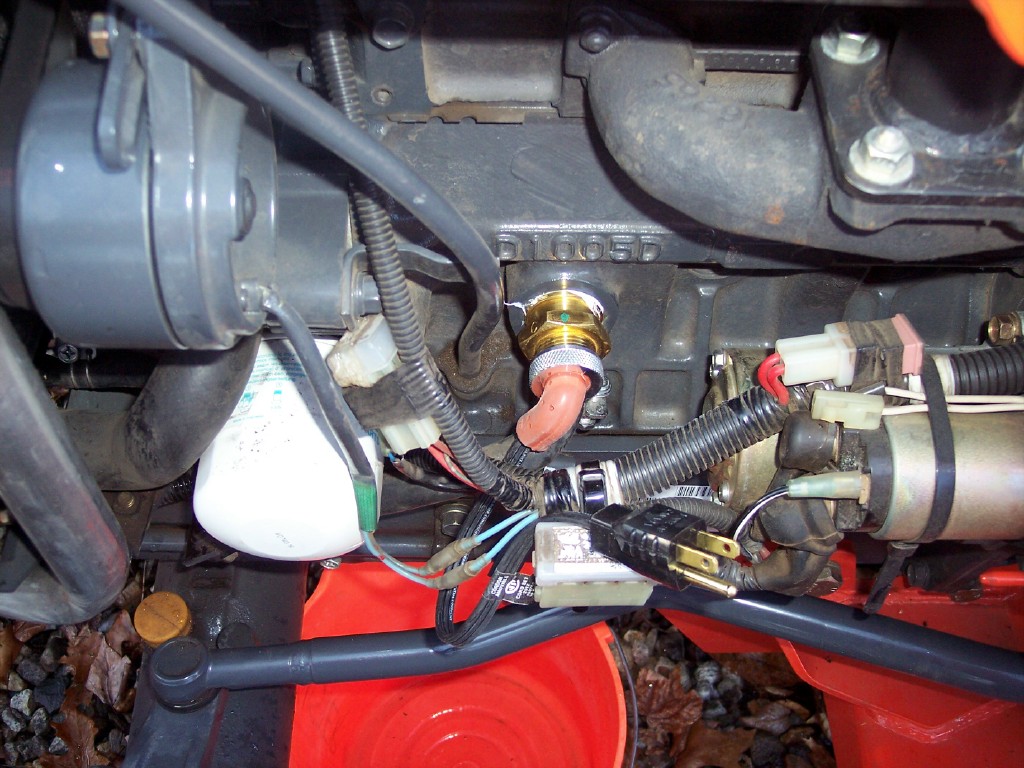

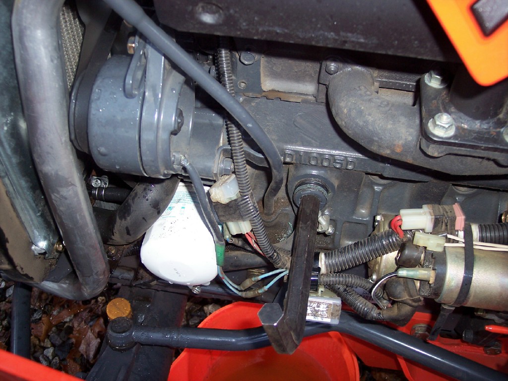

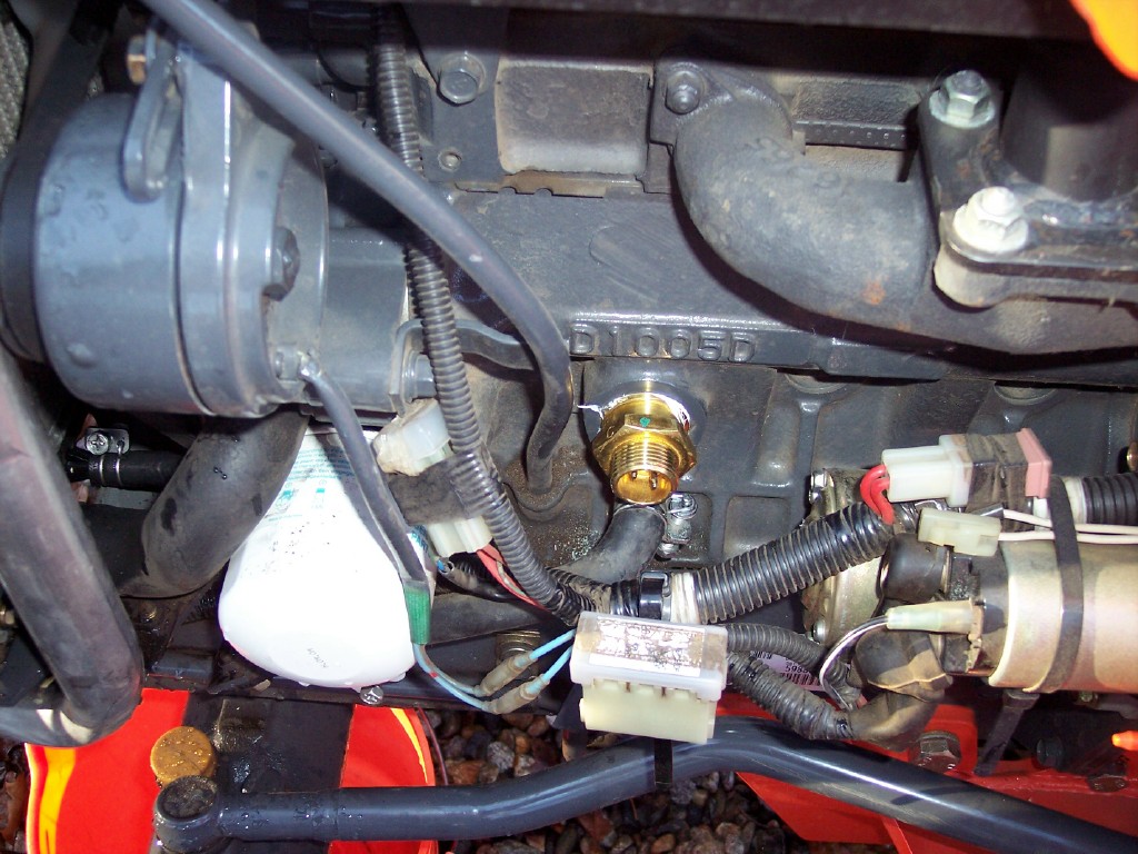

You most likely don't need a block heater on a newer diesel tractor. I installed one on my Kubota (2006) and it was a simple task. It heats the engine quick and therefore I would not recommend leaving it plugged in because it would be a waste of electricty. I used mine once since I installed it and that was only because it was there to use. I plug it in for an hour and the engine is plenty warm. A warm engine is easier to start than a cold one, but my cold Kubota starts just fine during the winter. We generally range about 15-20 degrees in the winter here in CT. So do you need one, probably not. Will it help your tractor start easier in the winter, yes.
