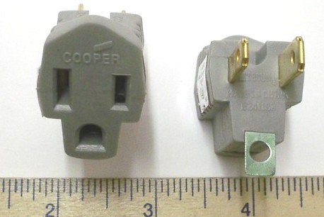

So I've had my block heated installed for about a year+/- and for the last month it keeps tripping the ground on the receptacle (tried several). I've tried pushing the cord in more to make sure it was in all the way, clean the ends on cord and tractor side. Still no luck. My only option I can think of is by a new one?
Any ideas?

Is it a GFCI tripping? If so then you can check to see if the block heater has an issue with a multimeter. A typical block heater will draw 2 to 5 amps yet it only takes about 5 milliamps (.005 amps) of current leaking to ground to trip a GFCI. With a multimeter you can measure the resistance between both the "hot" and "neutral" connector on the plug to the ground connector. It should read an open circuit. If it doesn't then it's causing the GFCI to trip. You may find your only solution will be to plug the heater into a non-GFCI circuit. You could try to use an adapter that allows you to plug a cord with a ground connector into a two pronged receptacle.

It very well could be a slight difference in the way the heater was made. Or just pure luck that your truck doesn't trip but your tractor does. Since the currents needed to trip a GFCI are so low even the slightest leakage to ground will trip them. I've never taken one a part but I would assume that they are nothing more than an internal wire (like Nichrome) wrapped in insulation that has a steel jacket around it. Each mfg will have their own standard as to is acceptable as far as leakage through the insulation. Ideally it would be nothing but rarely in the real world does ideal happen. My guess would be that after using it a few times the heating/ cooling cycles has had an effect on the insulation. I would make sure to clean anything that looks like it could have even the slightest bit of water, dirt, or anything else of the connectors.
If it was me I think I would make an adapter that ties the ground wire from the heater to the neutral wire and not use the GFCI ground and not use the GFCI ground. If you use one of these adapters and the heating element really fails you could run into a safety issue. Since your tractor has rubber tires there shouldn't be any other paths to ground. There is the potential that the heater element's hot wire shorts to ground in which case the metal on your tractor would be 120v. The ground wire is designed to trip the breaker to prevent this from happening. With those adapters below you are required to connect the tab or pigtail to ground yet doing so will trip your GFCI. If you don't connect them to ground (as most people do) then you've broken the ground path.
