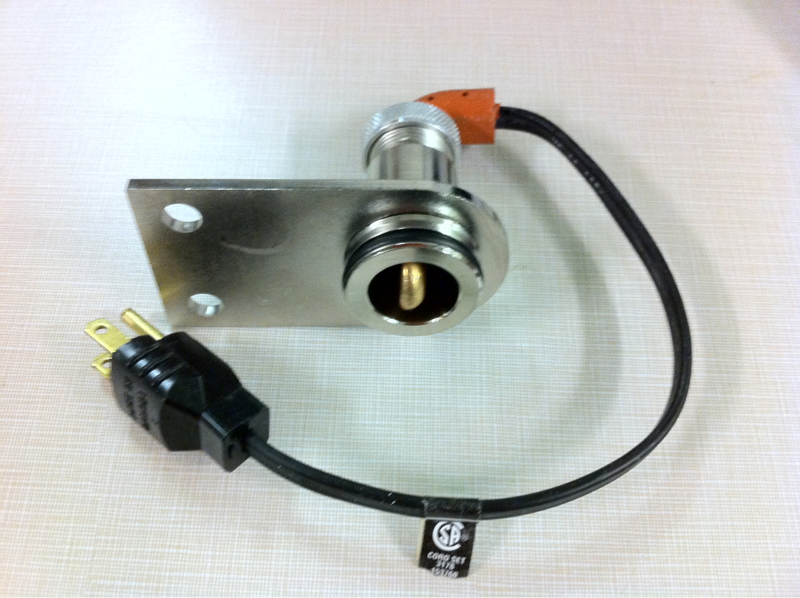

OEM is probably the best option. As the old saying goes...buy once, cry once.
It's worth the money.

Hello,
Just bought a used 2018 1715:). I will need a block heater before Winter (Northern Ontario). Are there any aftermarket available that will fit the frost plug or do I have to buy OEM?
Sent Zero start/Temro an e-mail with engine model # & link to You Tube installation video. Nice lady said they don't make a block heater for that engine. I suggested that she should forward information to design dept as this is a very popular engine.
I'm sure there's one out there that would fit but doesn't cross reference.
Thanks.
Is it not possible to use a "tank heater"?
They are cheap.
Unless you are, or know a machinist, OEM is the only option for a GC block heater.
I say that, because someone on here once made an adapter, to allow a widely available aftermarket heater fit.
Everything that is out there aftermarket in the right size, is too long to use on a GC.
The heating element can not extend out of the housing, and into the block at all. The cylinder sleeve is right inside.
And, because it's a subcompact, there isn't sufficient space to put an inline hose heater.

Do you want a high powered heater to warm stone cold engine to starting temperature in 20 minutes ? Or a low powered heater to maintain starting temperatures when plugged in 24/7

I bought the OEM heater, and yes, it was a lot more expensive than other options... on the other hand, it works quite well, installed easily, and doesn't leak. Still going strong after 9 or 10 years. It's also convenient that the cord can be removed and replaced with a garden hose cap in the summer- - keeps the junk out of there and saves the power cord from damage.
One other cheap fix you could try is to lay a 100-watt (or so) incandescent bulb under the hood, then cover the hood -- the whole engine compartment-- with an old blanket. Somewhat inconvenient, but that also works.
I use the heater any time the temp's below 20; I figure it just makes for a lot less wear & tear on everything when starting the engine. (But don't forget to allow the hydraulic oil to warm up sufficiently before heavy operation!)

apps - JMHO but you are going the wrong way with a block heater. I've had block heaters and lower radiator hose tank heaters. The tank heaters are much more efficient and if everything goes **** up - all you need to fix the situation is a new lower radiator hose. If your tank heater starts leaking - good luck.
A tank heater is the only efficient method if you need quick warm up or are in some really cold weather. Besides a tank heater is not OEM and does not cost $100 plus.
