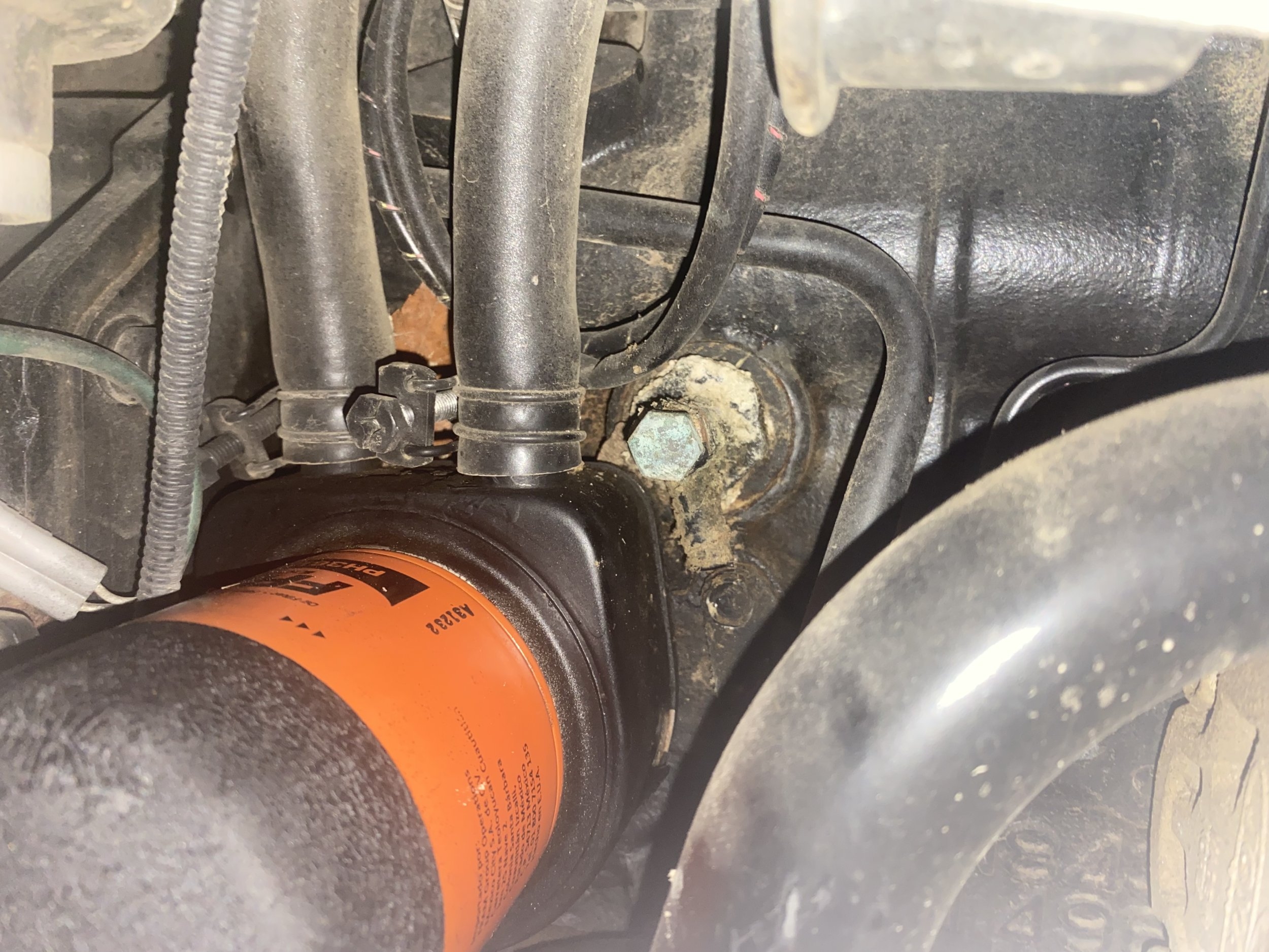

So I was wondering where to get a block heater for my XR3037? This is what I have on it now? Never seen one like this before.

That looks like a coolant drain for the block.
/ Block heater #4
Where to get one? I'd try your LS dealer, if you value your time more than a few extra dollars, as they'll have one already configured for your machine. If you want to go the DIY rate, look for something around 400 watts with a plug diameter matching that of the most conveniently-accessible freeze plug on your block, and a cord of suitable length to dangle out from under the hood shroud.

Easy way is to use a magnetic heater. The block heaters go into the freeze plug holes..... so you have to remove the coolant, then remove a freeze plug, install the heater.
The heater has to be sized to your specific size of freeze plug.
Much easier to put on an external pan heater.
As winterdeere stated, an LS dealer can get you a specific block heater for your tractor.
/ Block heater #6
Yeah, easier on initial install. But installing a regular block heater is a pretty quick project for most, and it's forever there and out of the way, zero maintenance.
I think I did my last one in about 30 minutes, the longest task of which was washing a 5 gallon bucket clean enough to use for the coolant retrieval/re-use. The freeze plugs knock out quick and easy with a drift and a hammer, then channel-locks to pull it free.
Note, if trying this, do NOT drill a freeze plug. There's likely a cylinder wall just 1/8" behind some of them, and you don't want to be drilling into that. A drift near one edge will cock it sideways, then channel locks pull it out.
/ Block heater #7
When looking for a location for a block heater observe and figure out were the cylinders and pistons are and do not try to install a heater were the block and the cylinders are the closest.
With that oil cooler were it is you could use one of the tank type heater they work very well.
This style has a pump and will heat an engine up quickly;
this style is supposed to circulate from hot water pulsing out of the heater, they do work but not near as good as the pump style.
I have had little success with the magnetic heaters and it's been hit or miss with the lower radiator hose heaters.

My dealer installed a Lower Radiator Hose heater. Works well.

I just received my block heater and was wondering which engine knock out it should go in. Left side or right side of the engine. Thanks
/ Block heater #11
Not critical, but use these three factors in choosing the freeze plug to knock out:
1. You don't want to choose one that is directly atop a cylinder wall, as there won't be sufficient cavity volume to fit the heater element. Try to choose a freeze plug that's well-centered between two cylinders.
2. Left vs. right, consider where you park your tractor, and access to the cord. If you park the machine with the left side hard up against a wall, you probably don't want your heater there.
3. Look at the potential routing of the pigtail cord, and where you can safely zip-tie it and the plug. You want it easily accessible, but out of harm's way.
Oh, I gues there's one more:
4. Make sure all of your freeze plugs are actually the same diameter, as I've seen engines where they have an odd size or two. Obviously you need to choose one that matches your heater.
