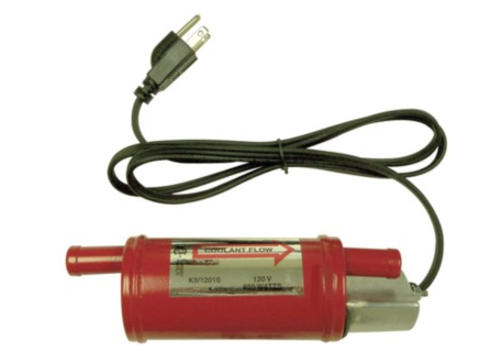

35 plus yrs as a mechanic - seen a ton of "heater" failures, the largest cause of failure was corrosion because of poor anti-freeze mixture ratio - that said, the inline circulating coolant heater were worse. As for usage, you only ever see a fail (as a user) while it is in use. It may seem to be a waste of coolant and effort but if you add maintenance of it to your annual maintenance schedule, you will always have a visual confirmation of whether or not it works right - take it out, inspect, replace accordingly - even test it in a bucket of water. Next on usage, you gain nothing by operating it any more than 60 mins (-30 C temps). If you really want to have aid for cold weather starting, get a battery warmer or better yet, trickle charger - you will be surprised in the performance gained from the bit of warmth!!
