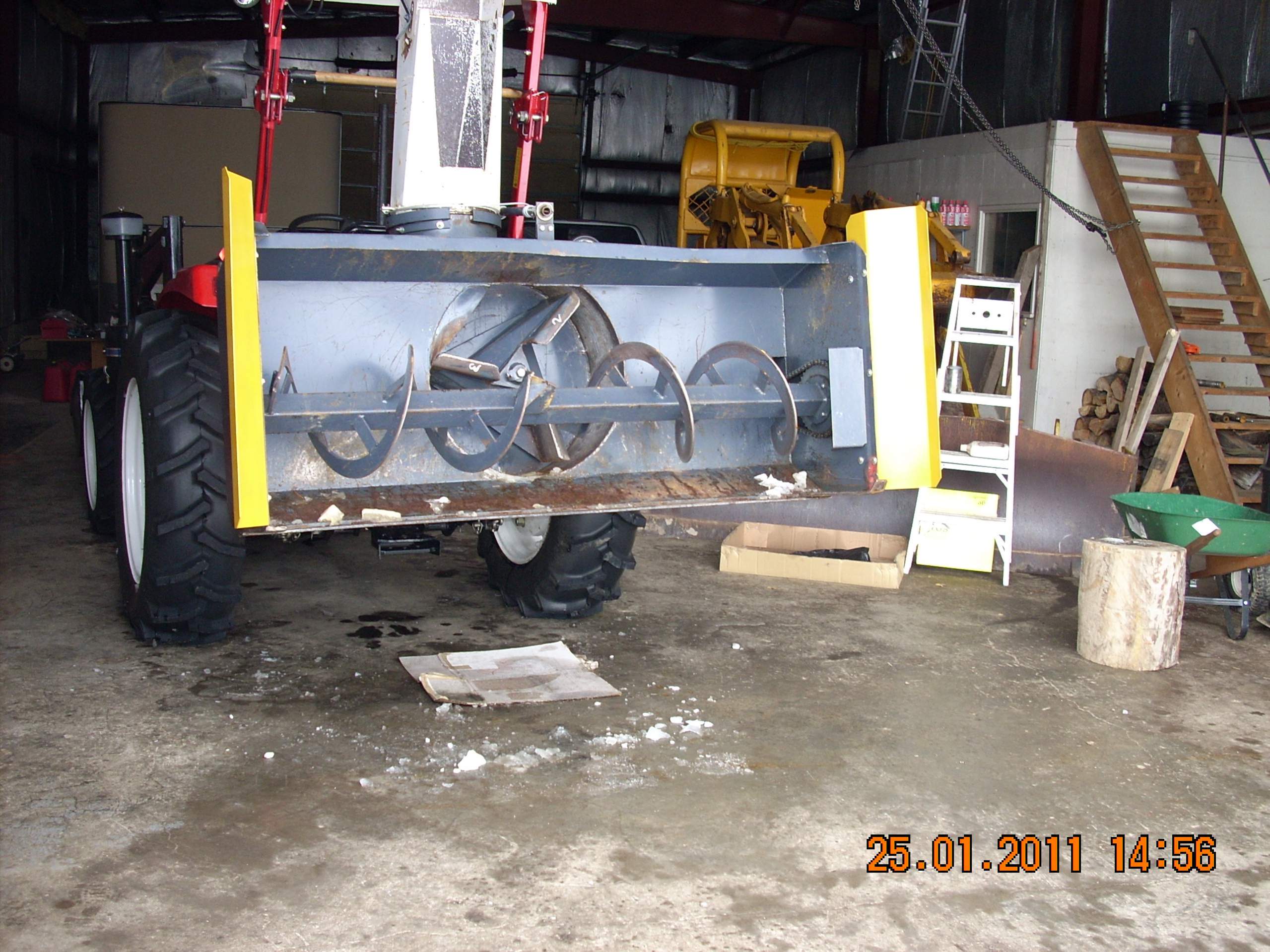

Thought I would add my comments regarding wings added to a snow blower. I added two wings to my blower giving me an extra 9" clearing width. A big improvement on the original 73" size - I really need an 84" blower. Well worth mod in my opinion as it makes the blower more efficient IMHO.
HTH - though you need at least the width of the rear wheels or slightly more, for efficient snow removal.

   / Blower or plow. Which is best? #75
Nice!
   / Blower or plow. Which is best? #76
Does it help because it acts like a plow kinda and keeps it fed??
   / Blower or plow. Which is best? #77
Doxford, adding to Farmboy's question, I have a 62" blower and I feel any snow event under 5" is to little snow to blow efficiently. Not enough volume of snow coming into the blower to really throw it. I plow these storms with the garden tractor and blow back the banks next time the blower is required. So by adding 9" to my blower width do you feel that I would be able to possibly blow a 4" snow fall efficiently? How did the extra with effect the performance of the blower.

The wings help a lot and feed extra snow to the auger, making it work better (more efficient).
I don't bother to use the snow blower until there is at least 8" or so as it is a waste of fuel. Blower works best with a good 12" or more of snow to go through. Unfortunately, the snow drifts quite a bit on my slightly hilly and winding drive, so any snow clearing is a compromise at best. I much prefer the blower over the rear blade as the snow gets thrown away out of the way.
