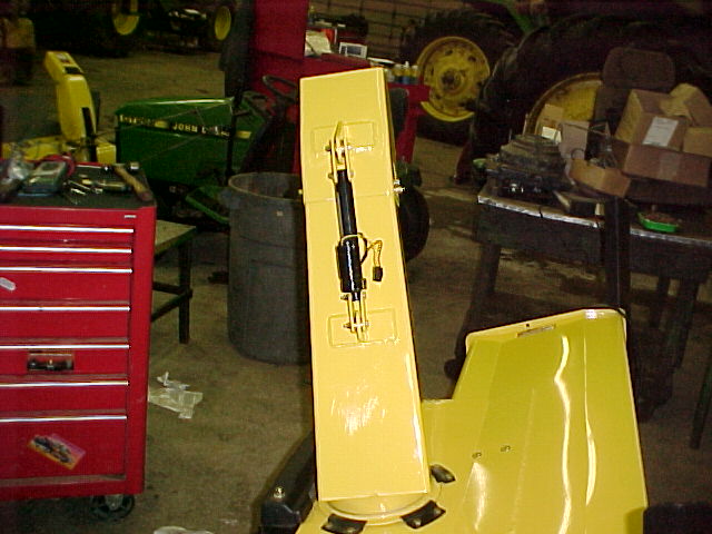

Any chance of a similar REMOTE SPOUT CONTROL KIT for a 59" snowblower (4200,4300,4400 & 790 CUTs). I took a look thru JD parts and couldn't find one... tkx
   / Blower taking biggg bite. #12
There are some slick electric actuators that can be used on the 59 fairly easily! Here are some pics from one we
installed on a 59 for the next village over, they use it on
their 4310...
/forums/images/graemlins/cool.gif

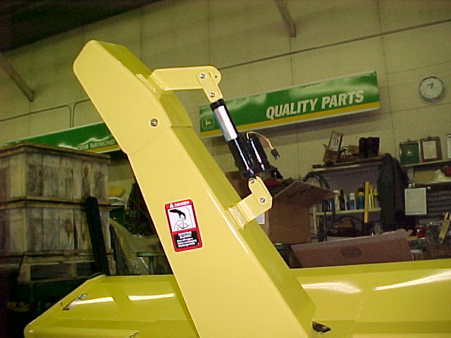

   / Blower taking biggg bite. #13
pic 2

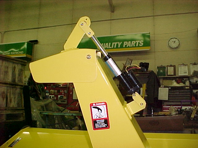

   / Blower taking biggg bite. #14
pic 3

Very slick! Thanks for the great pix. I'll do a search for the electric actuator. Please let me know if you have a good source. Tkx
   / Blower taking biggg bite. #16
Here are the notes we kept in the file..
"PURCHASED FROM MIDWAY INDUSTRIAL SUPPLY, DANAHER MOTION
PART #930744802. 4" STROKE, 12V, 75LB LOAD, ELECTRAK1"
I don't remember pricing, sorry
   / Blower taking biggg bite. #17
Nice Job Dutch. Very nice looking, clean, functional and simple modification. I give it an A+++.....BUT... I need to send you to the principals office for bringing too many toys to school /forums/images/graemlins/mad.gif and makeing everybody else jealous......... /forums/images/graemlins/cool.gifMike
Something like that could be used on lots of things. Thanks for sharing.
