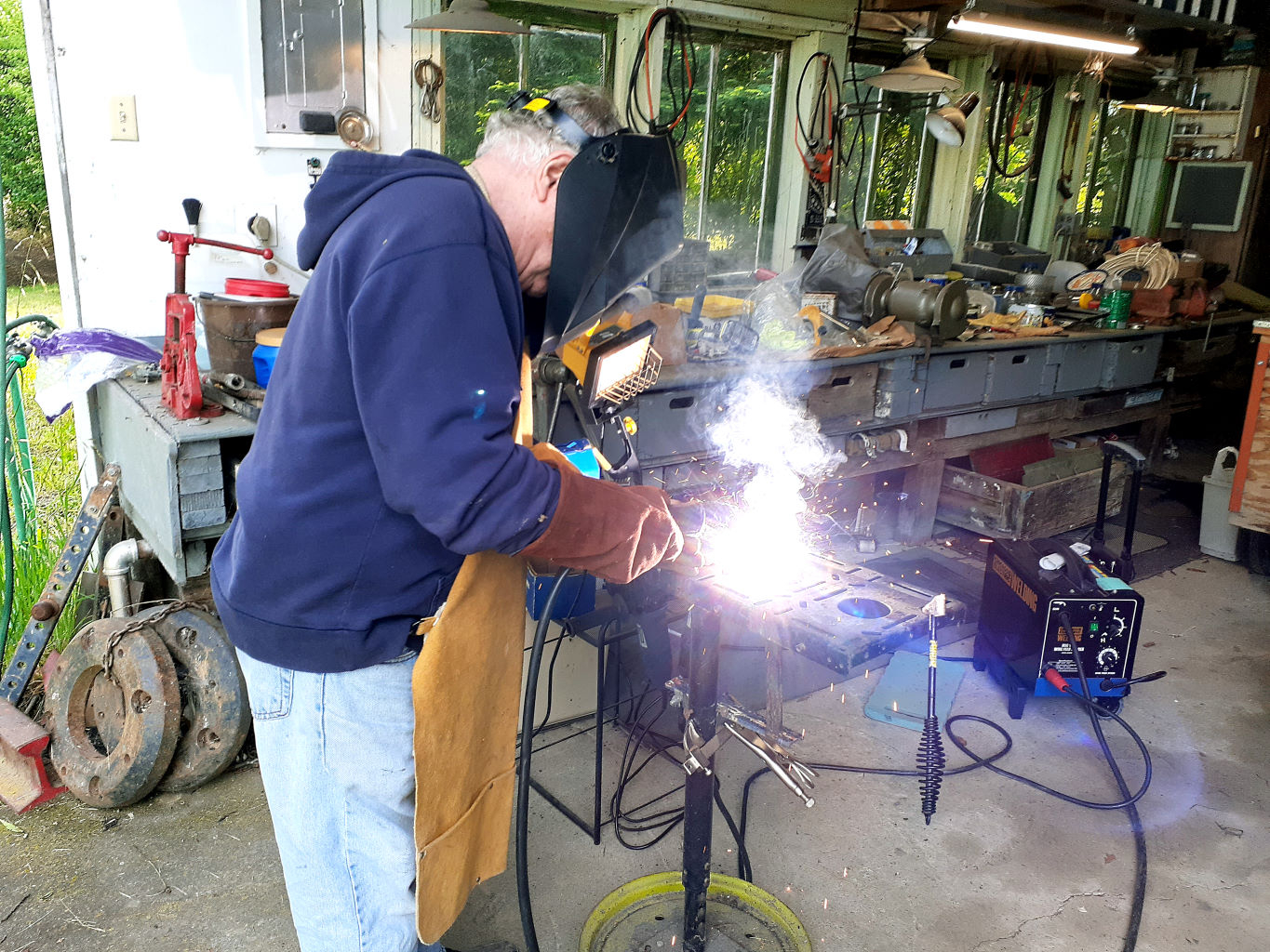

I doubt I'll ever go to gas. Where I can, I like to keep things simple. Gas would add cost, transport, storage space. Welds would be prettier but not likely stronger, which is my only objective.
My shop is open-air so gas might not be much of an improvement.
Cleanup of flux splatter with wire wheel or flap disc, maybe even grinding, is sufficient for what I do. My present project is modify an old back blade so the q-hitch can pick it up. Nobody will care about evidence showing that that splatter was removed.

I think this Blue Demon wire stalls because it really is snarled up on the spool, as I saw in some Amazon reviews. That's why I'm thinking about spooling some wire off to see if it will feed better from the other spool.
... And that really was the problem. The Amazon reviews said some spools of Blue Demon won't feed smoothly. This is what I experienced. I had heard the feed motor slow and stall, frequently, where I had to pull the wire out of the tip with pliers.
I cut the wire near the spool, mounted an empty spool on my drill, and tried to pull wire onto the external spool. There were several moments with so much resistance that I nearly dropped the drill. I could see 'elbows' in the wire as it fed toward the second spool, and saw one crushed spot that never would have gone through the welder tip.
I'm pretty sure I never let the wire 'rats nest' mounting it originally or during this spooling.
At 5030's suggestion I replaced the Blue Demon flux wire with INE. Problem solved. The wire feed motor now runs at a smooth hum in contrast to the uneven speed before. And the weld bead is continuous. Problem solved.
