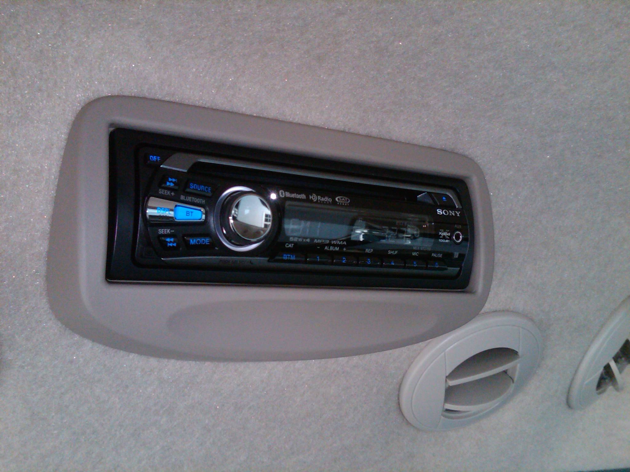

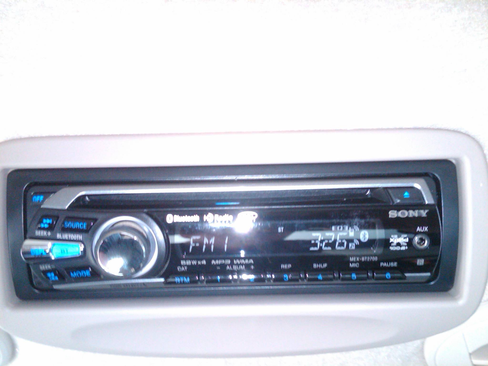

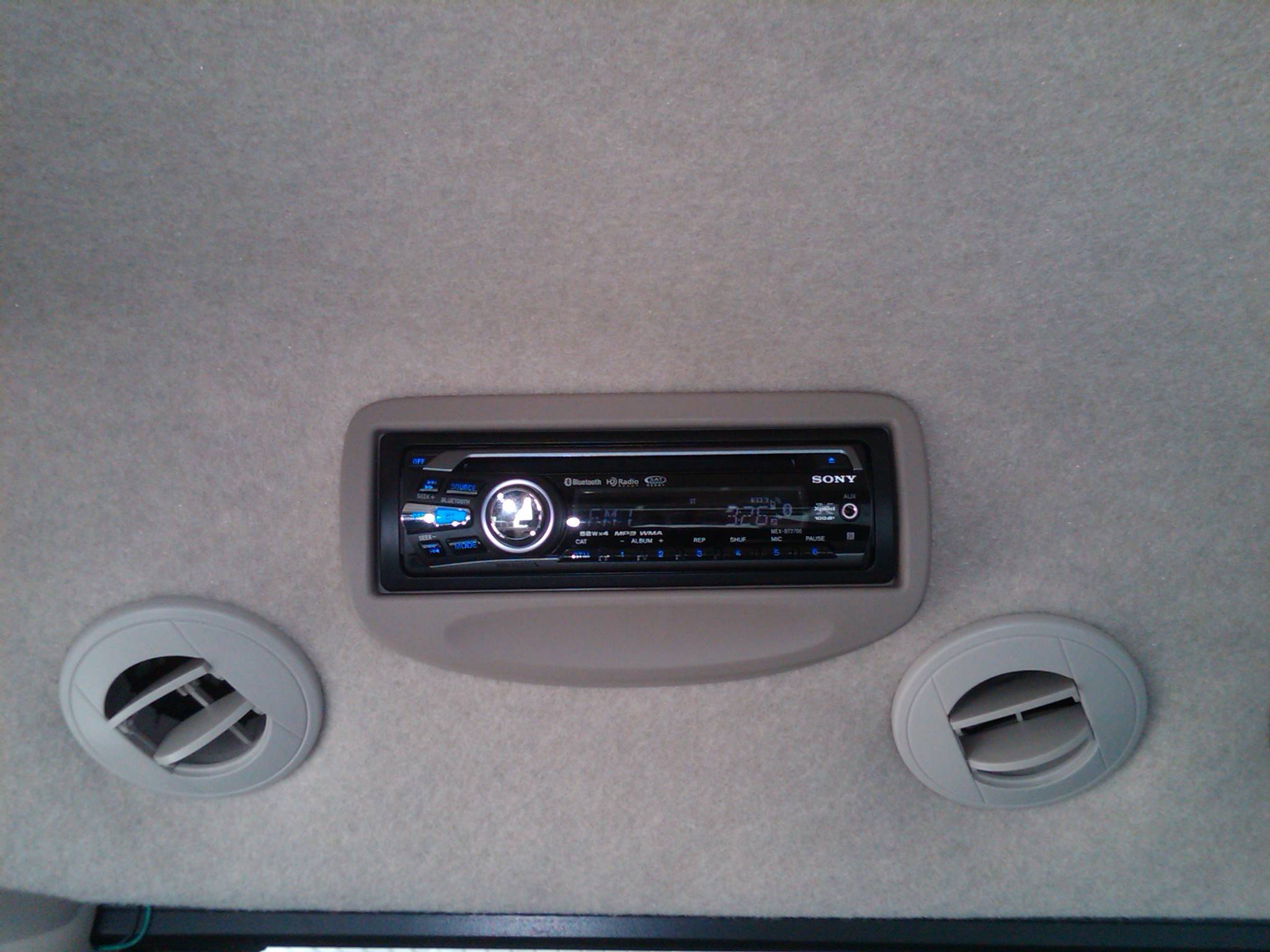

I just finished installing a Sony MEX BT2700 CD/Radio Stereo in my new 3520 cab. 159.00 for the radio and 19.00 for the VW01B adaptor plug. Everything works great (as advertised). The only negative comment is the sound from the JD factory speakers is average quality. The bluetooth feature in the radio allows streaming of music from my BlackBerry Storm. I can also send and receive cell phone calls with ease through the radio. Remote control is handy. I really enjoyed this small project. It took me about 4 hours because I had to remove the cab roof to access the radio mount. Technology is great!!!!!!!! I have attached a few pics for those interested.

Was it a big deal to remove the roof? I have never done it so I do not want to get 1/2 way there and decide I shouldn't have. I am wanting replace the dealer installed radio and speakers.
It wasn't hard at all. Remove the rear cab filter, the two rear lights (four bolts), and then the thirteen bolts from the roof (around outside edge). I did this by myself but I only slid the roof top over far enough to access the radio mount and wiring harness. I did most of the work from a six foot ladder. I would recommend, for installing speakers, that you remove the cab roof completely. This will require another person to help you. Also, pay particular attention not to damage the foam cab seals. This could cause trouble with heating and cooling. Hope this information helps.
