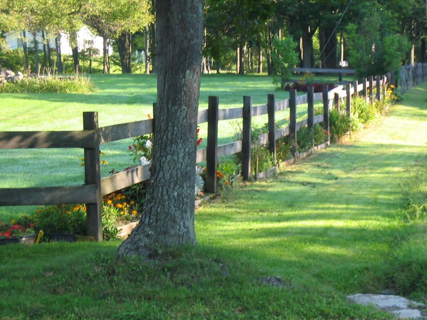

I used PT some 20 years ago. I leave the post higher than the top board for driving the post back down from frost heave, when needed. I also used those purty aluminum post caps. I would leave enough room under the bottom broad for a push mower to fit easily. My wife made the lookout guy.

Gizmo that's the type I'm looking to build when I get the funds.
Jaron2, I know a heck of a sawmill man, he cut all my boards for the Iron Hill Shed project, and there are also two mills in the 15 mile range of my house that could sell me some too now that I'm thinking and on the right track of board types.
