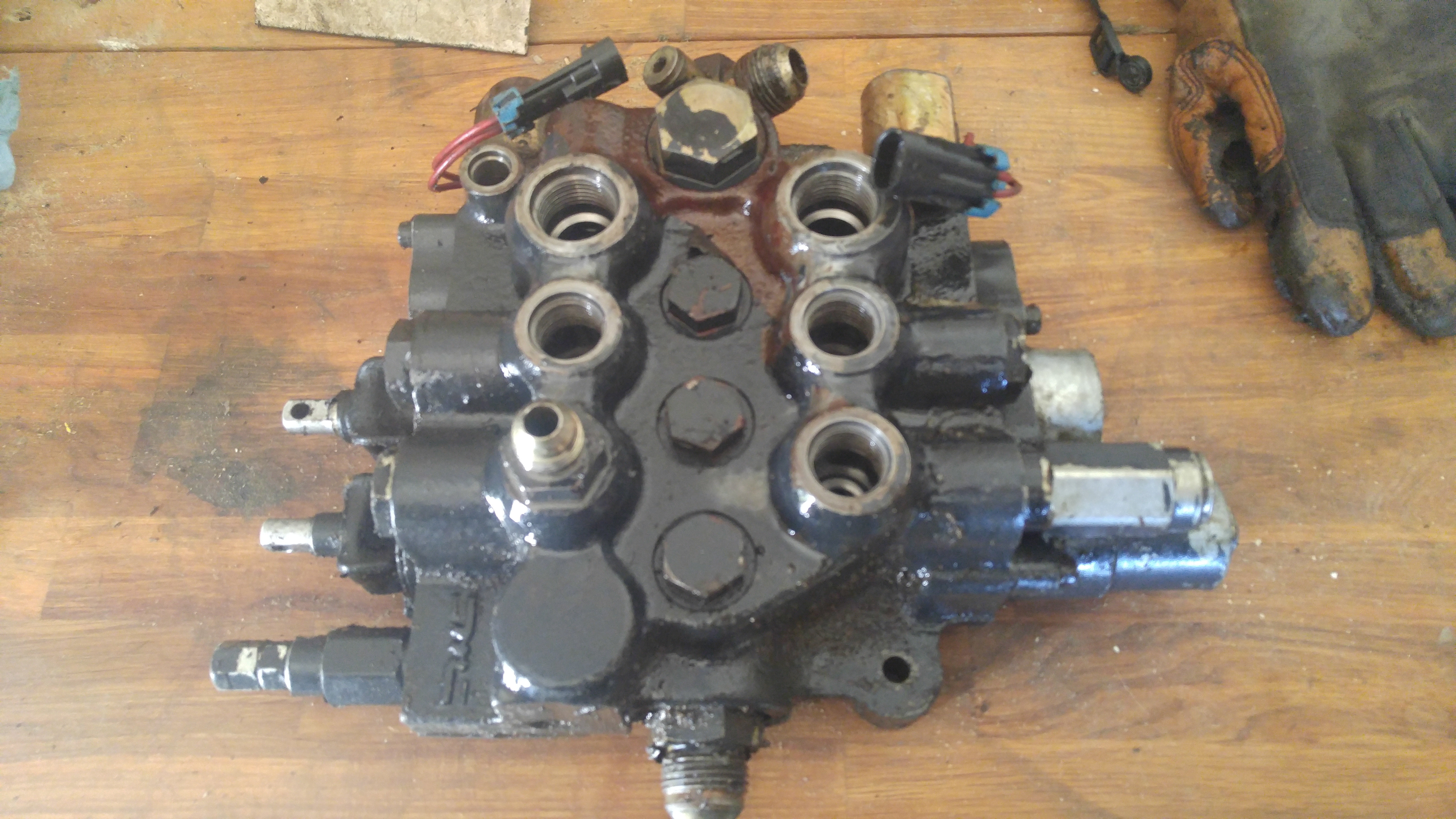

Ah.. Of course the one Hex head I should have checked when the control valve assembly was on the work bench. I'll swap them tomorrow. Thanks again!

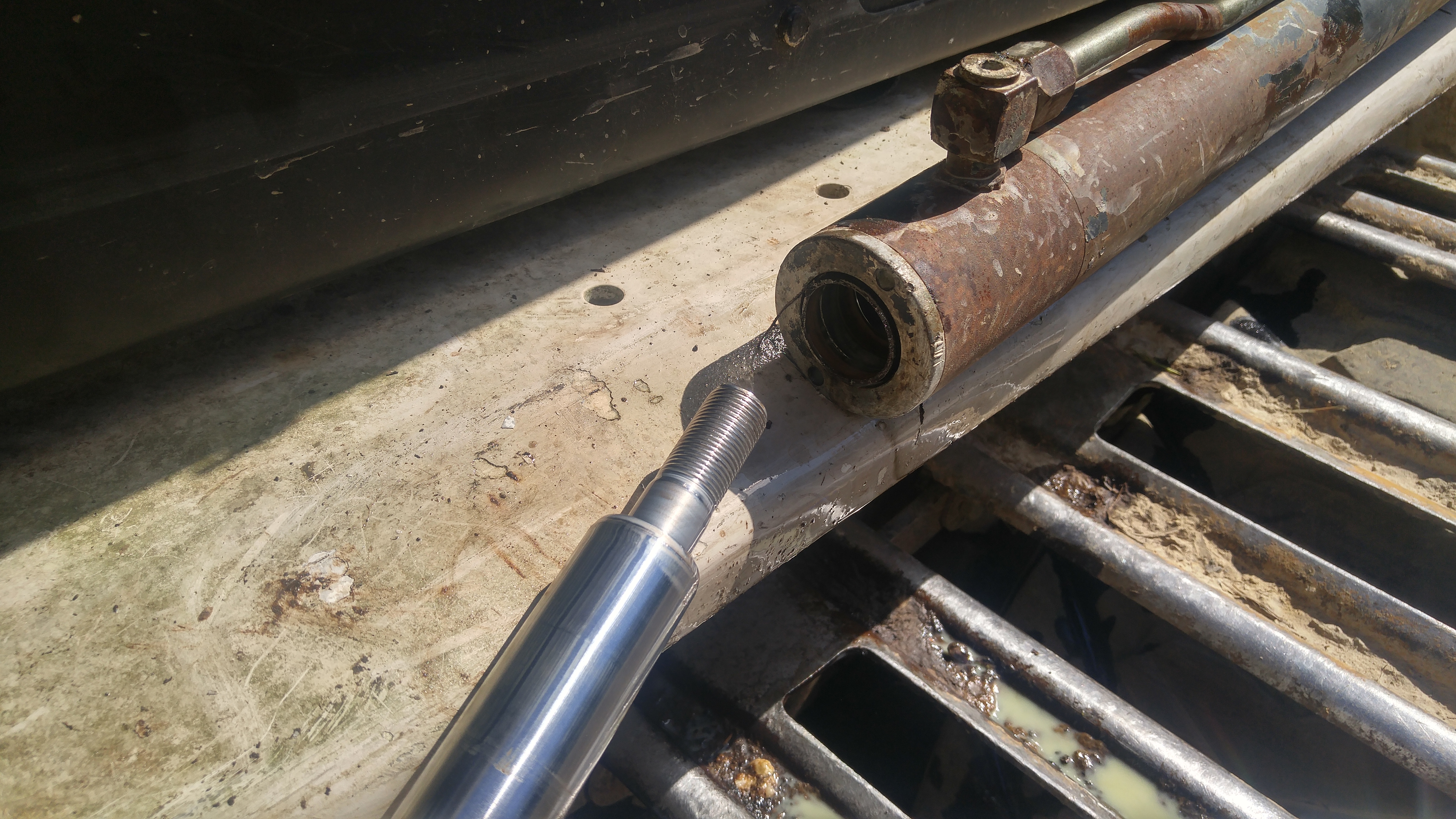

So at the advice of a friend who is out of state. I pulled the front pin out of the lift cylinder attachment. This disconnected the cylinder and would allow me to extend the arm fully and do a check to see if fluid was bypassing the piston and/or seals in the left lift cylinder. That was the intent. I started the bobcat and hammered down on the lift peddle and the whole rod shot out of the cylinder and fluid began to pour out of the hole. Oly' goodness! Apparently the rod backed out the nut? However, I can't find the nut inside the cylinder assembly. Again, I haven't pulled the cylinder assembly completely yet. Will do that tonight. Good news is the rod threads look fine on the end of the rod.

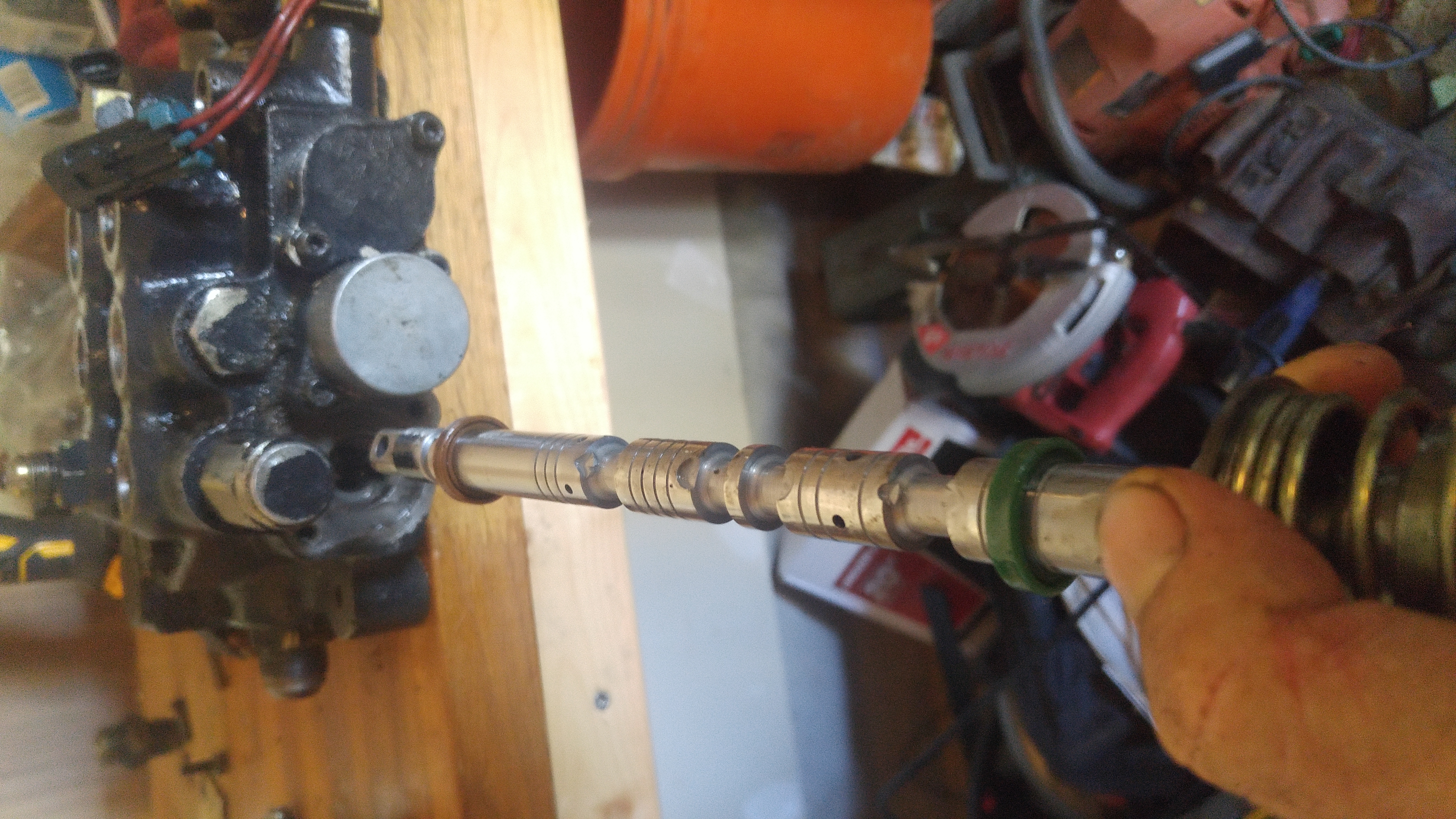

I am editing the above posts and attaching pictures of the control valve and lift spool assembly...

I've been able to move the ram/piston about 1 foot towards the top using a coat hanger. Made several futile attempts to rethread the rod to the nut at the bottom of the cylinder. Ideas?

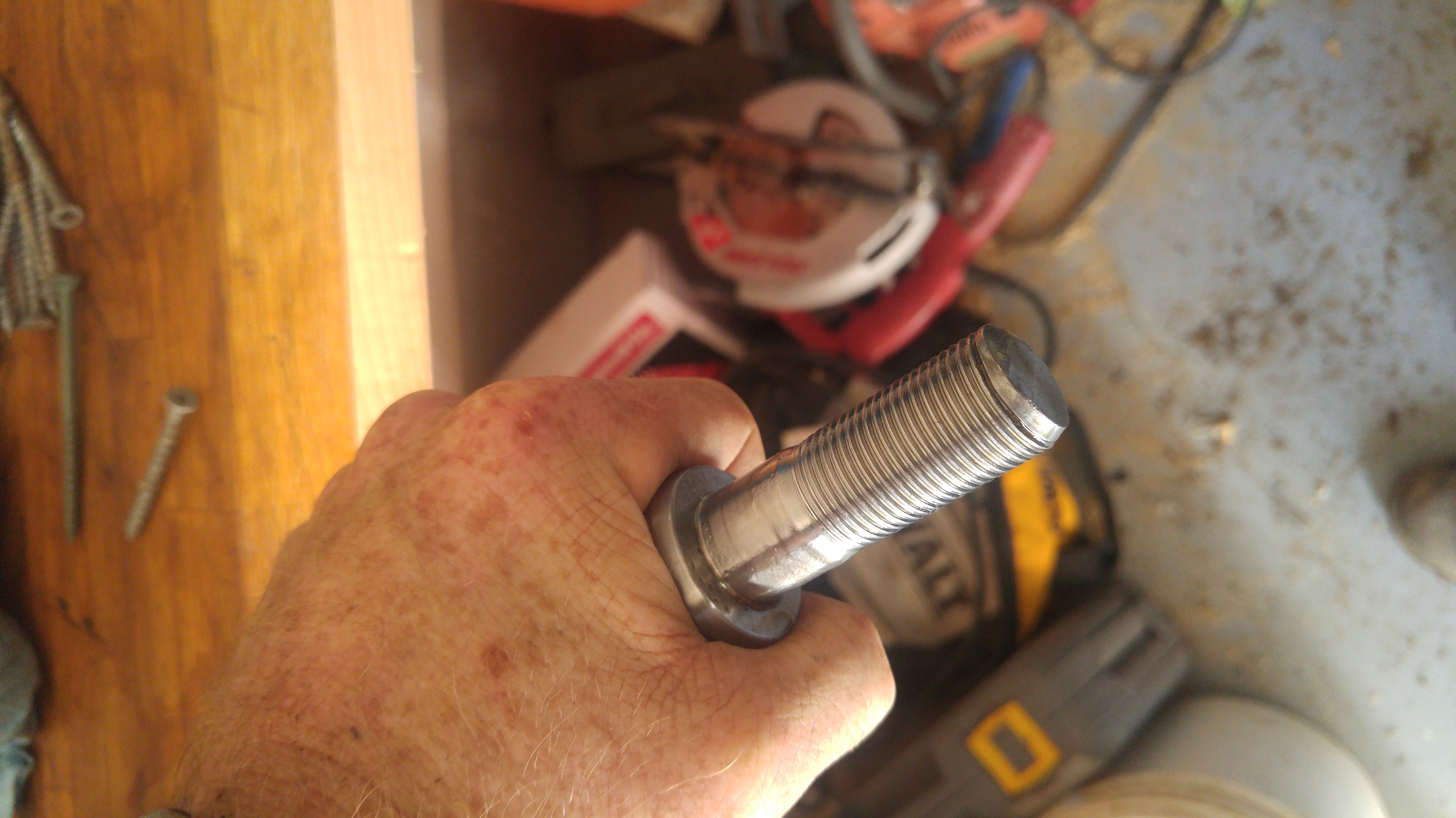

So here is my theory, tell me where I have gone wrong. I pulled the right lift cylinder apart and aside from some scoring on the end cap everything internally looks normalm. My theory here is that since the gland nut came off fluid began bypassing the left gland thru the rod hole. This would mean that the lift system could not build pressure on either side. This is what's causing the bucket arms to fall when up is commanded. When I go to neutral on the lift pedal the bucket stops after a few inches of travel as pressure builds when the spool closes. However, this still doesn't explain the air in the fluid. Thoughts?
The left lift rod end thread is slightly worn as it looks like the rod was meeting metal as it bottom out, most likely on the gland nut. I used the right gland nut to see if I could tighten it on the left rod thread, but the end threads are damaged. So you think I can take it to a machinist and save the rod?

Glad you found the lift problem. That rod should be salvageable, clean up end of the threads. I don't see any evidence of Loctite on the rod threads. Red (hi-temp) Loctite is called for in service manual on these threads.
