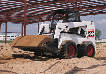

Bobcat 963
More info HERE
Even more HERE
