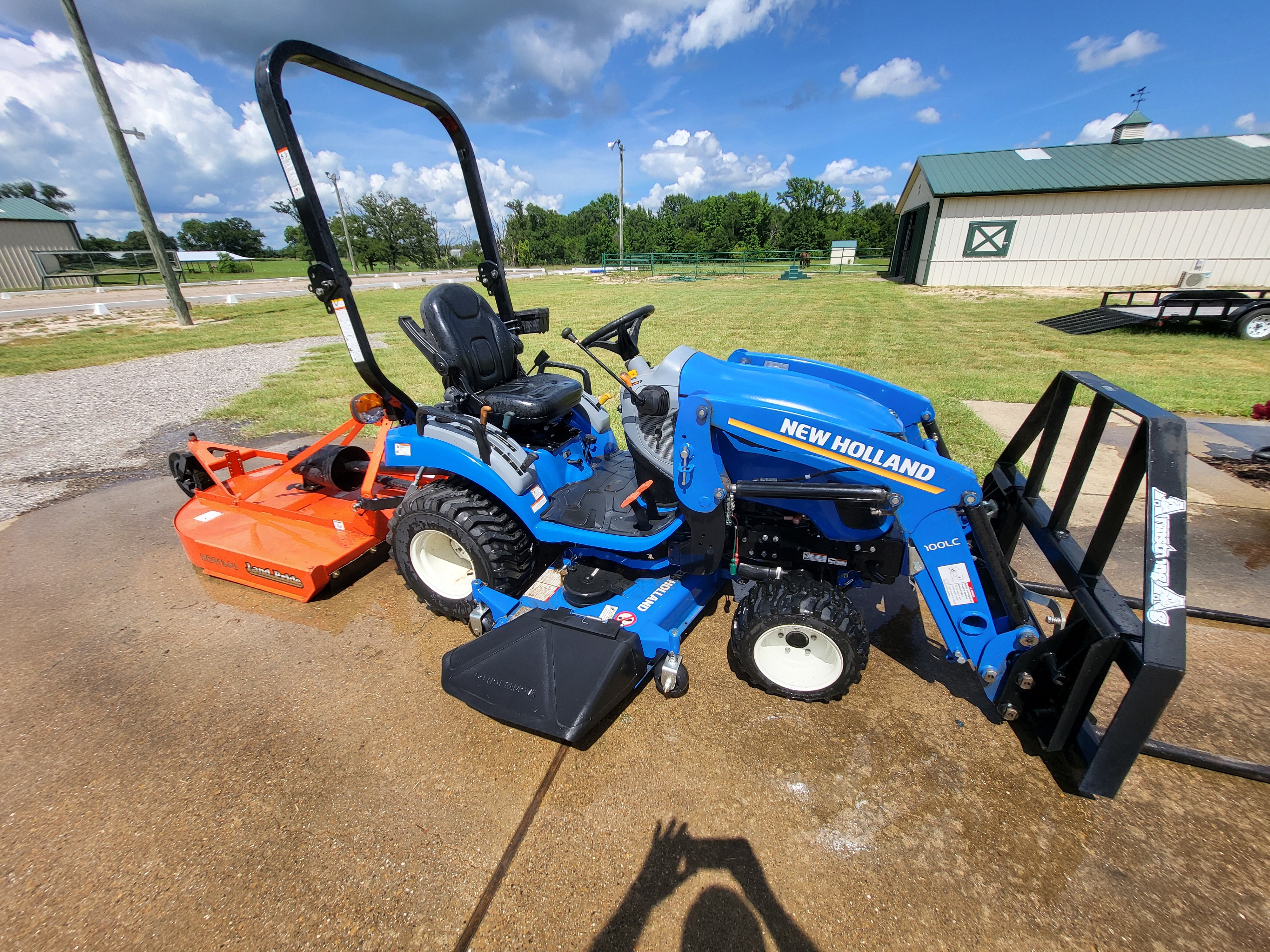

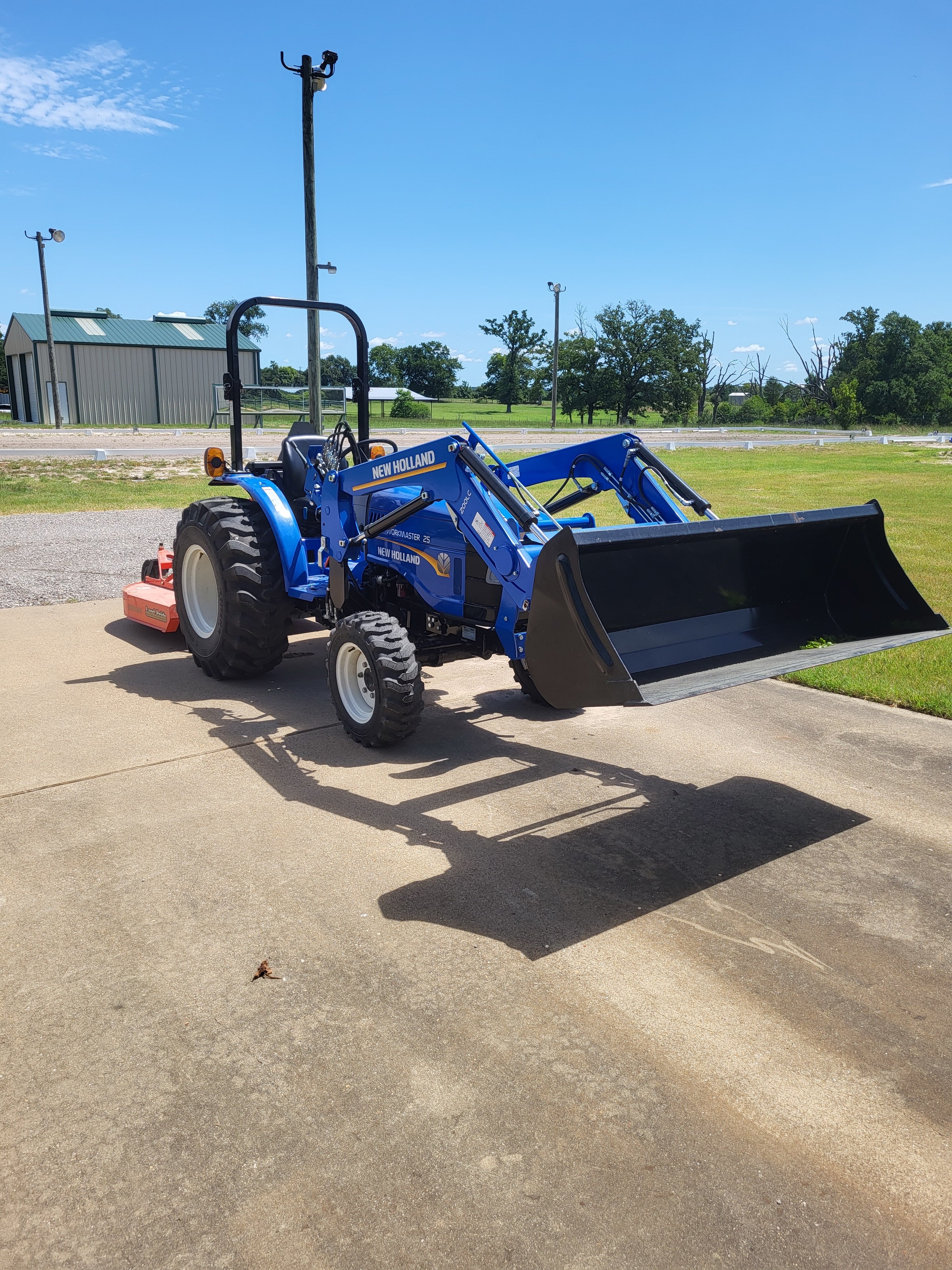

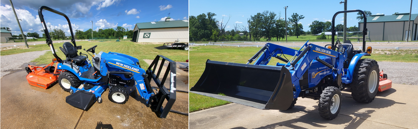

Frame size and weight makes a difference. Trying to stay away from emissions I bought a NH Workmaster 25S 25hp subcompact last year. It had a midmount mower and FEL. This year I added a Land Pride 4' cutter. It felt like the tail was wagging the dog, not enough weight on the front end. Traded it in on the NH Workmaster 25, which is still 25hp but is a compact tractor. Now it feels stable, I have more lifting capacity, and larger tires. Something in that range would probably do most tasks for property maintenance for your 4 acres. If you needed something bigger for a project you could rent bigger equipment or hire it out.
Here are pics of both for comparison. I now think of a subcompact as a garden tractor with a loader and 3 pt hitch.
