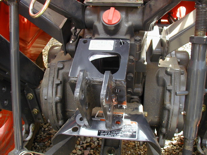

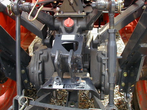

You have to design the mounting stout enough to hold the tractor rigid. If you don't - bad things can happen. (See the attached pictures) Those castings are 3/4" thick on the differential and 1/2" for the transmission. Both were replaced as that was more economical than repair. The factory sub-frame is 3/8" x 2" x 6" C channel. But the hoe is a 14' dig and about 3000# weight. The tractor is an industrial Ford (basically an 841).
Don't mean to scare you off of this project, if you can get 1/2x2x4 tube, it should be fine.

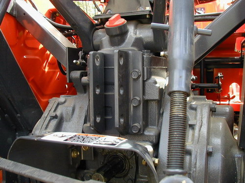

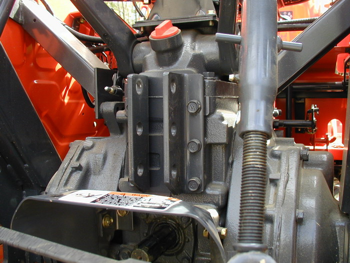

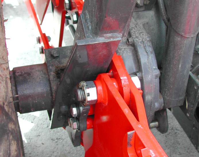

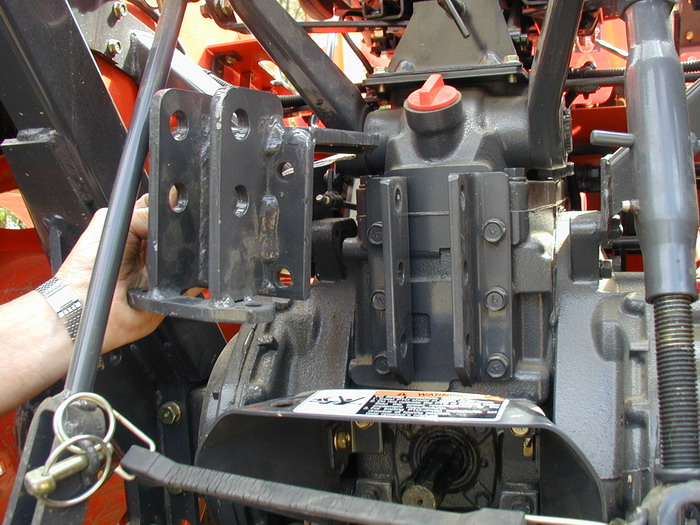

Here are pics of my "Kubota certified re-enforced bracket part" to beef up the top link bracket on the rear end housing recommended for heavy box blade and backhoe attachment. Also they have a heavy duty top link pin that goes in to this bracket. Previously ??? yr or so, a post was made with pics showing a rear end housing that had broken because this bracket was not installed along with a 3 pt hoe attachment and no subframe
More inquirement found that this part is needed for heavy/stress making rear attacments. along with the subframe.
Pics are on my L3400.
Of course it is a piece of $3.00 steel from the scrap yard that you could make, but to keep my warrantee, I paid $xx.xx for this "Kubota" part.
I welded the original two piece bracket to this, the design seemed to me that the bolts coming through the new bracket, only made a "washer" part with the original brackets bolted to it. (Bolts could still be pulled through along with housing piece)
Hope that future backhoe attachers research more for all the parts that are needed, and the salesman can also advise.
