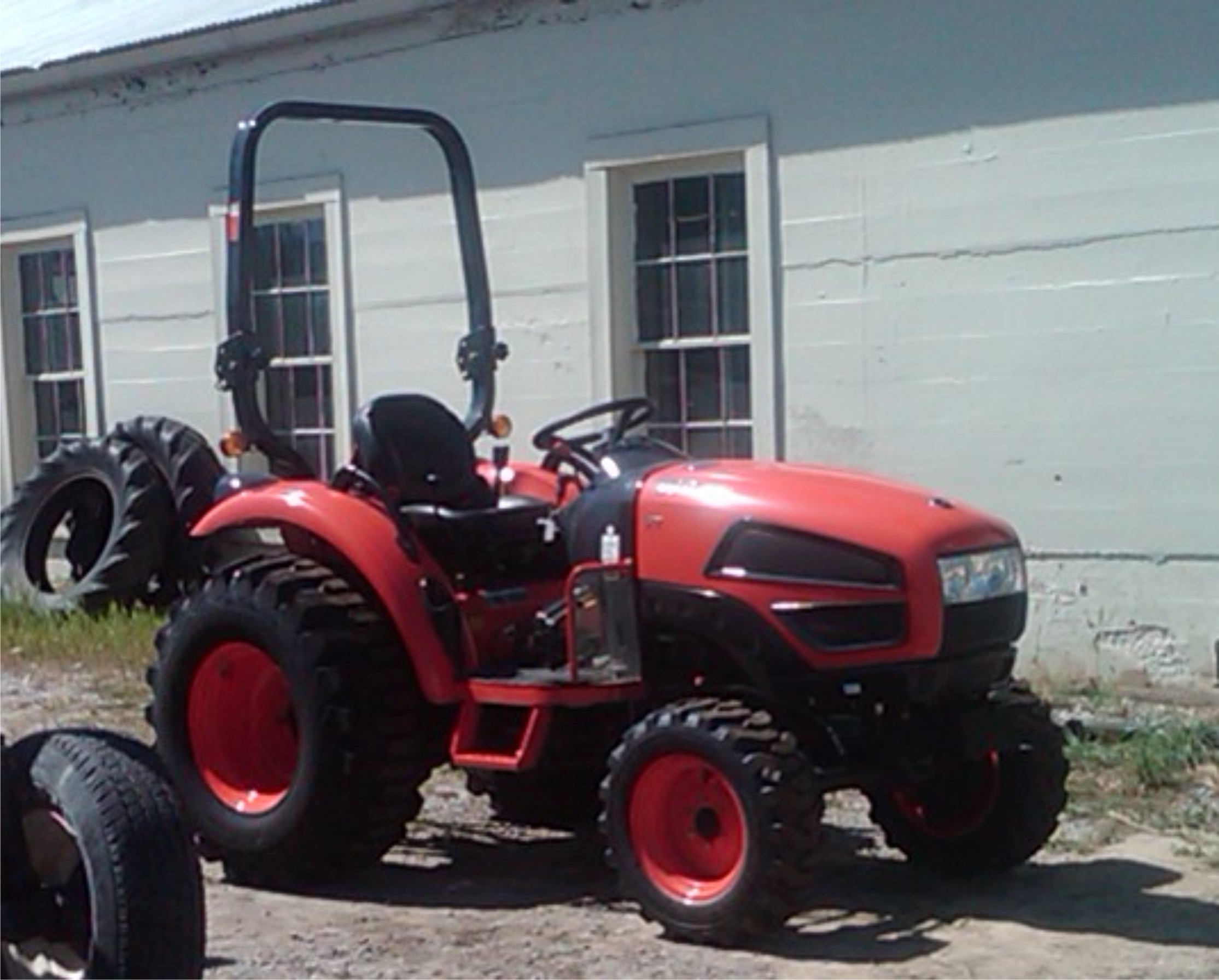

So here it is! They just started mounting the loader and ordered the goodies!:thumbsup:

   / Bobcat CT122 vs CT225/30 and Kioti CK27/30 #26
Give 'em **** Wallace

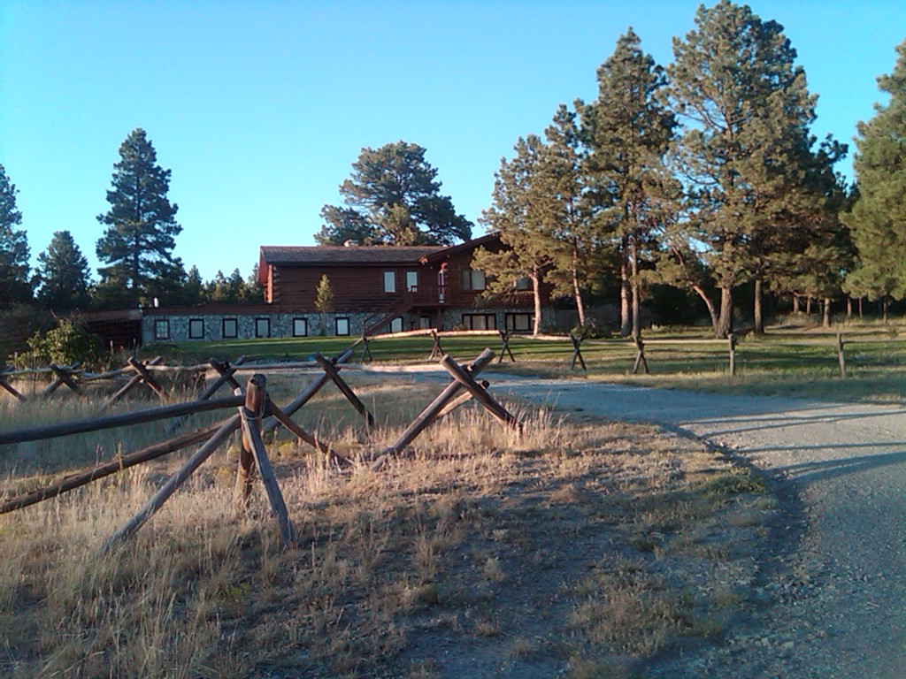

And here is the front yard a couple of little rolls in the hill to get up to the house with a steep gully to the left(west) and steeper behind the house. It isnt the most aggressive topography but probably because the ground is mostly clay and shale. We have a lot of projects to button up before snow flie! New windows in the bottom half and a new section of road to build. plus plowing to prep for and dead trees to gather!

   / Bobcat CT122 vs CT225/30 and Kioti CK27/30 #28
Looks good.
Congrats and Welcome to the Pack!
