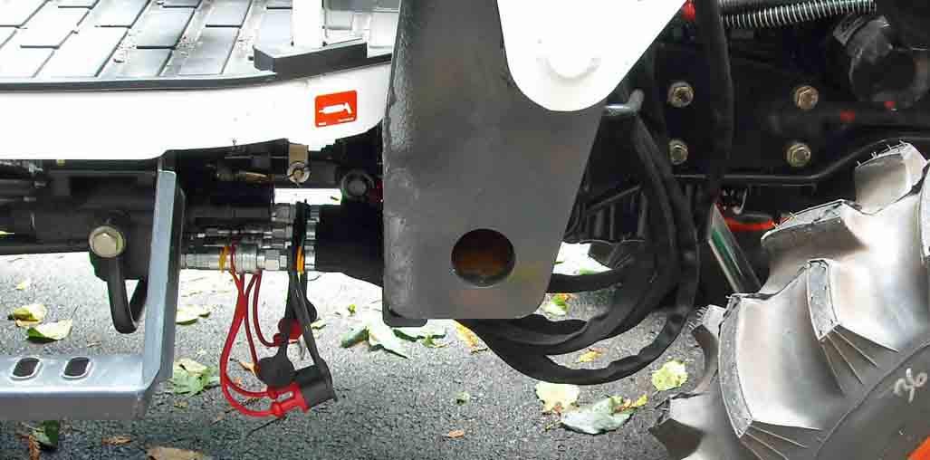

> Finally, the 7TL's FEL hoses hang way down below the tractor. The risk
of ripping out hyd parts below is even worse than the CK30's. And the
CK's risk is BAD. I think the Bobcat must be protected from this kind of
damage. I will fab up a skid plate I think. (The DK/CT3xx tractors are way
better in this regard.)

On my CT225 (27HP), the loader hoses are much shorter and do not hang down as low. In fact, sometimes getting them connected can be a huge pain!

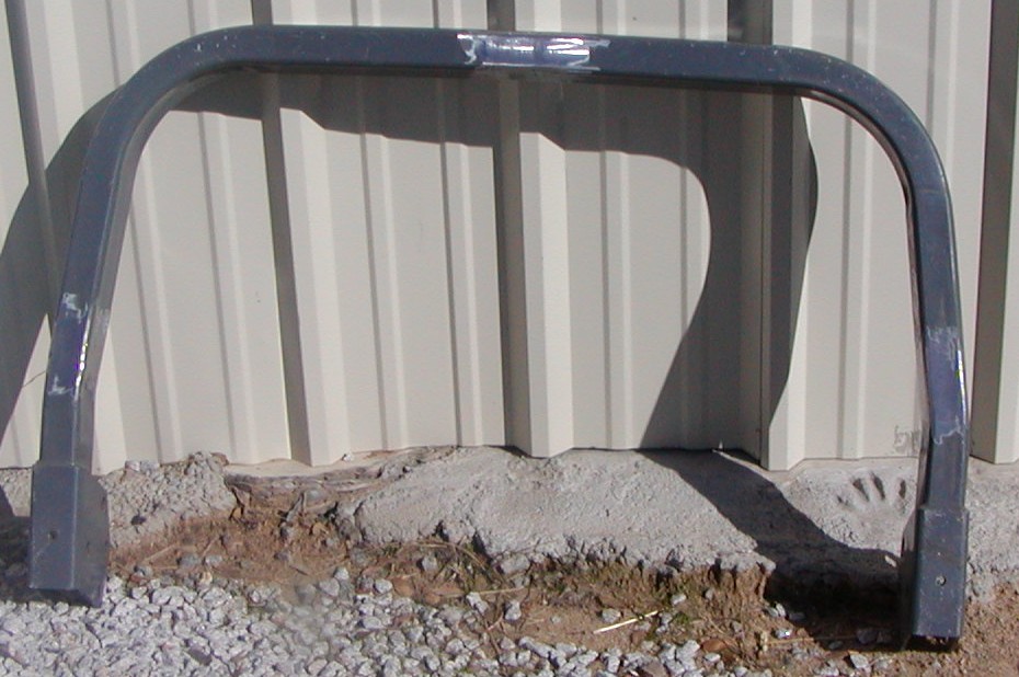

No, I shortened mine by about 10 inches. The photo shows that the
ROPS on the CT is more than a foot higher than the CK's due to the AG
tires on the CT, which are a bit taller. My origninal ROPS on my CK30
was identical to the one on the Bobcat except that the CT has some
ears welded on for additional flasher work lights. This makes no sense to
me since both tractors already have rear flasher lights built in and the
CT addons are very vulnerable to damage. For some reason, Bobcat has
eliminated the front flashers that are down near the footwells of the
Kioti.
When I modified my ROPS, I opted for square corners so I would have a
good place to mount my work lights INSIDE the ROPS in the corners. My
modified ROPS is still more than a foot higher than my head. My work
light brackets and lights are sitting on my bench waiting for installation.
The relays are in and half of the wiring is done.
On the other CK30 I bought back in 05, the ROPS was also shortened, but
it was done to look stock. This required 3 cuts and sleeved welds on
the existing ROPS, 2 at the sides and one at the top (photo).
