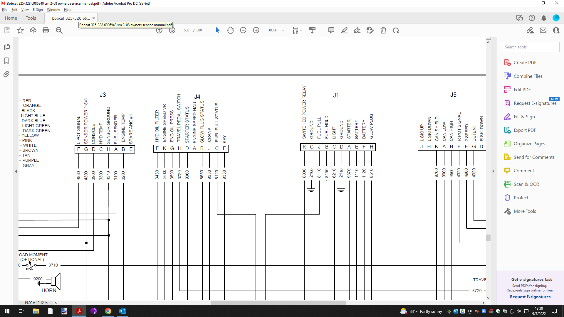

/ Bobcat electrical problem #6
SO....if this is of any use.
The wiring diagram for the 328 (cost me 20 to get the manual on line) has the ignition power to the controller pane on J4, E , wire # 9330 (labled "KEY" on the wiring diagram).
I confirmed it is running power to the controller when switch is on.
Now looking at the ground wires: J1G and J1D, #2100 and #2110 respectively.
Ugh.
