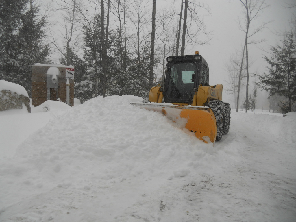

Specifications - Small Platform Skid Steer | Small Platform Skid Steer Loader | JCB 135
Here is the 135 at work.
