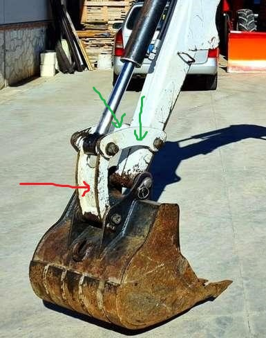

Here is a pic I found online. It dont have the xchange coupler....but looks the same otherwise.
Red arrow is the H-shape cast piece that I have twisted twice.
The green arrows are the side straps. The pins are welded to one....snap rings on the other. Something is putting a bind on them causing it to want to pop one snap ring off.....then it twists.

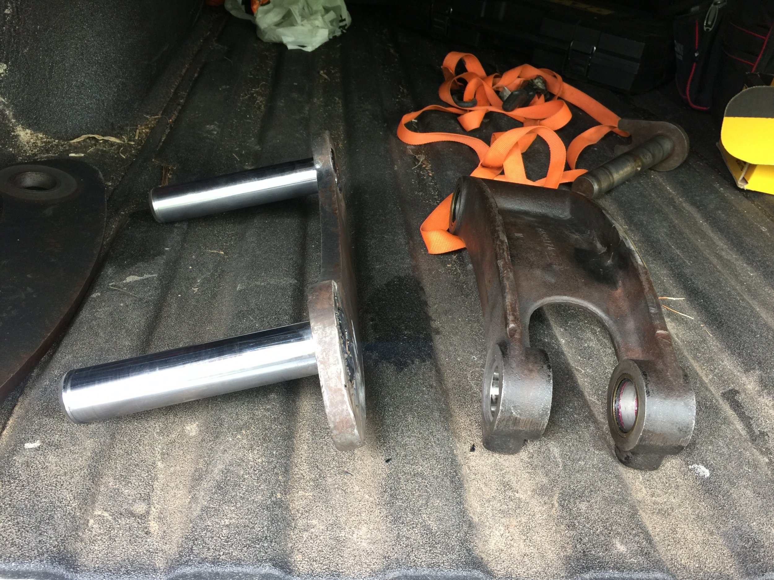

I bought an abused X about 5 years ago. The pins on your Green arrow piece were worn, so I had a local welding shop (recommended by the local Bobcat dealer) cut them off and welded new ones on. They even drilled it for the grease zerks. This went back together okay until I replaced all the bushings with new ones. The H also had a crack starting in it and welding that warped it slightly. The tolerances after replacing the bushings were so tight that I couldn't get it to all go back together. I ended up just dropping the entire machine off at the local welding shop to bend and tweak parts they worked on until they fit. From the pics I have from 5 years ago, it looks like they heated the center of H and twisted it back into shape. They made everything fit and move nicely. It's been over 5 years now, and the welded and heating to twist the H is holding up just fine.
IIRC, all the welding, new pins, and straightening was only a couple hundred dollars. Far less than buying new parts.
New bushings and welding, there wasn't enough slop for the pin now
New pins and welded H

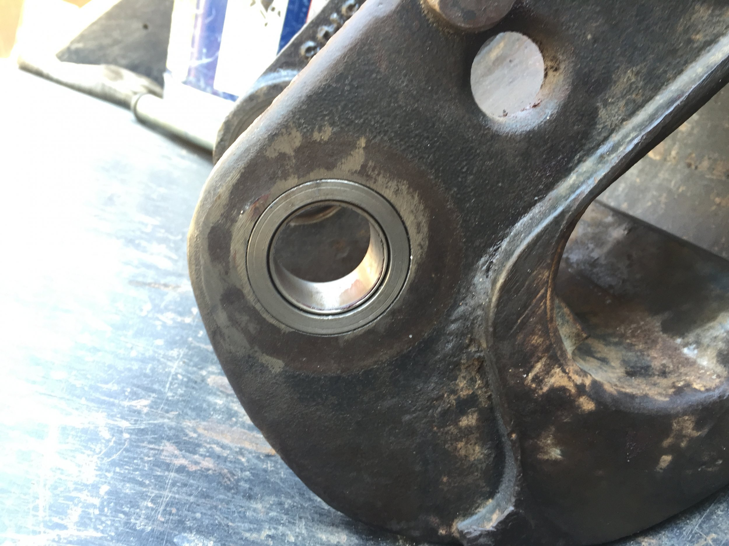

I just finish up yesterday on mine. Re-made several bushings and pins. Didnt have to touch that H shaped piece. So still unsure weather its Cast iron or something else.
Most of my slop were at the single long pin....that goes through the end of the dipperstick through two bushings in there, goes through the coupler, and also the thumb.

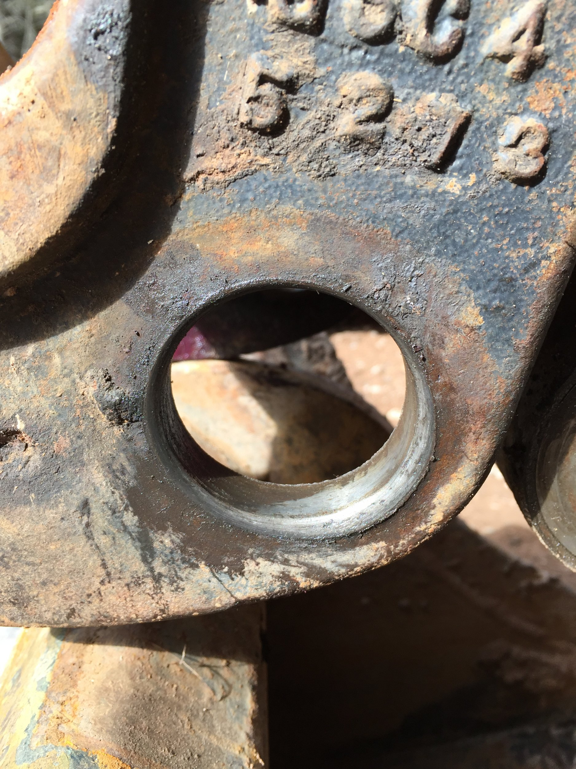

The bushings in the x-change coupler were shot and the holes egg shaped. I think the coupler is cast iron??? IT has been worked on before....the egg shape bores for the main pin that attaches it to the dipper....have been welded a bit. Not sure if they were welded in an attempt to make true....or the bushing were welded in to take out the slop. I tried to use an expandable reamer to make the holes round again then I was gonna turn some oversized bushings.....but....where it was welded was hard as diamonds. Which is typical of welding cast iron with a mild steel rod. A file wouldnt touch it. And a carbide burr didnt like it either. So I repeated what I think was done in the past, and made new bushings....then welded them in...and reamed to size. Welding them I hope so they dont loosen up and accelerate wear since I couldnt get the holes perfectly round again.

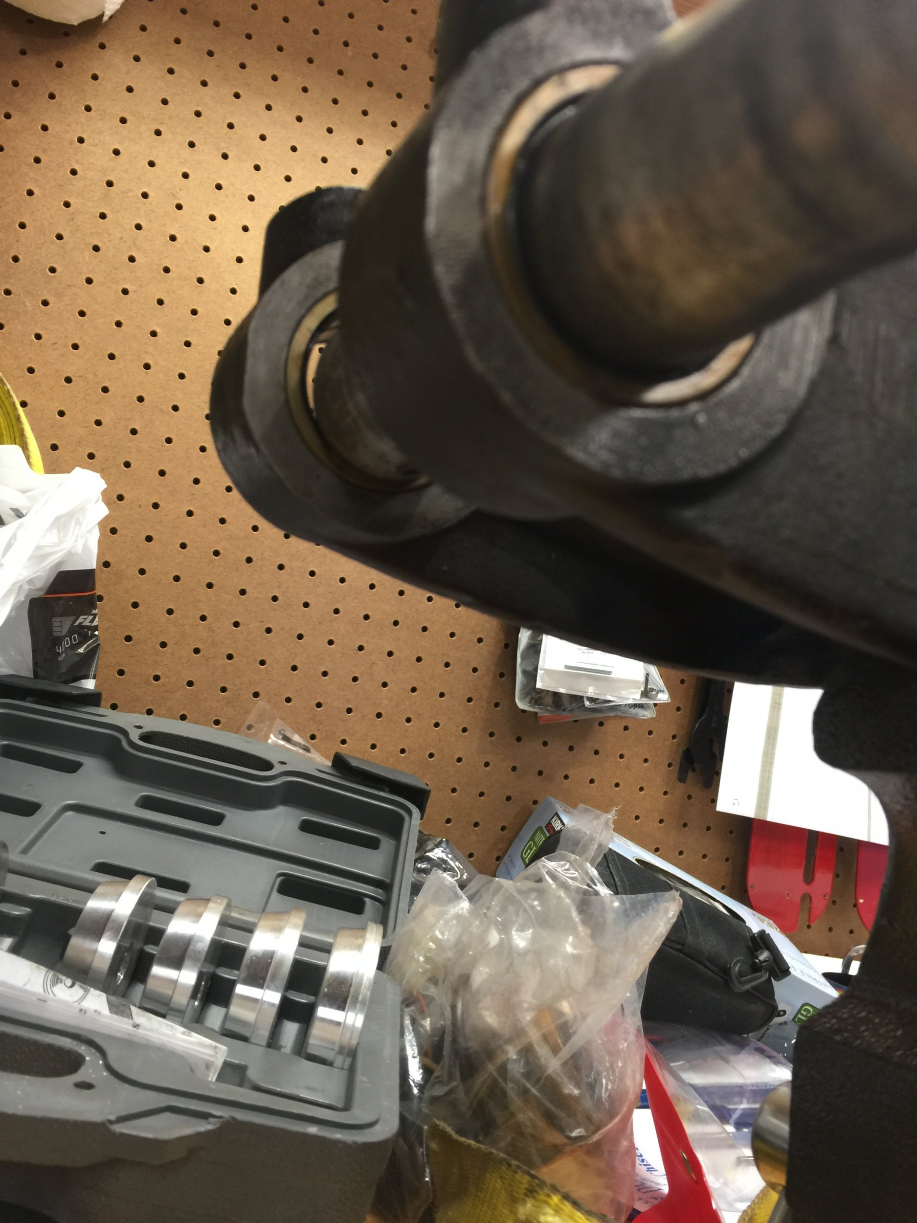

Also made new bushnings and a new pin for where the H-shaped piece attaches to the coupler. Its the pin with the tab and notch welded on (you can see in your pic).

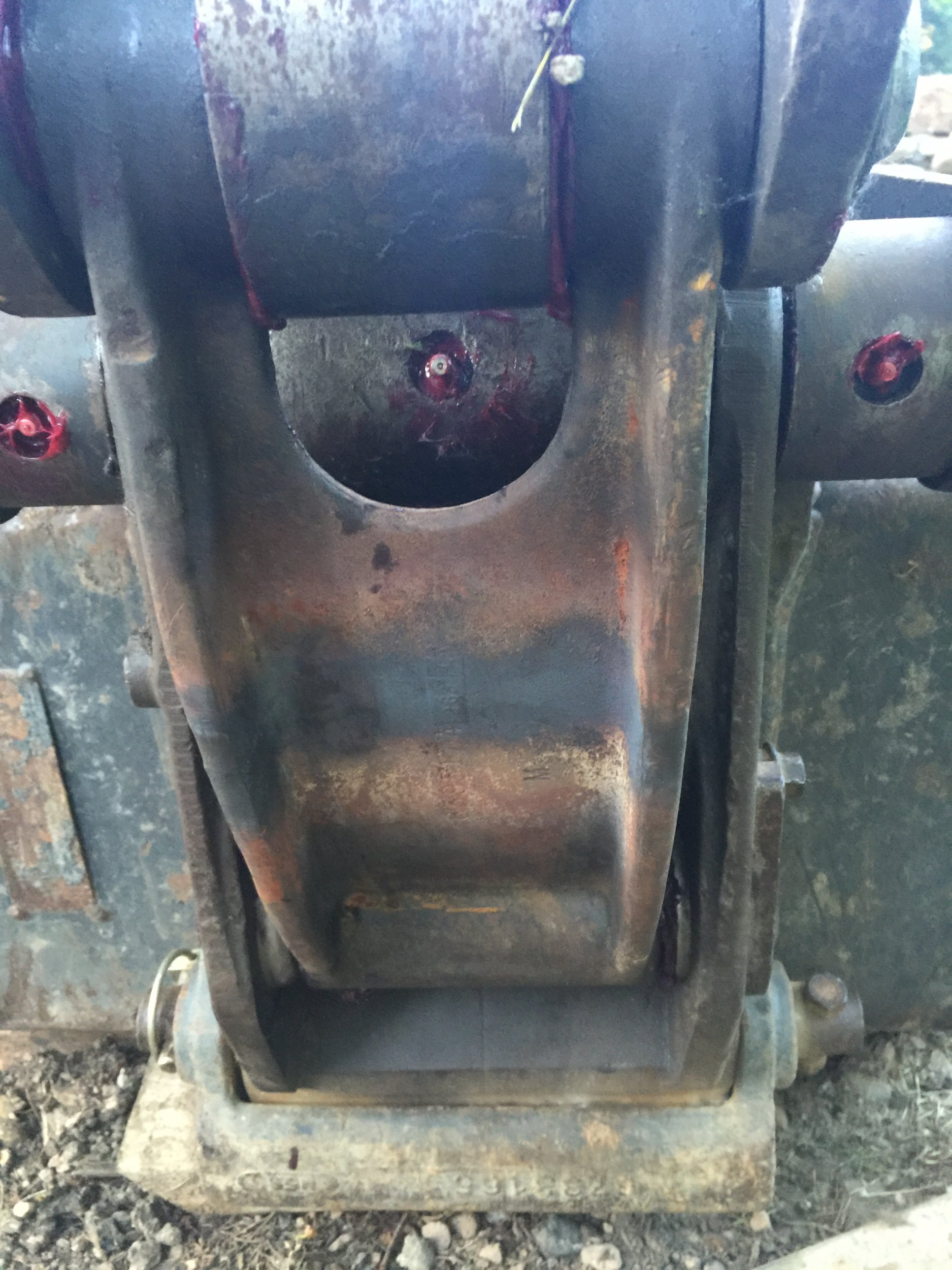

The bucket (or I should say bucket coupler) is nice and night now with no free play. Yet still moves smoothly and easily with no binding.
The only bit of play now is just the coupler to the bucket. And thats just the nature of a quick attach system. IF they are too tight you fight swapping buckets.

Yep, those are the holes on the coupler that someone previously welded to.
Way to hard to machine with HSS and even too hard for carbide.
In mine, the insert/bushing that goes in there is like a flange bushing. With a 3/8" thick flange on the inside. Because the coupler is 3/4" wider than that H-shaped piece that the pin goes through.
So I made some that fit my oval holes tight.....welded them inserts to the coupler, and reamed the ID to the pin size (1-3/8").
I have a bridgeport and a 4500# lathe. So I do my own machine work.....otherwise this would cost a fortune. As it is....it only cost me time.
