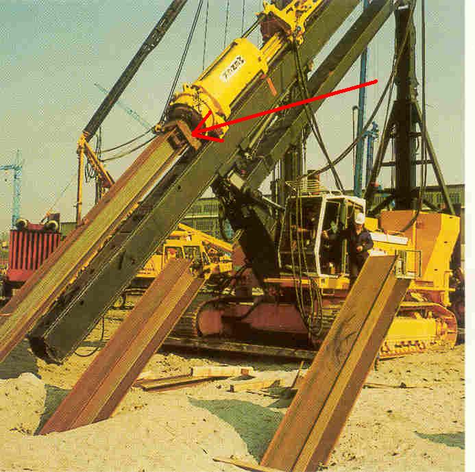

Generally cast iron will let you know with in a few minutes it's not going to play nice with you. About the time you make the second weld, the first weld will crack, and you can hear it when it does:mad:. Once it's cool, that will be the real truth.
I repaired a lot of these out on a barge, where the best was preheat, and some house insulation for cool down over night. Tell me these things don't take a beaten!:eek:
(Red arrow).
