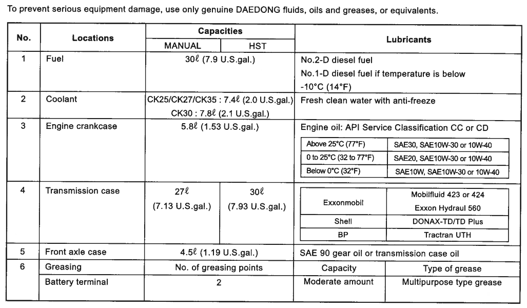

according to daedong, the real manuf of this tractor, here is what they call out, this comes out of the Kioti service manual
how many of you actually do this service work yourself, is it pretty easy to do?
I didn't have a problem with it and thought it was simple.
