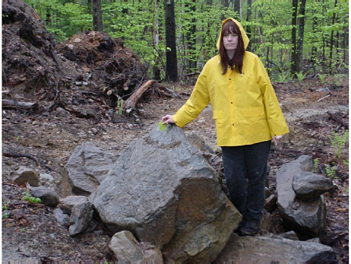

LaVita said:
Mike69940, please provide additional information. Is the picture supposed to show some bent tines or something? I don't see anything wrong with the grapple in the picture. I have seen one up close and know 2 people that have this grapple and are very happy with it. I am about to put in an order for one myself, so your comments concern me.
No, The Grapple has been straightened and the top 3/8 x 1" strip across the top jaw tines have been welded top and ends with a 3/8" fillet using Low hydrogen rod. The top strip across the tines should be 1/2 x 1.25 and be welded heavier. I have a 10' homemade special Pry-bar to fit over the ends of the tines and straighten the tines when I bend them. The tines are workhardening and bending less often.
The 2 x 2 HSS tube should be HSLA steel or have an additional 3/8 X 1.5 strip welded across the top.
The tines bend gripping irregular shaped rock. The rocks get caught between the tines.
I use my grapple hard. I use my L39 hard. The rock you see in the picture with my 6' tall but less than happy wife poising in the rain has to weigh 3000-3500 lbs and was carried with the grapple. The Borgford had a heck of a time grapping that sucker.
The Borgford is the right size grapple for the L-39.
I will eventually have the tips welded up with hard facing Nickel Tungsten Carbide Hard face steel rod.

I've got a couple of questions:
1st, What 2x2 tube. Mine on the top jaw is 3x3 bottom is 4x6
2nd, That tractor is much smaller than mine and I don't believe it possible to hurt the grapple nor can I lift anything close to 3000lbs. taking into account the tar weight of the grapple itself. In fact I would have to guess at 2000lbs. lift being the absolute upper limit under ideal conditions.
1st, What 2x2 tube? Mine on the top jaw is 3x3 bottom is 4x6
1. Mine is a 2.5" x 2.5" Tube up top 4" x 6" on bottom and is 66 wide. So if yours is 72" wide, Borgford may jump to 3" x3" HSS tube or has already beefed this part up as a design improvement on all sizes.
2 That rock is at least 44" x 38" on AVERAGE and 22"-24" thick Granite at 140 LB/ft^3.
I had my Hydraulics really turned up till I blew an O-ring and hose. I added a bladder accumulator now to handle the shock loads and keep my pressure set just under 3000PSI.
God only knows how hard I was pushing the pump when I picked that sucker up. I would not be able to pick it up now, but I could hoist one close to that size.
To fit that rock in the grapple I had to push it against a pile of other rocks and scope it up. The grapple would not alone lift it. With additional weight on the tractor and BH extended the machine's rears were bouncing off the ground.
The L-39 Loader breakout is 3560 Lbs. and I only lifted it a few inches. I agree about 2000 Lbs at max lift is all she will do.
Maybe having boosted hydraulic caused the top tube to bow a bit?
