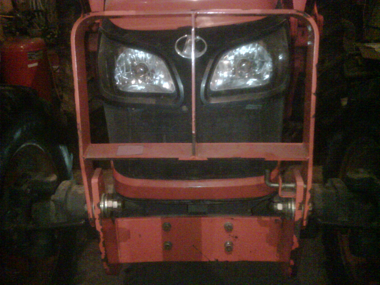

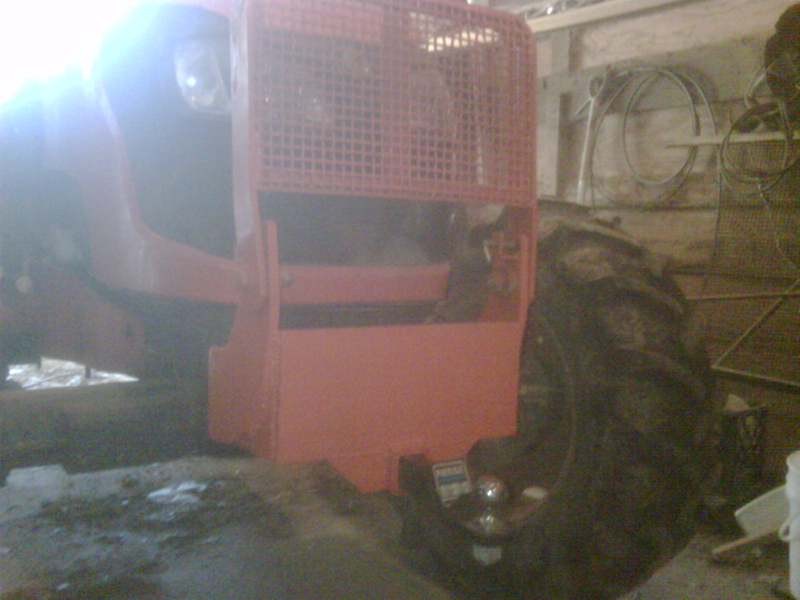

Here's mine I did last year. I still need to fill in the middle. The chain box real nice and the receiver has come in handy a time or two. I bought the tractor used and the brush guard was a little bent. I welded 3/4"x6" on the sides, back, and bottom to the orginaly brush guard. Then the front is 3/4"x8"
I drilled my holes and bought longer grade 8 bolts.
